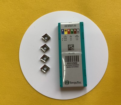

A 1 thou cut is too small with a carbide insert tool - they’re basically blunt and will just push the work away. Try a razor sharp hss tool instead.
Well yes, it is possible to get sharp inserts, but they aren’t the norm, especially if you buy from Banggood or any of the usual hobby suppliers. And most people can’t decipher the code to see exactly what their insert is like!I disagree thoroughly, and here's why:

You can get razor sharp positive carbideI have some Taegutec CCGT inserts for aluminium/light cuts in steel - that will draw blood, literally. They'll shave peach fuzz swarf off mild steel.

You can get razor sharp positive rake carbideI have some Taegutec CCGT inserts for aluminium/light cuts in steel - that will draw blood, literally. They'll shave peach fuzz swarf off mild steel.
I agree though - a negative rake roughing insert is totally the wrong choice... depends what @fizzy is using... Doesn't look too bad going off the finish...

I know you can get super sharp negative rake inserts, but i don't have any experience or knowledge of them. I'm learning on the flyThats good to know - I spend days on it
I used a sharp tip but negative rake as you say. I do have some razor sharp positive rake tips for aluminium - shaped like a diamond almost. Will try one of those next in case it is deflection.
