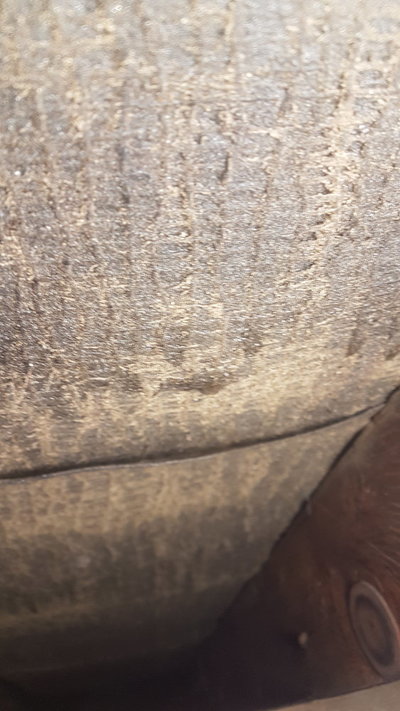

i raised the floor in the loft years ago so have 300mm of insulation in there now. i have never fet the chimney breast in the loft although it dose get nice and warm in my bedroom directly below the loftThe trouble is trying to keep the warm air hitting the cold roof. I'm sure some more modern vapor barriers allow condensation to wick through whilst keeping the rain out but felt is not good at doing that. I would keep an eye on it over the next couple of weeks and see if it improves. Might be worth over insulating the ceilings with another 170-200mm if you have the room, time and money, that may stop some of the heat from the rooms below finding its way up there.
The chimney may be not helping although I would imagine most of the heat will have already been absorbed by the brickwork lower down. How warm is the chimney up there have you felt it to see if it's a potential addition to the problem?

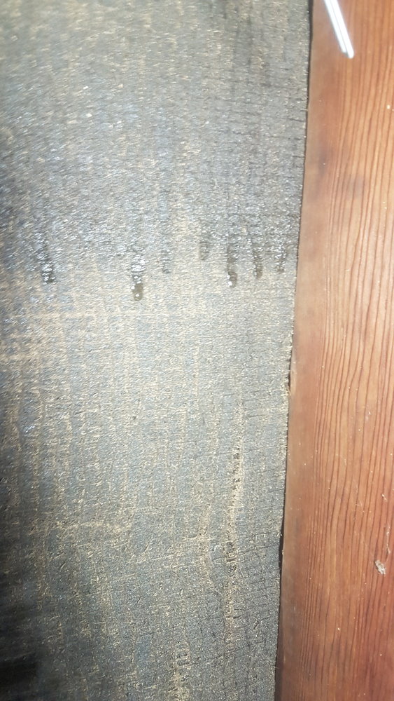

That's the collapsed spring loaded parallelograms of north to south 2 inch wide corrugated plastic ( Think single thickness of house for sale plastic boards ) I said was slipped down the joins of our over lapping roof felt . three row on each roof aspect about every 150mm apartI looked at a video where these spacers fit inbetween the felt where they overlap and opens up a gap venting the space , looked good

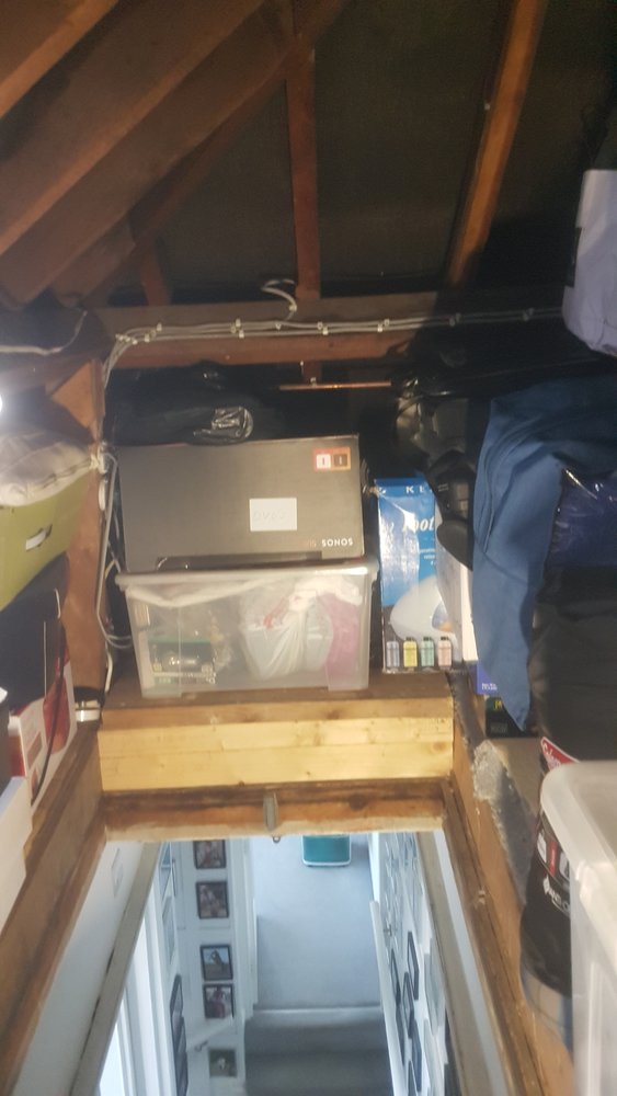

Poor chimney pointing up & flashings plus bad workmanship can also let in tremendous amounts of water, it's not often a roof repair or new work is looked at for reliability once it's been paid for .i do not see any vents up in the loft, none in the roof, eves or soffits
noticed a few wet boxes today

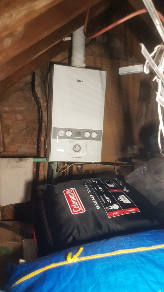

are you saying insuate inbetween the rafters or over the topyou need to insulate and seal the loft area as that boiler and the heat up there is causing you the damp situation

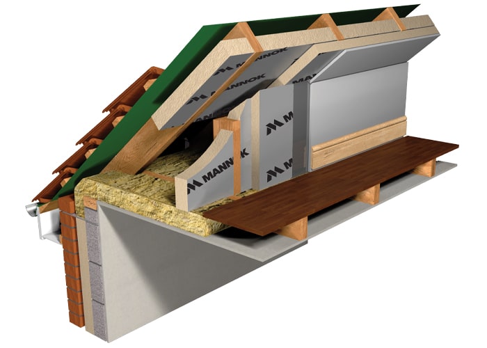

theres no point in fitting air breathers as that boiler will end up flat cold and freezing in this case beter to go the opposite way and insulate the rafter beams and seal them with overlaped insulation boards
pick your punishment on the insulation rockwoll vs eps and both need eps 1" overlaped eps board to seal the rafters away from, the beams
Everything is chilled to the bone, then we get a sudden warm moist front pass through, hot moist air hits cold items = condensation.I would wait until the temperature normalises and check again before doing anything. We don't often get a prolonged cold spell like this.
