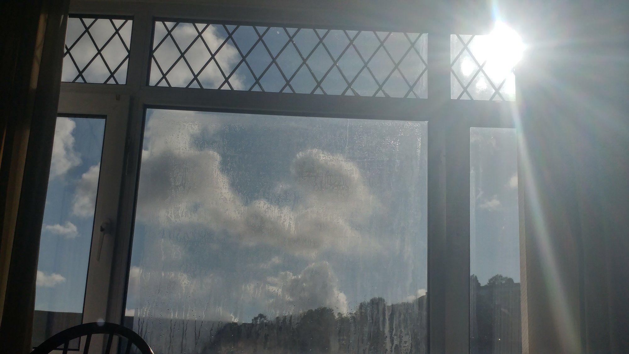

Has anybody got a clue how this can be fixed cheaply.
get a replacement unit and fit it yourself
is that using a Stanley knifeTake the unit out and replace the silca gell in the rails, refit.

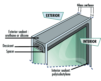

inside the aluminium bead that is sealed round the unit its not going to workWhere is the silica
Most units dont have much, so no need to remove the old stuff, the mastic has broken down somethere, to ensure its going to work you need to reseal the unitis that using a Stanley knife
