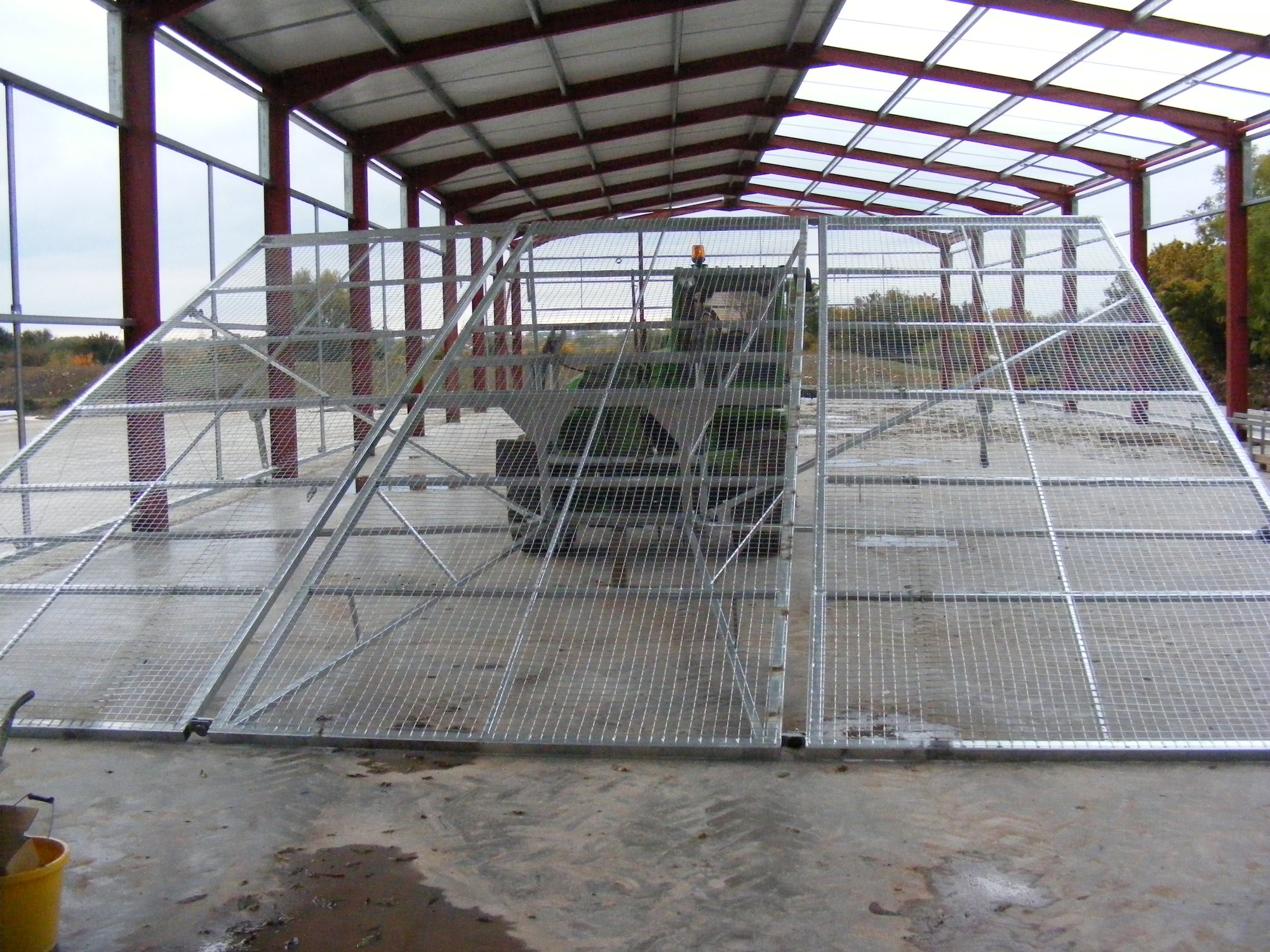

Hi Guys,
I was pondering over this and I said where better to ask than on a welding forum J because everyone here is full if knowledge.
In the next week or so, l plan to Lay an 8mx3m concrete ramp/pad up into my workshop. I say ramp, because it may be hard to see, but the workshop is about 1.5ft or so above ground level (see step into the pedestrian door for a guide.
Disclaimer **** I have absolutely no professional experience in building or concreting, this is seat of the pants stuff. I’ve learned lots from my dad (who is also not a pro) and mates etc, but essentially, we don’t have any real deep knowledge how to pull this off. Bar the slab, we built the whole workshop ourselves, so we can turn our hand to it, but concreting is a bit tricky.
My planned process – please tell me where im wrong/stupid/what are you thinking/ that wont work etc etc.
· We initially were going to put down form boards, but I cant have a 4 inch kerb along the side of the pad because ive to reverse my car transporter up there. (last pic where the green line is)
· So, as it is going to be a stiff mix, we are going to go with no forms, and hand finish the sides – is this crazy?
· I don’t want to tie it to the workshop floor under the roller shutter – so I plan on cutting a joint, and then sealing it
· I don’t plan to put in steel as I went with 35n 4 inch concrete. Concrete place says that’s more than enough?
· I plan to rent a power screed (8ft) to try and get the slope on the ramp
That’s basically it in a nutshell. Any advice or recommendations gratefully received.
