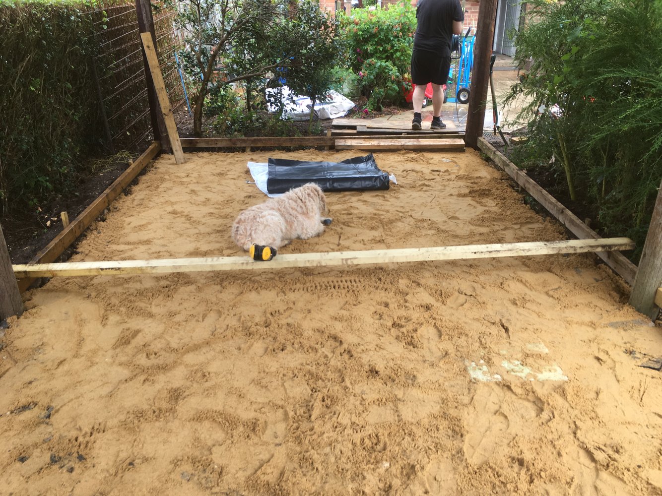

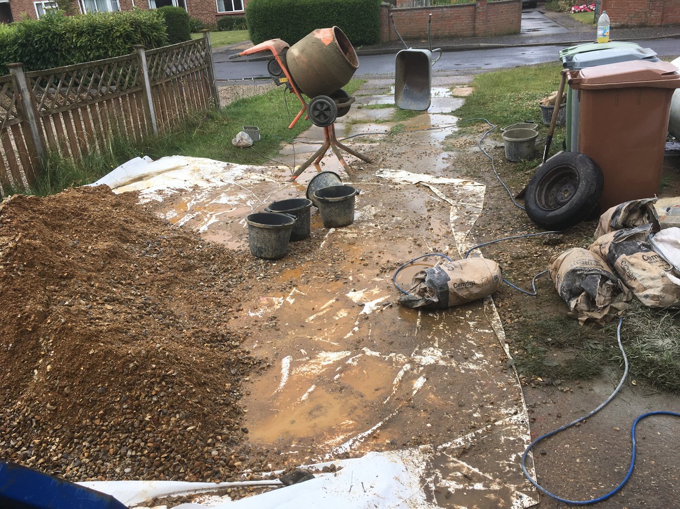

barrow sod the barrow get the miser in the pad area mix and spin it round and empty it in the hole. no abrrow needed, then move the mixer back gradually as you fill the area until the last mixes the mixer is out side but on the edge so you can still empty it in the pad area. Just read the bottom bit of your post, Id be moving all the dry sand down next the the pad area ready to mix
