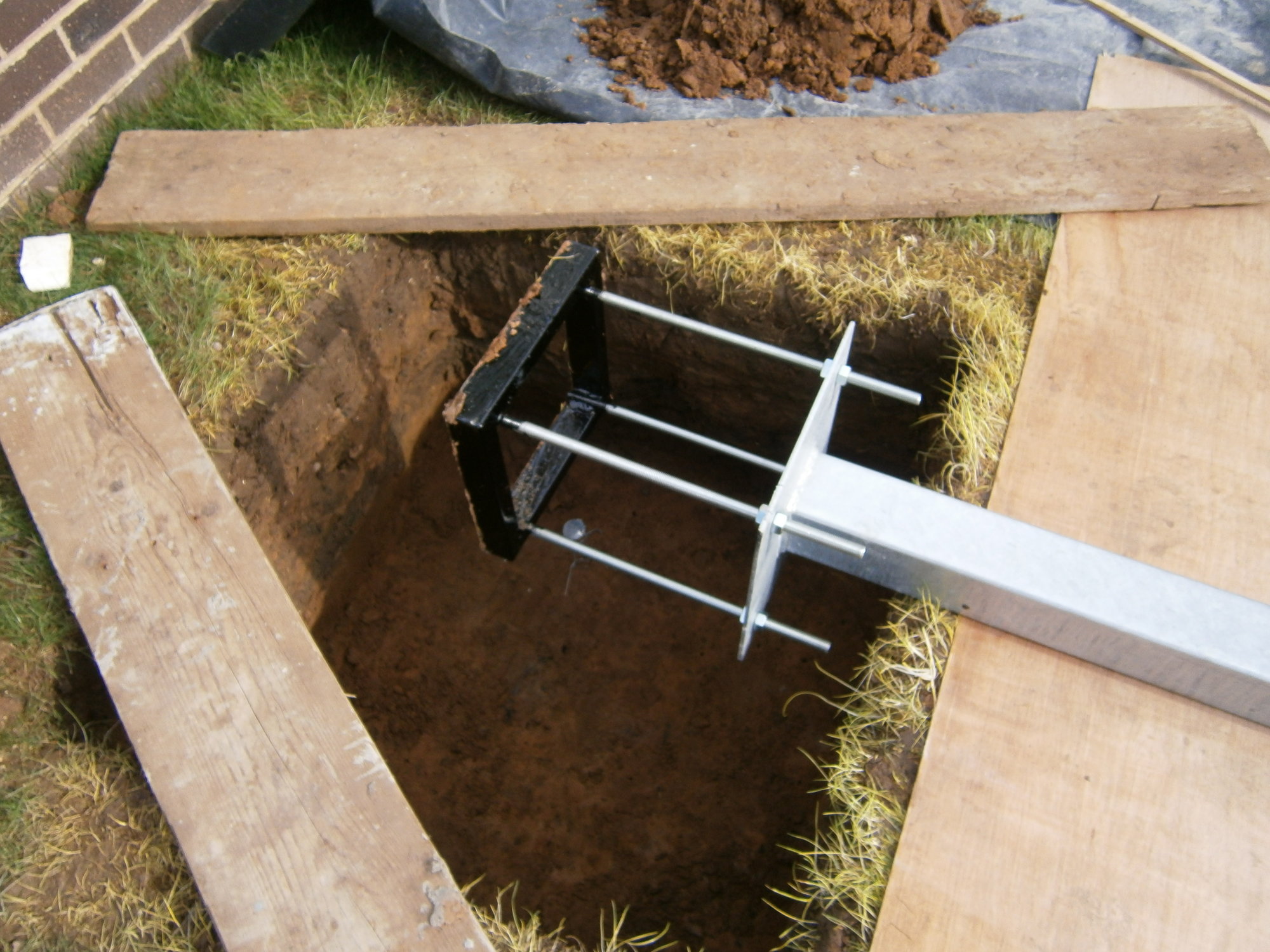

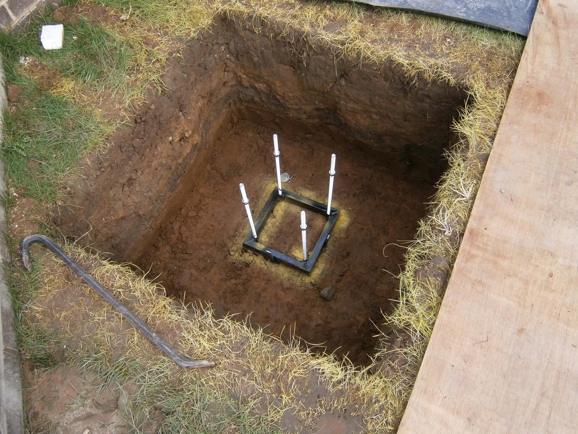

That sounds like a neat system for setting the posts, but doesn't sound like it would also carry the weight of the gates without flexing the rod which is only half secured - or am I wrong?
I need to test the swing of both gates during a dummy run install as they have to catch back onto the railings either side. I normally mock up installs in my workshop to find faults but in this situation I don't have enough space as each railing panel is 3m long.

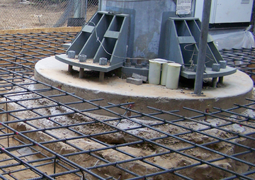

Industrial buildings are set upon threaded bolts which are concrete in but have a cardboard cone around the upper half to allow them to bend for fitting. Once the steel is packed and bolted down they grout in the cones to secure the rods.
You can see it here, in Andrew Mawson's tractor shed build thread:
http://madmodder.net/index.php/topic,11819.msg145597.html#msg145597
