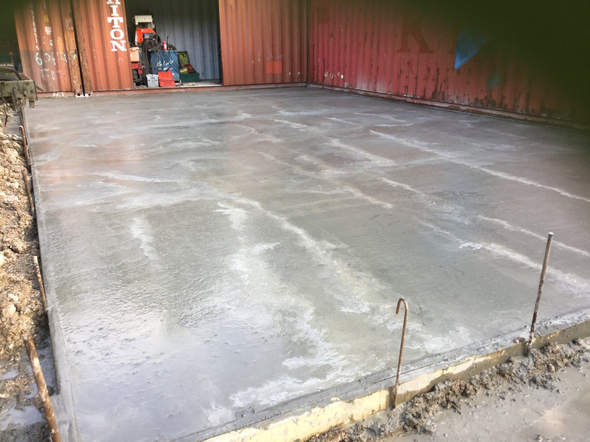

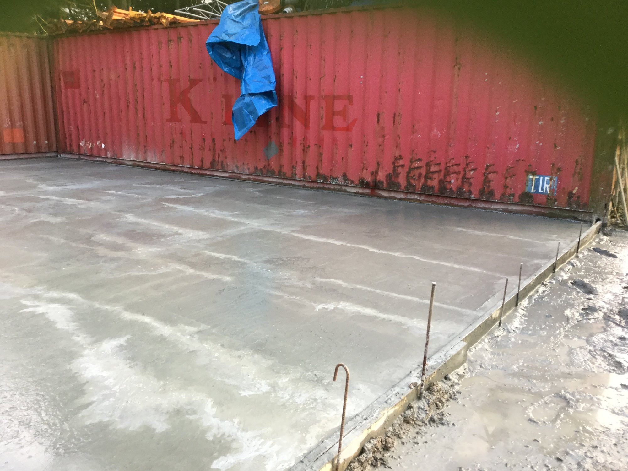

    Richie I have recently put in a base for our truck 6 poster, thats 40`by about 25`ish. Because the lift bases need to dead level I have put aco drains around the outside for runoff and will be using them between this pour and the next one as an expansion joint. The slabs 6" thick and reinforced , I have thickened it around the perimeter and kept the reinforcing mesh pushed down slightly where the anchor bolts need to go. Its no fun drilling reo with a masonry drill :vsad:. Its tamped and then finished off with a gurt bull float, tamped finish would be a ballache to level up the stanchions on and to keep clean.
    Bob
    stuvy, Parm and addjunkie like this.
