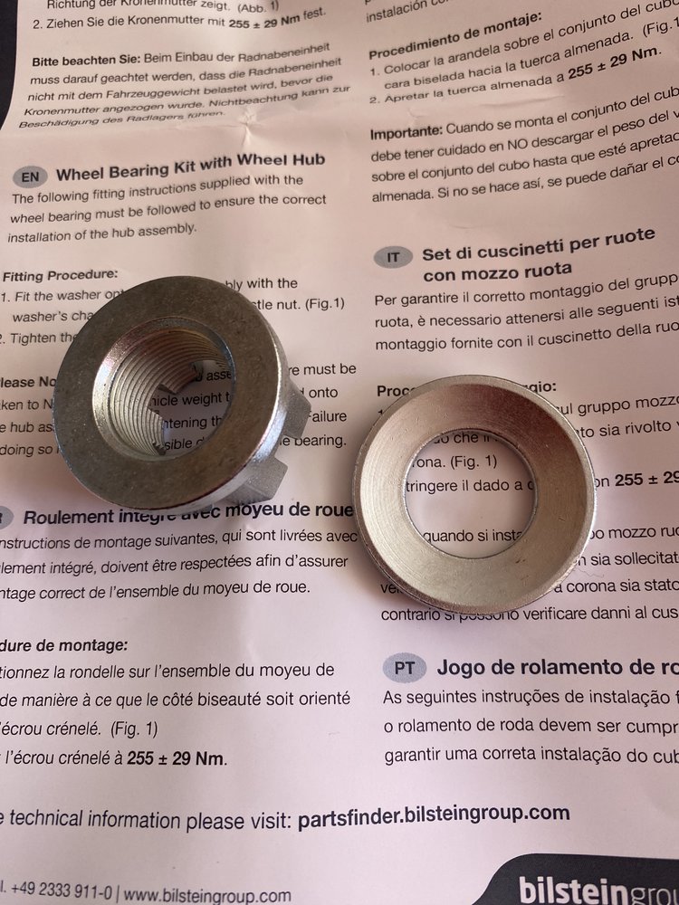

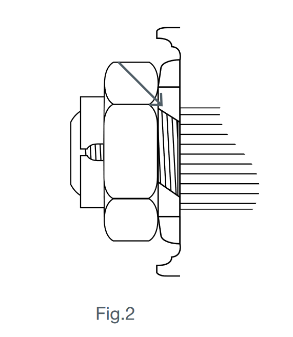

Strange on that I have been supplied with a concave washer with the wheel bearing kit for my Shogun. It’s normally a chamfered edge washer that mates against the nut with flat edge on the wheel bearing and the included instructions refer to the chamfered washer too. The wheel bearing has a flat surface as well as the nut.
Anyone @premmington know which way it should be orientated. I can always use the chamfered nut but assume the change to concave is for a reason
