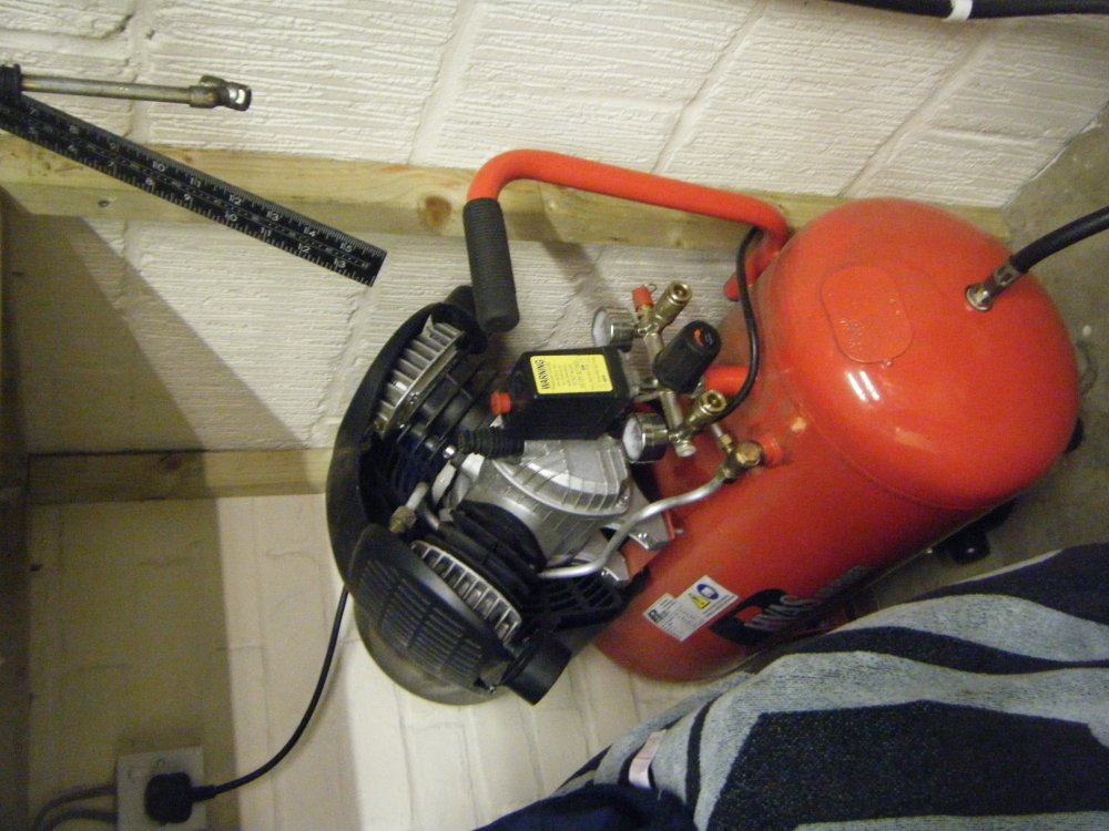

I have a little 50l, twin piston direct drive compressor, its in my garage which is in a block for the people in our close, my garage backs onto someone elses garden, I have only been here for 7 months and don't want to annoy my neighbours, its also to loud I usually get out the garage when its on, I downloaded a decibel app on my phone and measured it at 86db.

the compressor sits under my work bench, I plan to build a wooden frame around the compressor then board it off with mdf or ply wood and have a door at the front so I can get the compressor and turn it on and off and drain water etc. all the joins would be sealed up with silicone sealant and a small rubber seal around the inside of the door so I closes tight with no gaps?

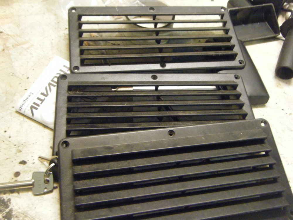

my biggest thing is going to be ventilation and cooling. I have a few of these in my 'random bits box'
I could place one low down at the back of the box which would such in cool air and one high up on the door which would let warm air vent out from. there is a large van on the back of the compressor which sucks air in and blows in over the pump, problem being I don't want this box to take up to much space and at the moment I run the compressor hard against the wall, this fan is then around 1 inch off the wall, is this a problem? I was thinking of getting a bathroom extractor fan to put into the side of the box with the flexible ducting to direct cool at the back of this fan?

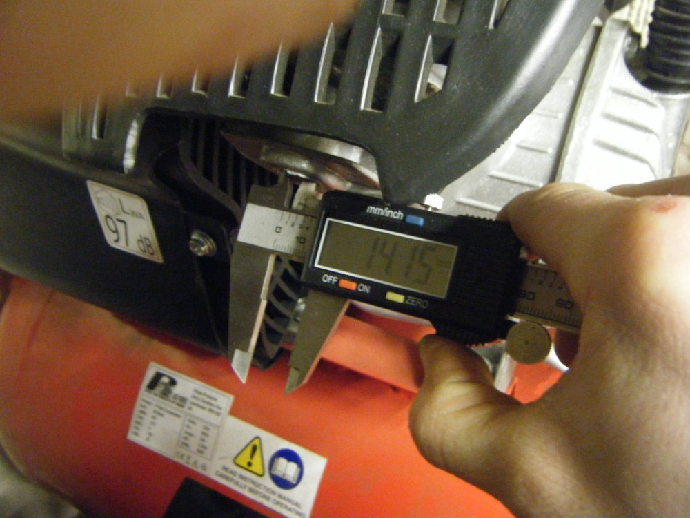

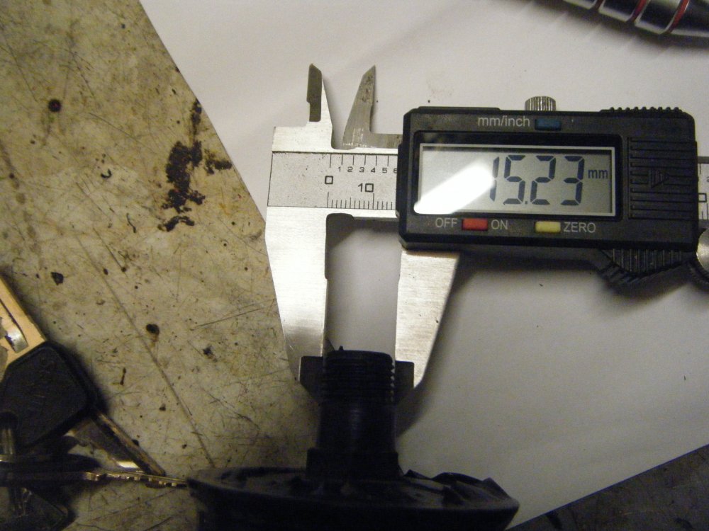

I want to remove the small air filter from the heads, and with the fittings and some hose running outside the box and mounted on the wall so I don't draw in warm air inside the box which will cause more water inside the tank? I need to find out what size the fittings need to be in the head, I know after using a gauge from my tap and die set that the pitch is 1.50, and my calipers show an external diameter of 15mm, it this a normal size?
one last thing for the time being in the hight of the box, the compressor stands 60 cm tall, my work bench that its under stands 95cm tall. I could build the box tight to the top of the compressor and have a little storage area on top or I could build the box right up to the bottom of my work bench is the top, giving me around 35cm of area for hot area to rise to and vent out, any input on that's best? Im thinking more of the second option

Nice project and great write up thread. I used to work with industrial cooling so will add my 2pth. That you have considered the cooling and ducting so well is great, you'd be surprised how many intelligent folk never give it a thought. A few questions with your setup as I understand it though; how well sealed is the inlet of the fan to the duct you have created? If there is chance for air to seep past here, it will increase temps. Also, is that a 4" duct for the inlet? I'd think that might be a bit restrictive, what's the open area of the motor fan inlet? I'd be looking at using ducting 1.5x the area of the fan inlet. If you negatively pressurise the inlet duct too much, you risk slowing airflow and encouraging leaks into it from the hot side. If it runs ok, then all good but if you do decide it needs some alteration, as you've done such a smart job on the construction, the easiest mod would be to add a decent flow rate fan on the box inlet/outlet.
