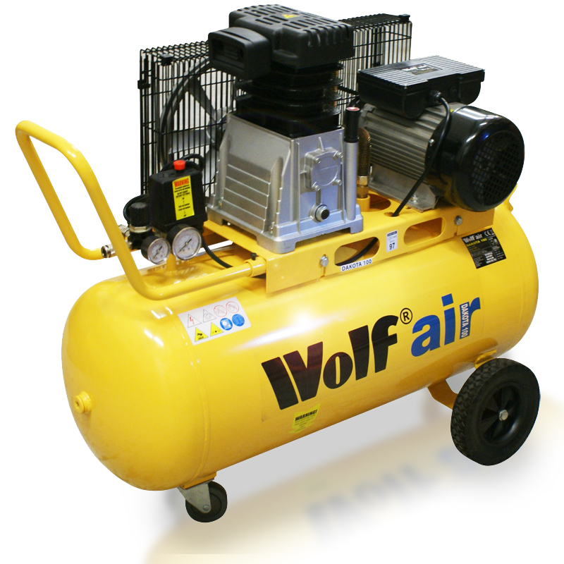

I have a Wolf AIR Dakota 14CFM 3HP 90 litre, belt drive compressor, same model as in photo. I'm looking into building a sound insulating box for it. I've Googled and seen a few ideas. I thought people, here might be aware of better designs or one I could easily adapt and be effective for my compressor.

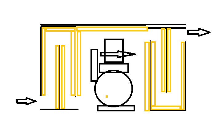

) you could drill and fill the hollow bits with dry sand or expanding foam.
