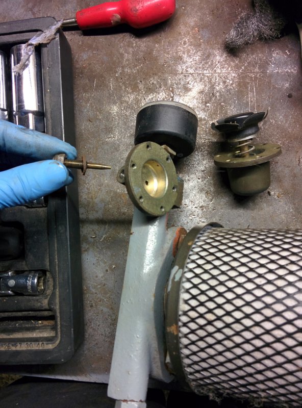

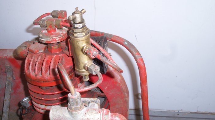

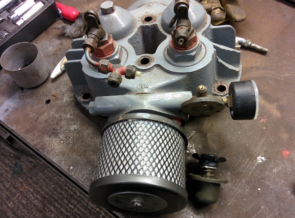

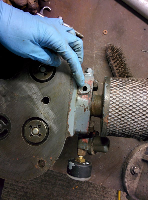

	eil That one has the oil gauge in the usual place on the crank case right by the oil pressure relief valve.There is an old thread where Archie put up a pic of his which I would say is the same as yours.
.I have tracked a guy down on another forum in new zealand who used to work on them and service them that was his job many years ago, I joined the forum and and messaged him but he doesnt know/remember re --that diaphragm unit either!!.

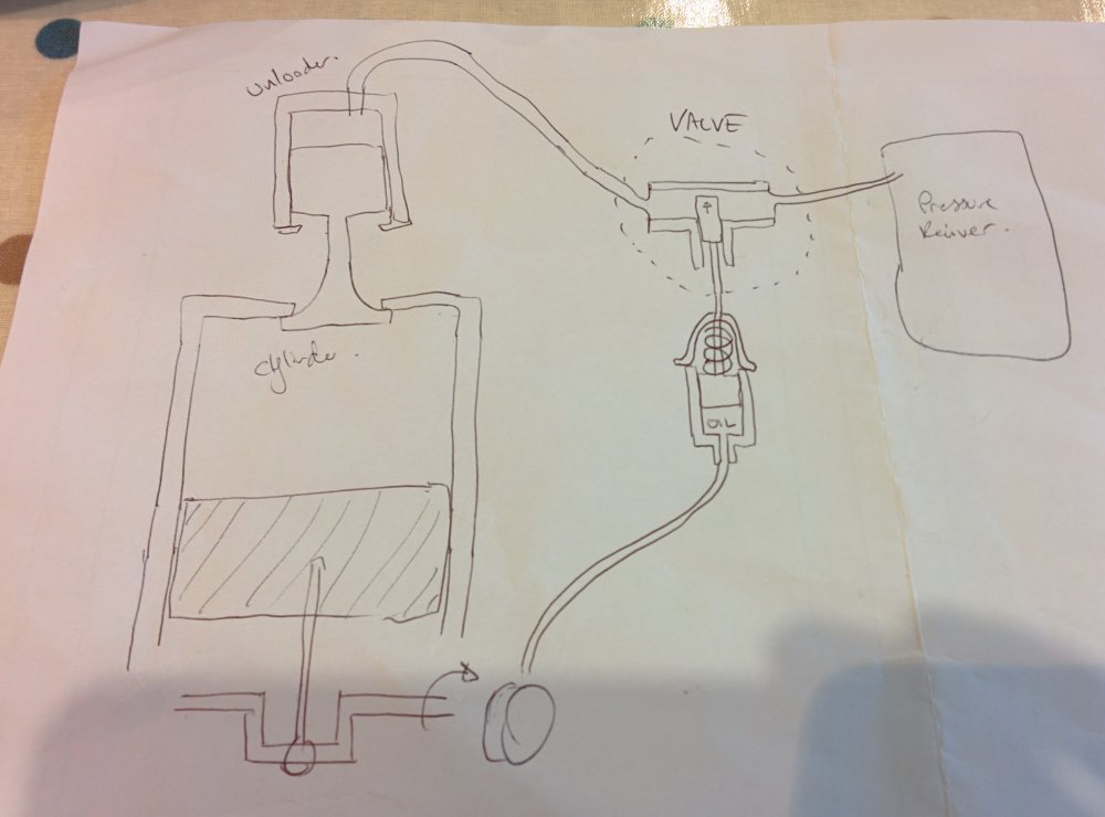

The problem with using a valve is the pressure made by the diaphragm would be short lived and the pressure would bleed away, before the next start.
What I have done in the past is to have a solenoid valve, than is NC in air circuit with the unloaders --------- then when in 'star' it opens and unloads the compressor,--------- as it gets to speed and delta kicks in the solenoid valve shuts again allowing the unloader valves to close and that lets the compressor start to make air but only when the delta is in.
That stops the motor being overloaded in the star phase of starting.
I understand the issue with needing a "supply" of air to maintain them in the open position. How about something along these lines;
The oil pump on my old aerostyle is just a single plunger which works off a lobe on the crank, so you could well be right that it smooths out the pulses of the oil pump or when shut down keeps a supply of oil above the plunger ready for the next start up.
