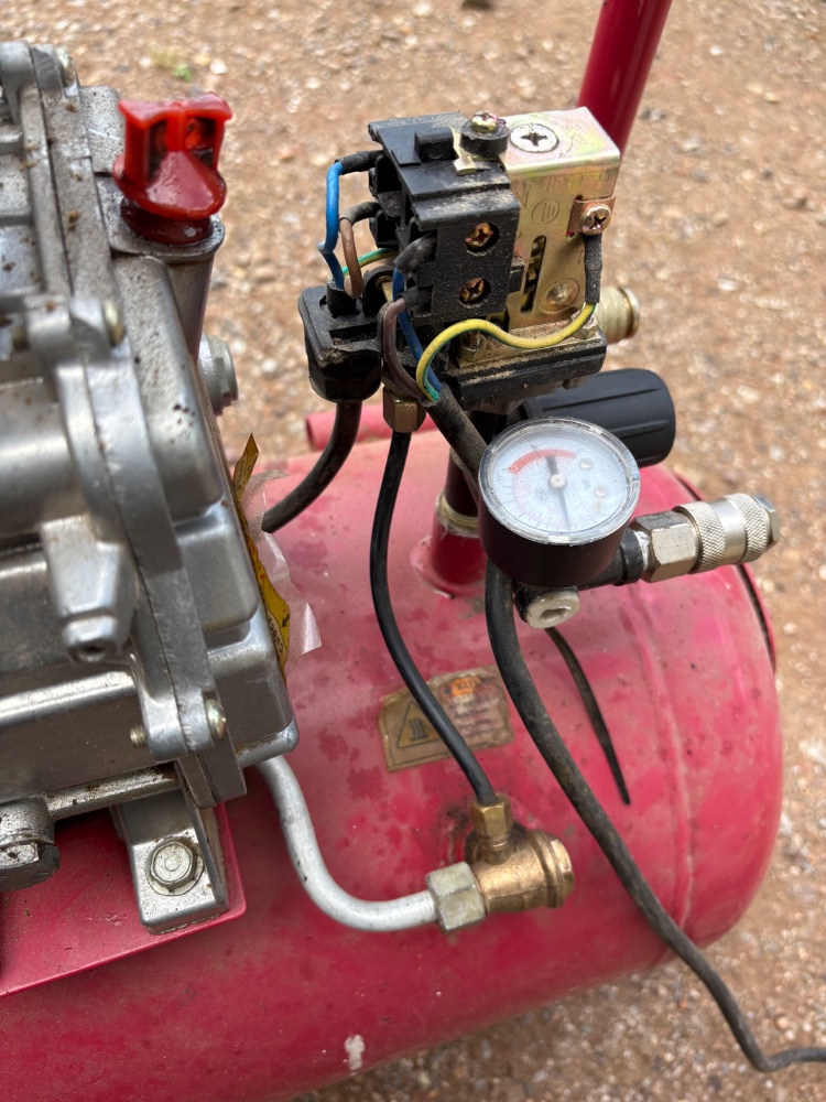

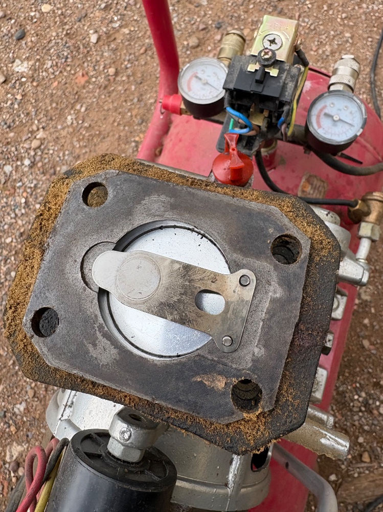

Has this compressor got an oil sump or is it an ‘oil less ‘ compressor.
If it’s oil less one, the fault might well be the PTFE piston.
They are notorious for leaking past the piston and failing to reach knock off pressure.
