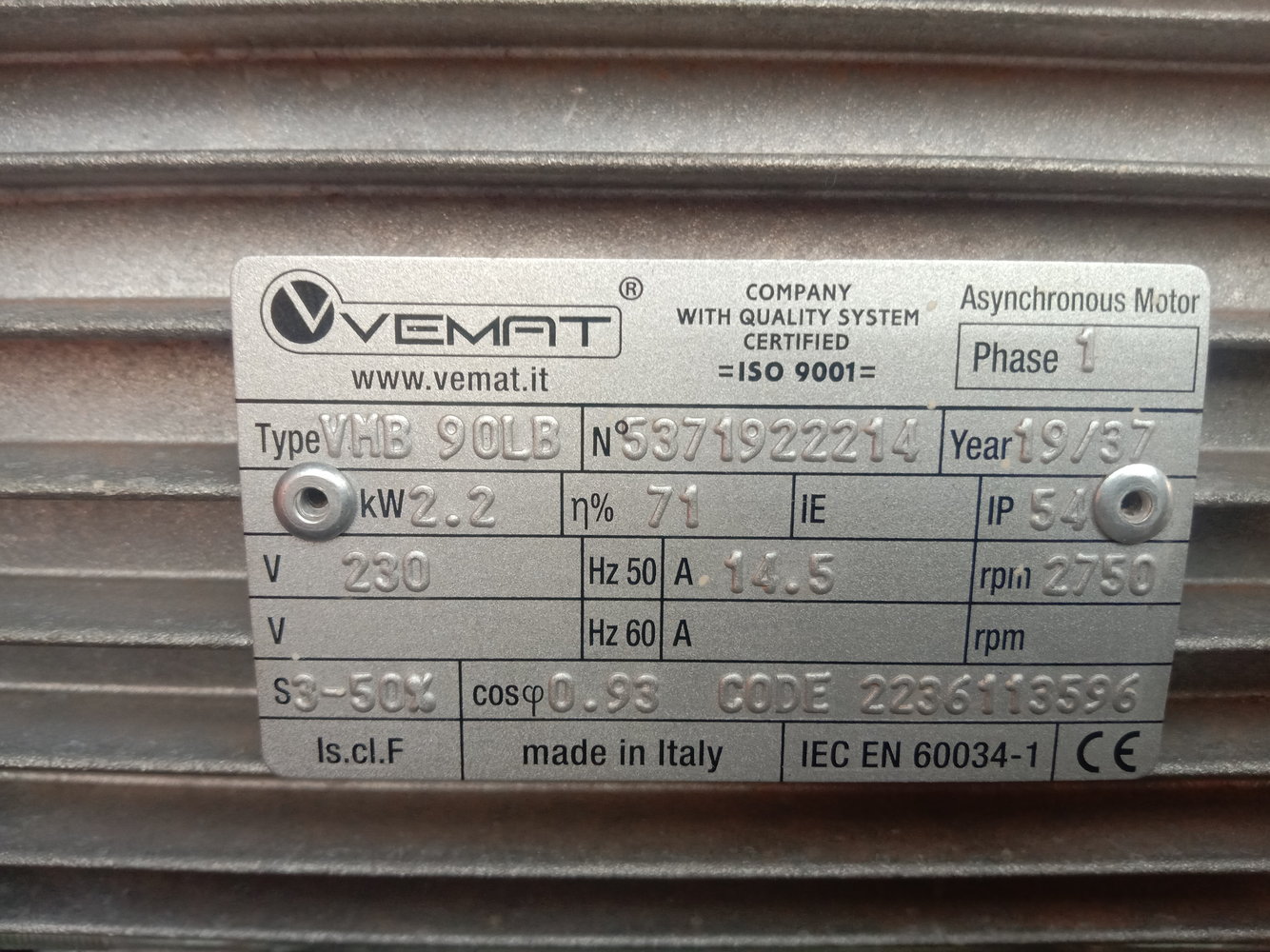

You mean the run capacitor may be the problem, but the motor runs very well when the pressure is below 5bar
C
yes, even at load below 5 to 6 bar it's fineSo under no load, it's fine.
Hence the problem.
OkClearly a motor problem.
Can you borrow / buy another ?

I will try it out and I seeWell, frankly sounds like the motor is overheating and pulling too many amps. It's probably the motor, but unlikely the compressor.
Try swapping the motor over is my thoughts.
I changed the compressor and I replaced it with a new oneUnless....
Something is locking up in the compressor head under pressure?
My bets the motor.
Well, it's not that then.I changed the compressor and I replaced it with a new one
but early morning, it can run up-to 10barClearly the motor as @Seadog said...
