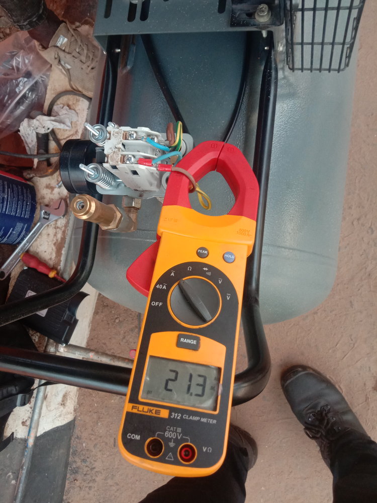

Looks like you have some good quality test kit - can you measure the voltage at the motor terminals while it's running? If it performs better in the morning, is the mains voltage maybe dropping later in the day?I have a piston compressor which is belt driven. It's 10bar but it cuts off at 5bar and then the motor trips. In the morning it can run up-to 8bar and trips. The piston pump when it reaches 5bar, it gets stuck but when you you realease air from the exhaust valve it becomes free. Kindly advise

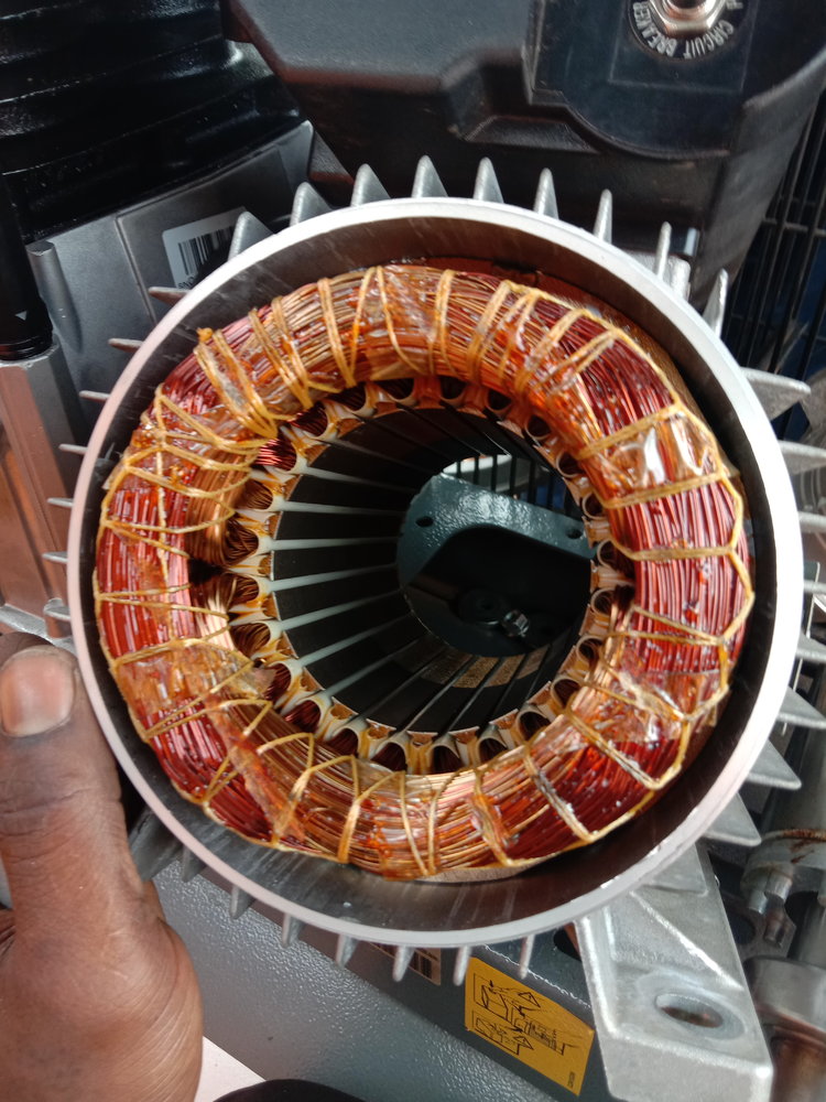

It could be a motor winding short that manifest itself when the motor heats up.

your welcomeLooks like you have some good quality test kit - can you measure the voltage at the motor terminals while it's running? If it performs better in the morning, is the mains voltage maybe dropping later in the day?
My compressor is a similar spec but 30+ years old - when I first got it I tried running it on a long extension cable and the voltage drop caused similar problems to what you're describing.
If the supply voltage is OK then as others have said it's either the run capacitor or shorted windings in the motor due to overheating.

When it was runningWas the current that is showing on the clamp meter obtained with the motor running or stalled/stopped?
