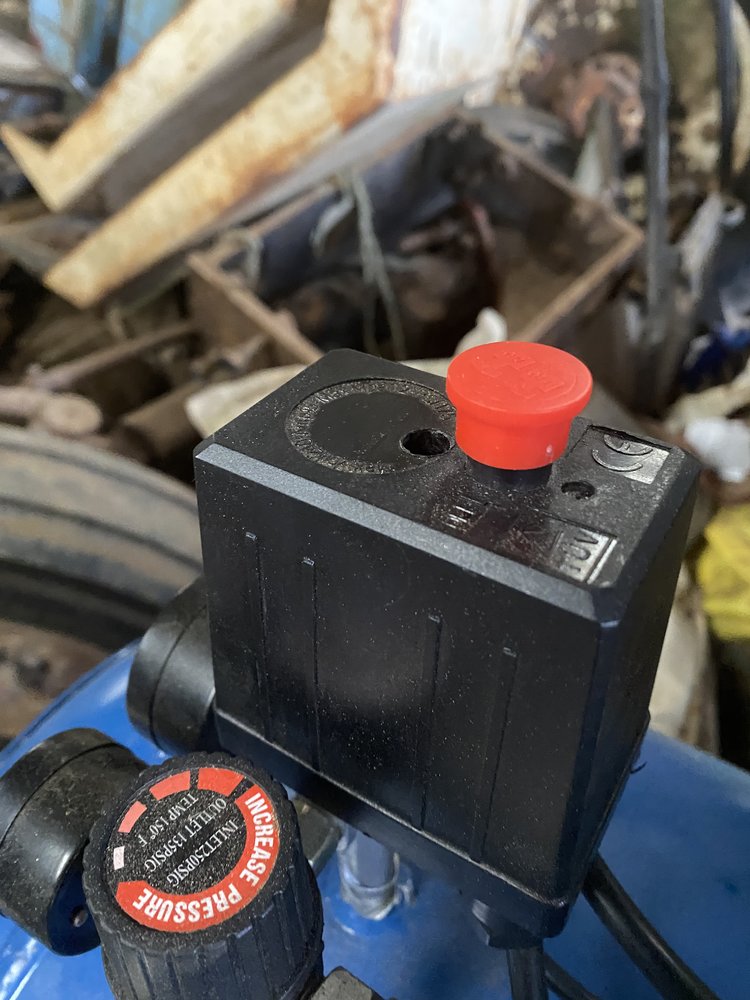

You need to be looking at the pump again if you've got no leaks only 4 things can stop it, piston rings, Reed valves gaskets or a crack in the reed block etcYeah it was bought faulty.tank holds pressure when switched off,no air leaks etc.as said everything stripped clean up and reassembled with new gaskets.i did strip the pressure switch down aswell and noticed just a tiny bit of crap in where the exhaust tube fits into it(the tiny spring loaded pin what shuts it off at pressure)so guess that wasn’t helping.just grabbing a new safety valve now from maccy mart,and will report back
