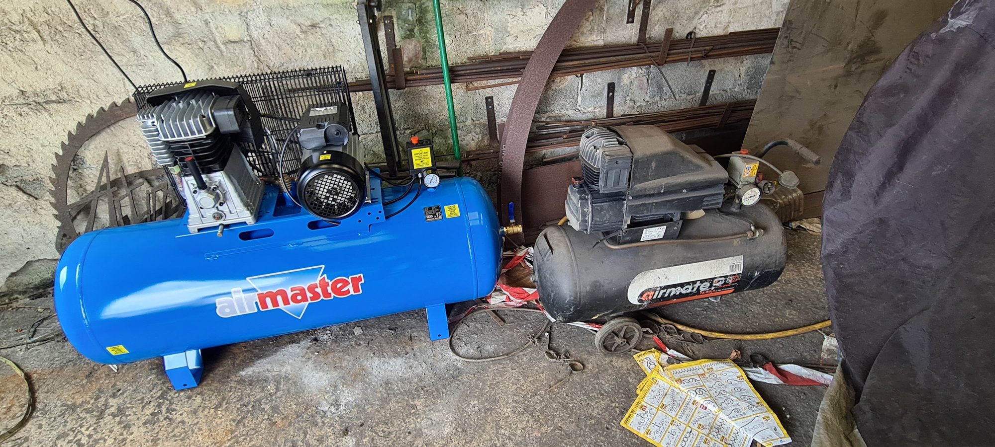

While it is still new, I'd check the size of the pastel in the Non-Return-Valve with a decent caliper and mark it on the receiver. You need to be able to measure to .1mm. If you wait until it fails,it mat have squidged a bit and measuring the old on will not necessarily get an accurate measurement. If yo fit a pastel that's fractionally too big, it can stick. It's worth getting a spare now, to save hassle in the future. It's also worth getting a spare inlet air filter element for the box-type inlet filter. I don't know whether that pump will accept Solberg-type inlet filters. If it will, they'll reduce inlet noise. Even the cheap Solberg-a-like ones work well. It's never a big difference, but it is often noticeable.
The best A/V mounts I have found for noise reduction are Paulstradyn. The movement on start-up can be a bit of a shock the first time you see it. Probably not worth it on a concrete floor, but we have compressors on wooden floors in shipping containers and it can make a lot of difference over "normal" rubber mounts.
