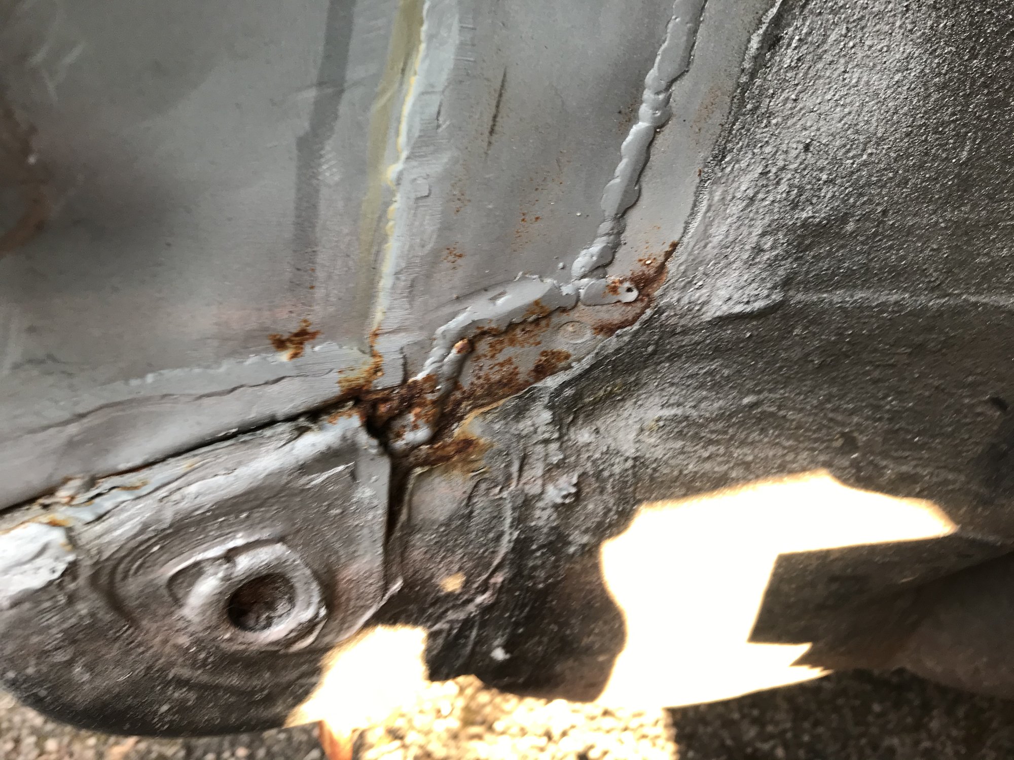

Hi everyone, apologies for another what compressor thread. I’ve been through the forum and had a look at the FAQ and found a couple of currently available options, but wanted some advice/opinions before making a purchase. The two seemingly suitable compressors I’ve found are -
Clarke XEP15/50(OL) 14cfm 50Litre 3HP Portable Industrial Air Compressor (230V)
https://www.machinemart.co.uk/p/clarke-xep1550-portable-industrial-air-compres/
Wolf Dakota 90L Air Compressor 3HP 14CFM 230V Twin Cylinder 10BAR 150psi (Compressor Only)
https://www.amazon.co.uk/dp/B007VOLOHG/ref=cm_sw_r_cp_api_i_NpaNEbB4FFYJH
I’m not sure I’ll be able to fit the 90L tank in the space I have, but if it’s the best option I may have to just find a way.
The primary use will be blasting car bodywork to remove rust - not large projects, more for tight areas/crevices/places other mechanical methods can’t reach (example pic attached - paint to be removed and welding properly dressed). It’ll just be in my garage/on the driveway (no dedicated area available) so containing the dust will be another thing to deal with also.
Will either or both of these compressors cut it for what I’m looking to do? If not can you recommend any others? I am a bit budget restricted (to be honest the clarke is already a bit beyond it) but I don’t want to buy something that won’t do the job!
Cheers!
