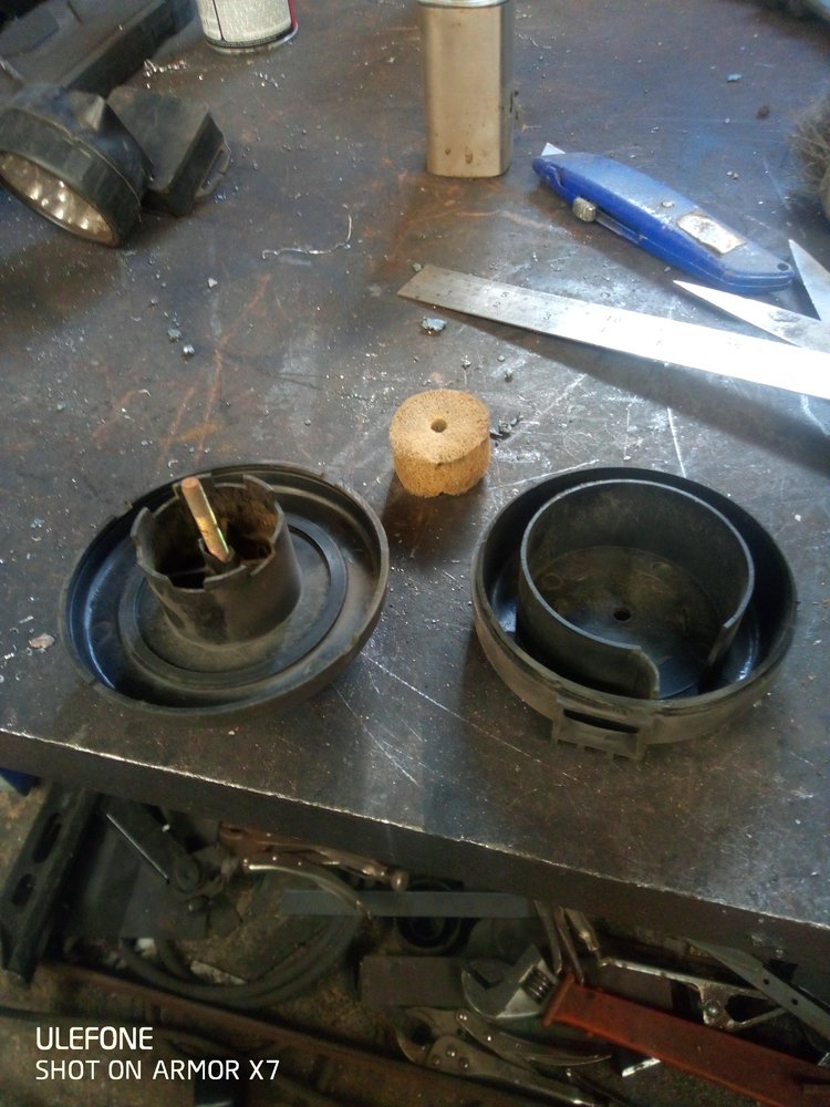

It's where to find one that fits which is taxing me!people have retro fitted car type air cleaners or plant to fit
One that's off your car? Not being silly, if you use the same one as you've got on whatever you drive, you've a ready supply of filters. Every time you get the vehicle serviced, keep the filter for the compressor. The slightly reduced flow/efficiency of a s/h car filter will be insignificant (presuming compressor displacement is way smaller than the vehicle)It's where to find one that fits which is taxing me!
most small petrol engines just have foam filters in them nowt wrong with that as long as your not using the comp in the same room as spraying . just clean them out once in a blue moonSome good ideas to mull over. I was hoping there were some standard ones I could buy off the shelf. Am I right in assuming that the little foam plugs are standard and there's nothing actually missing then?
It's never gonna let you down.Draws air in through the air Rick in the wall.
It's going to be running my plasma table, so I want the air nice and clean. I'll get a refrigerated drier with filters eventually, meanwhile I have a water trap and a cartridge filter. The better the air going in the longer the cartridges will last I'm thinking.most small petrol engines just have foam filters in them nowt wrong with that as long as your not using the comp in the same room as spraying . just clean them out once in a blue moon
