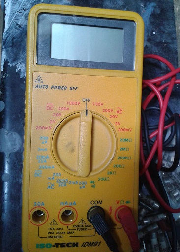

In the absence of any kind of proper testing equipment, clamp meter. meter with a capacitance function, take the motor off and pop down to the nearest motor rewinds place or if you know of a sparky get him to test it for you, by-passing safety switches when you are not pretty clued up as to what they do and the consequences of such actions could well land you in deeper water. Get the caps tested out first.

Have you a capacitance function on it ?. Do you still have the meters destructions to check up on.Yes I do see your point but I do have a multi meter ? not sure how to use it properly ...
thats what makes men MEN... the necessity to own kit that we don't have a proper understanding of how to use correctly.Yes I do see your point but I do have a multi meter ? not sure how to use it properly ...
