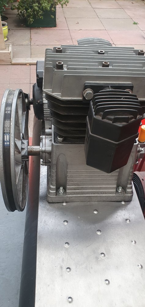

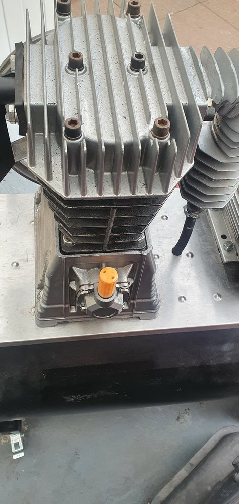

well just been to mm and dont have any in stock just typical ,, so going to order one online today can get it for tomorrow, just it doesn't say what bar it is so not sure if will be ok

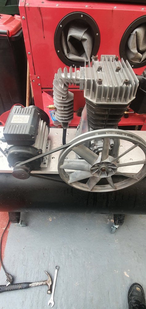

Pop the piston and clean the rings.ok so i got a new valve and its still the same gets to about 30psi and starts to struggle so im guessing it wasnt the valve at fault , am i looking at worn piston rings now then
but soon as put belt on it just slows right down
Small pulley on the motor means the pump will run slowerTom,
What is the pump output pipe made of?
They are normally metal, but I see a hoseclip on the manifold, which probably means it's rubber so it may have failed inside due to heat and pressure.

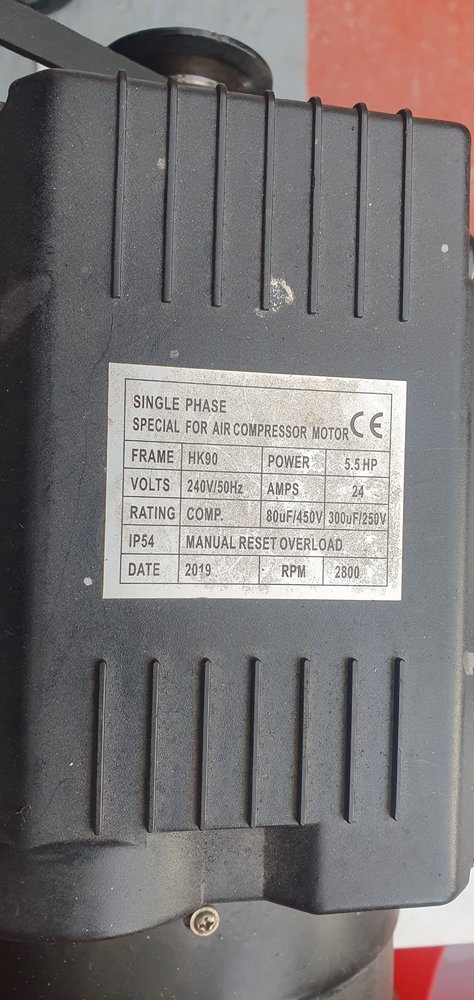

It's also odd the motor has a small double belt pulley, but the pump doesn't + the big ali plate. My 3hp comp has a much larger 100mm or 125mm motor pulley, so possibly the pump is being over rev'd. and may explain the squealing belt slip.
You comp seems to have been built from bits m8.
And it's a 2800rpm motor DUHHH!
