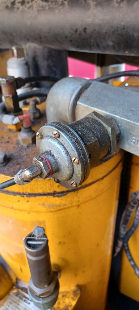

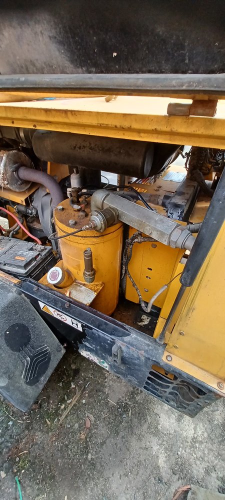

We have a compair H37 road compressor that we use for sand blasting. When we turn it off the compressor dumps a load of oil into the air line and out of the pressure valve in the pic on top of the oil separator
Does anyone know what's wrong with it and what we need to do to fix it?
