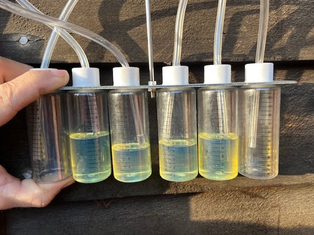

After my recent breakdown with my previously dependable Renault Master, I have been (slowly) going through possible problems.
They have a rubber/plastic primer bulb, which is notoriously problematic. They get an air leak and the fuel supply is lost. I saw there was no fuel in the translucent feed pipe, so worked the primer bulb and the fuel came back up, enabling me to start the engine again. Was sucking in air though, and engine didn't run well. have now replaced this with a Facet electric pump, and now the feed is working well. However, the engine used to start almost instantly, summer and winter, but now takes about five or six seconds cranking to start.
On hooking up the diagnostics to look at the fuel pressure, when idling there is 28000 to 31000 Kpa (280 to 310 bar) as the revs rise it tops out around 480 to 520 bar but holding the revs steady, it fluctuates between these figures.
Looking on t'internet definitive and specific info seem impossible to find, like it is a closed shop cartel. Mostly I find general info which states these older Bosch systems work at between 250 to 1350 bar, which tells me the rail pressure is not high enough
However, I did find a bit of Renault factory info that states that for an injector leak off test, the engine should be held at around 3000 rpm, and revs adjusted a little to get a pressure of 500 bar, held for one minute. So maybe the pressure IS high enough after all ?
What I have noticed though, is that when the engine is stopped, the rail pressure quickly returns to 20 bar, and then gradually drops from there. What I am wondering, and can find no info, is, should the rail be holding high pressure when the engine is off ?
I know there is a PRV in the rail itself, and would ASSUME there is a non return valve in the HP pump, leaving only the injectors themselves, or obvious leaks as a cause of the rapid pressure drop
Anyone got any ideas or info ?
I am going to do a leak off test on the injectors shortly, to see where I am with these.
