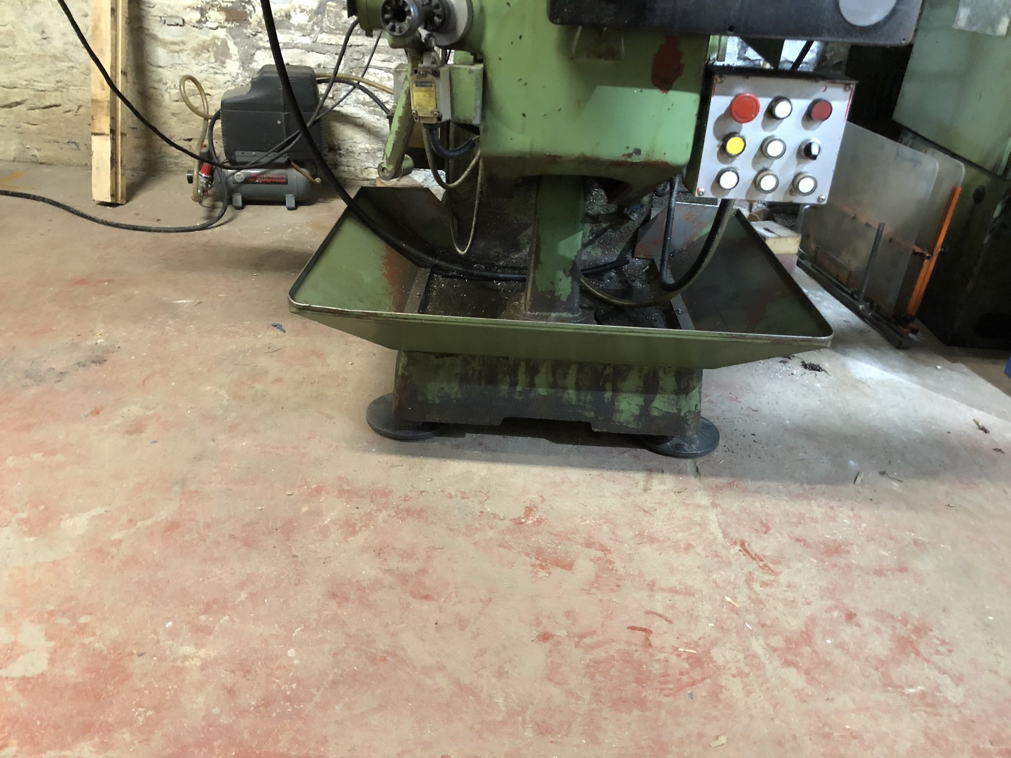

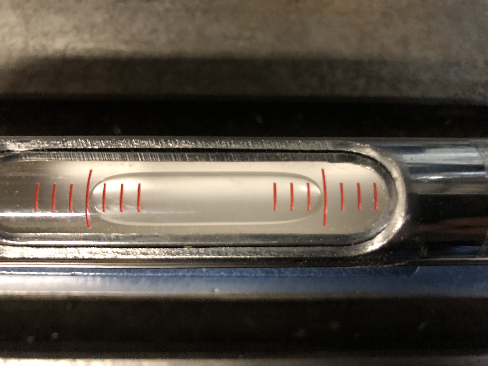

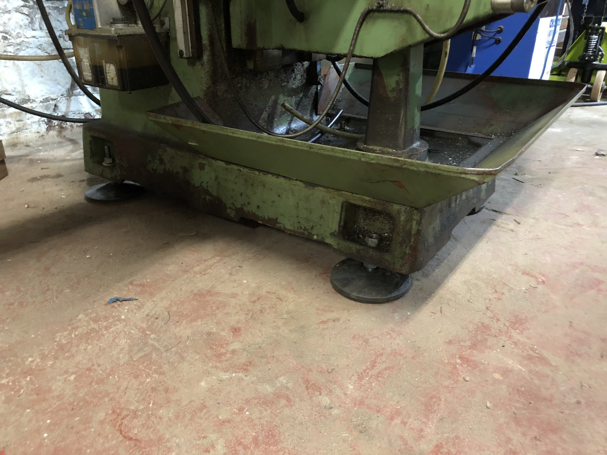

Now I just need to level it and run a airline to it.

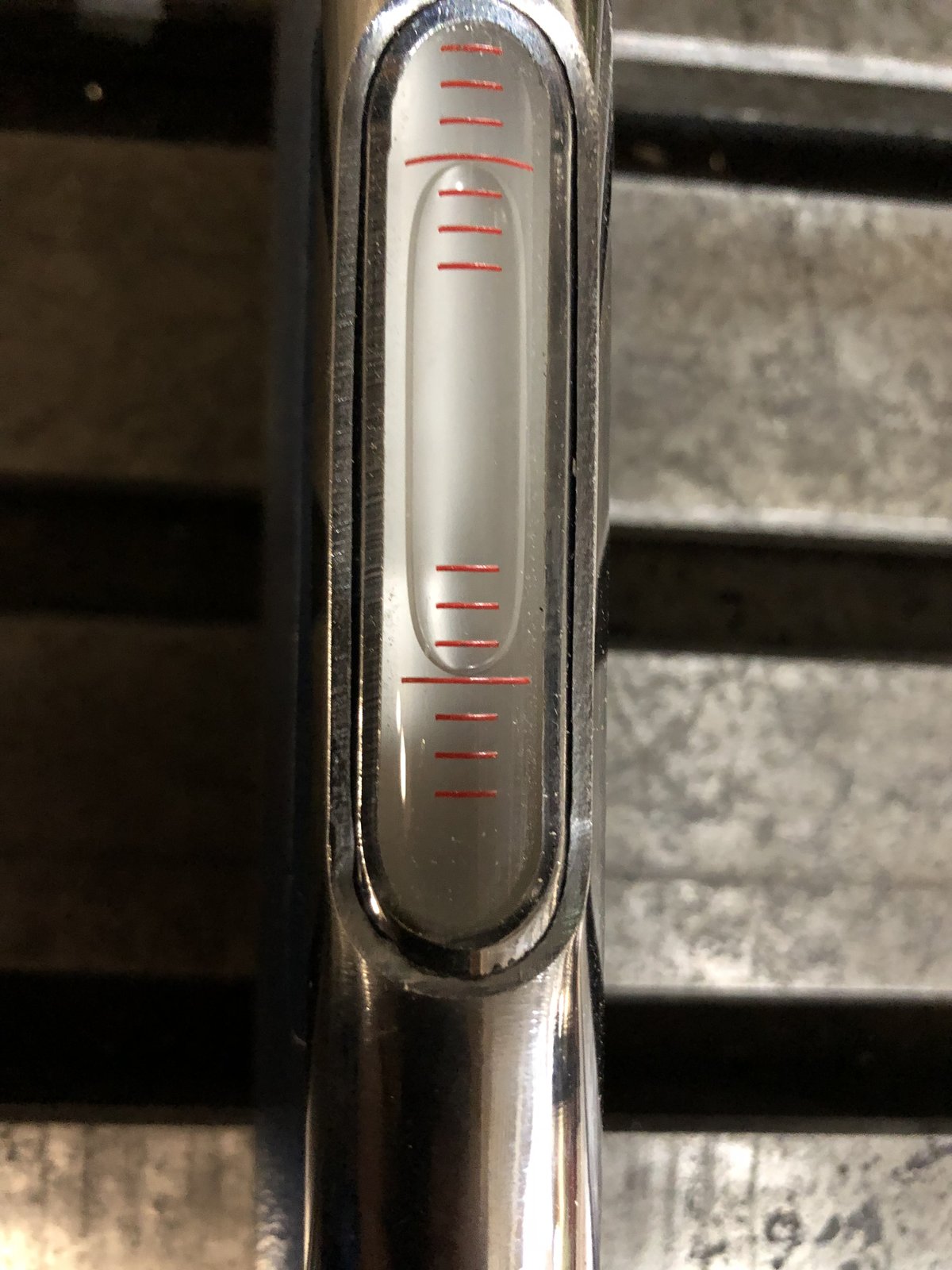

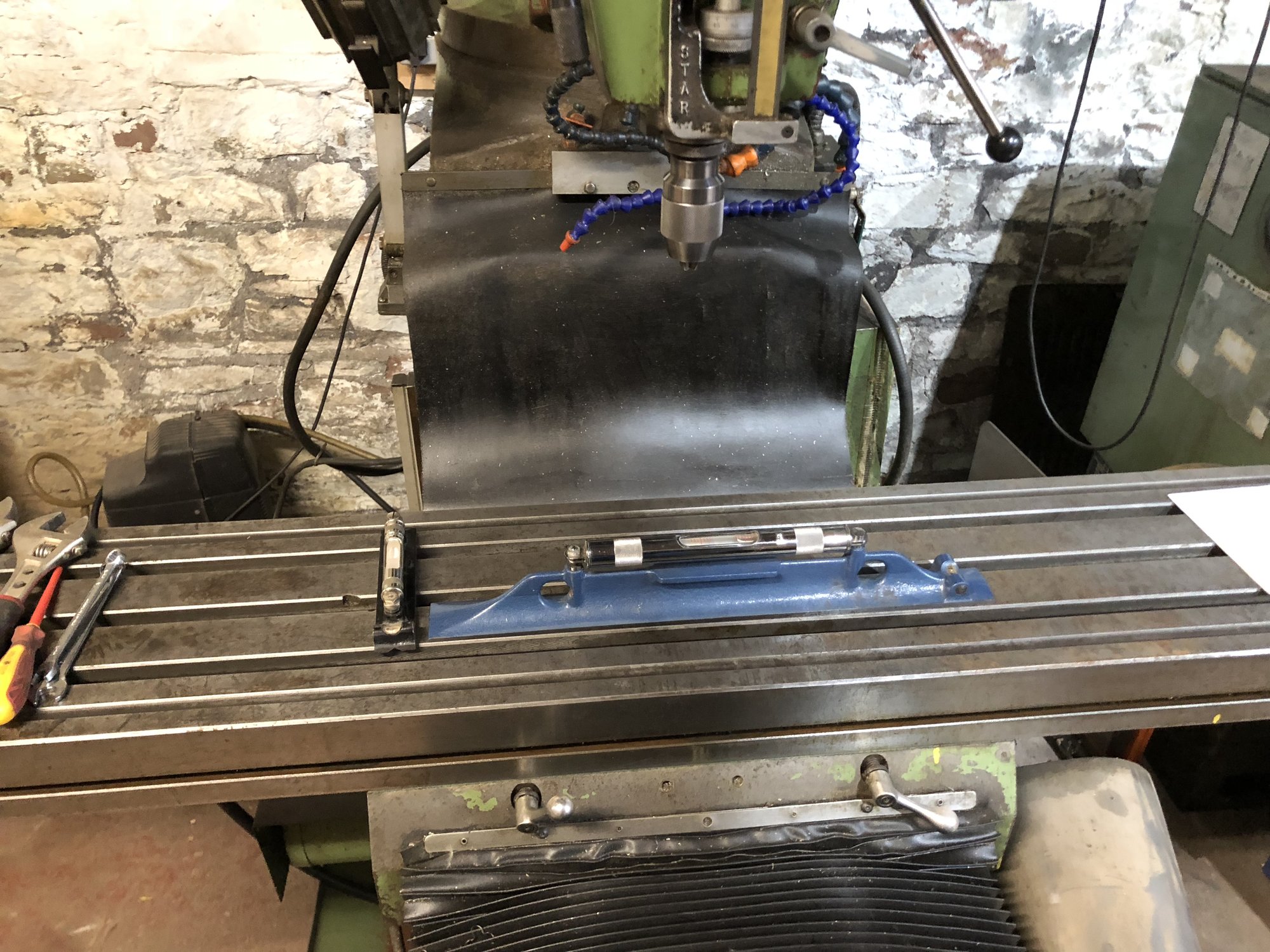

Pretty closeLevelled out the mill today using a Moore and Wright 18” machinist level.
Got it bang on:
View attachment 158986 View attachment 158987 View attachment 158988

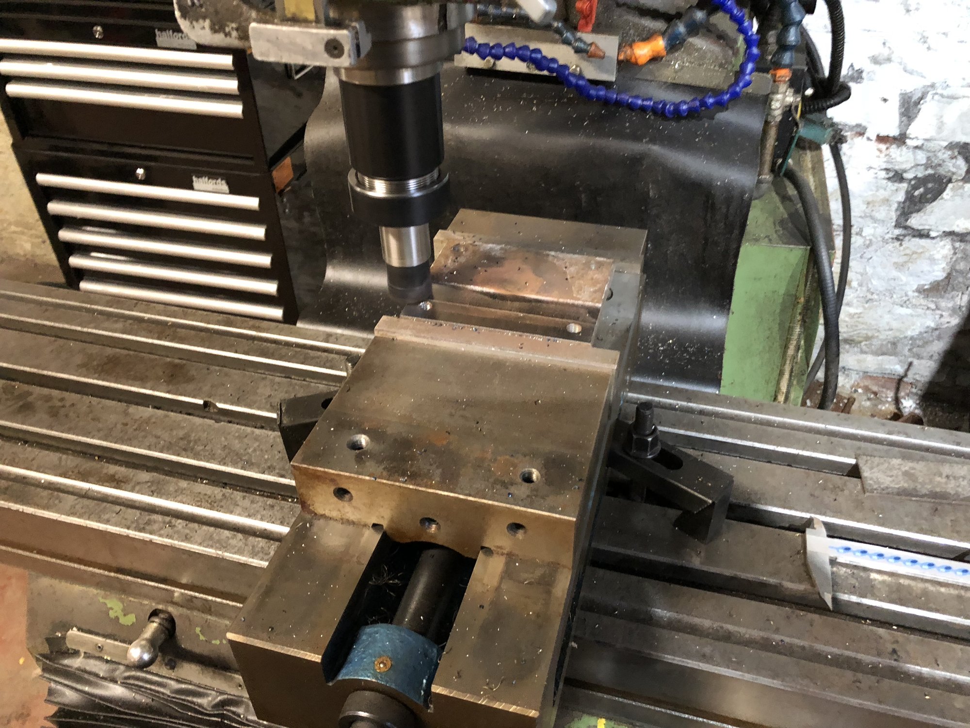

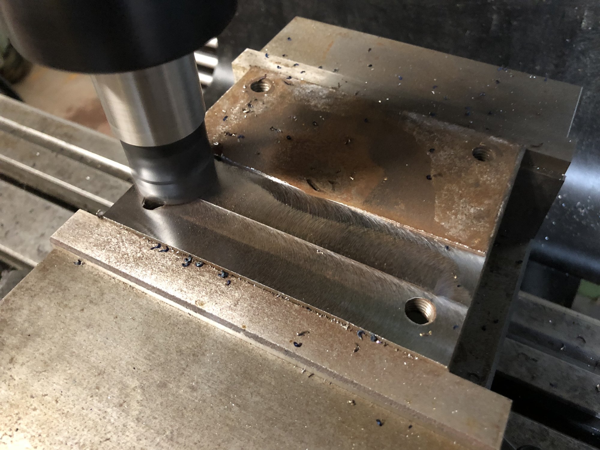

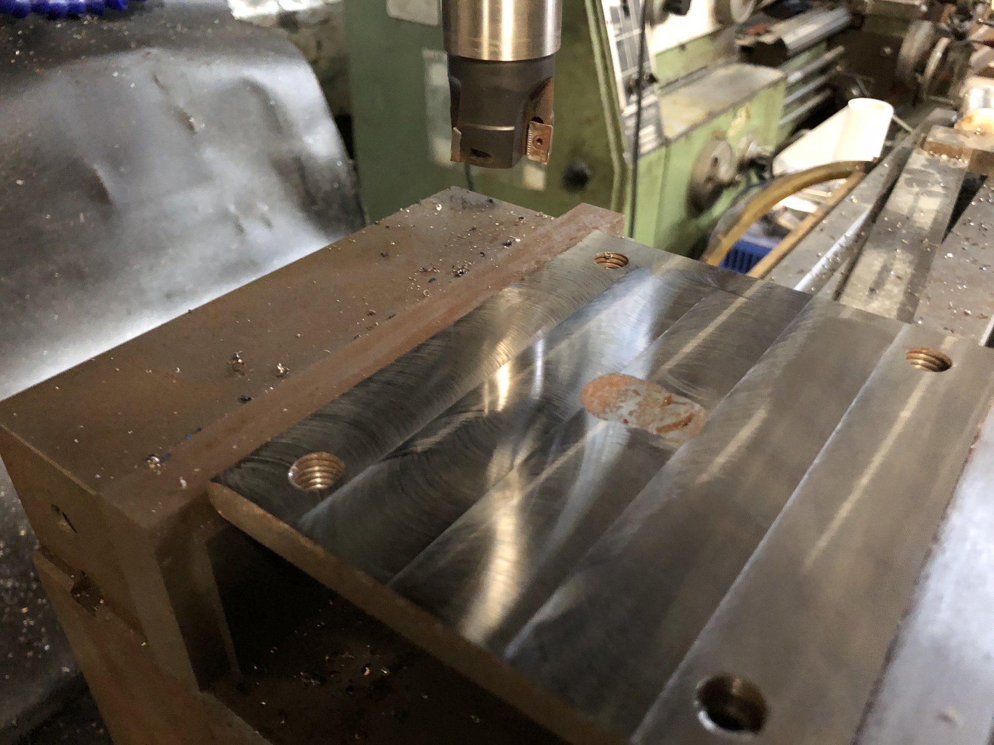

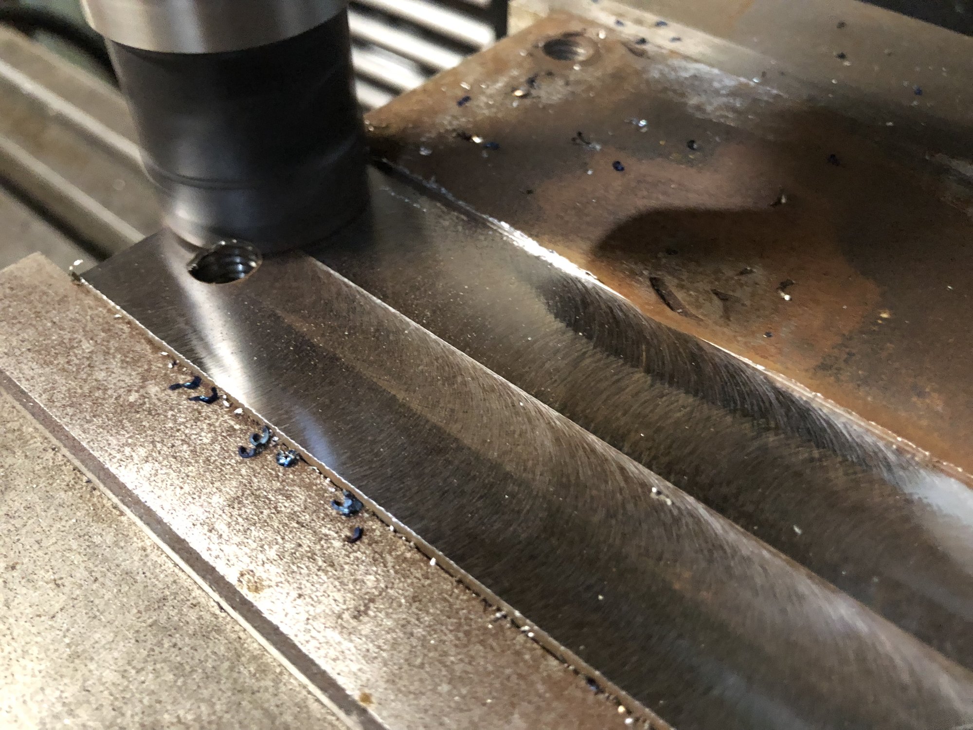

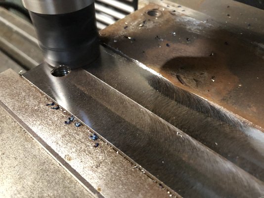

Nice finish Matt.Ran an airline to the mill today and trimmed the head in (not quite perfect yet).

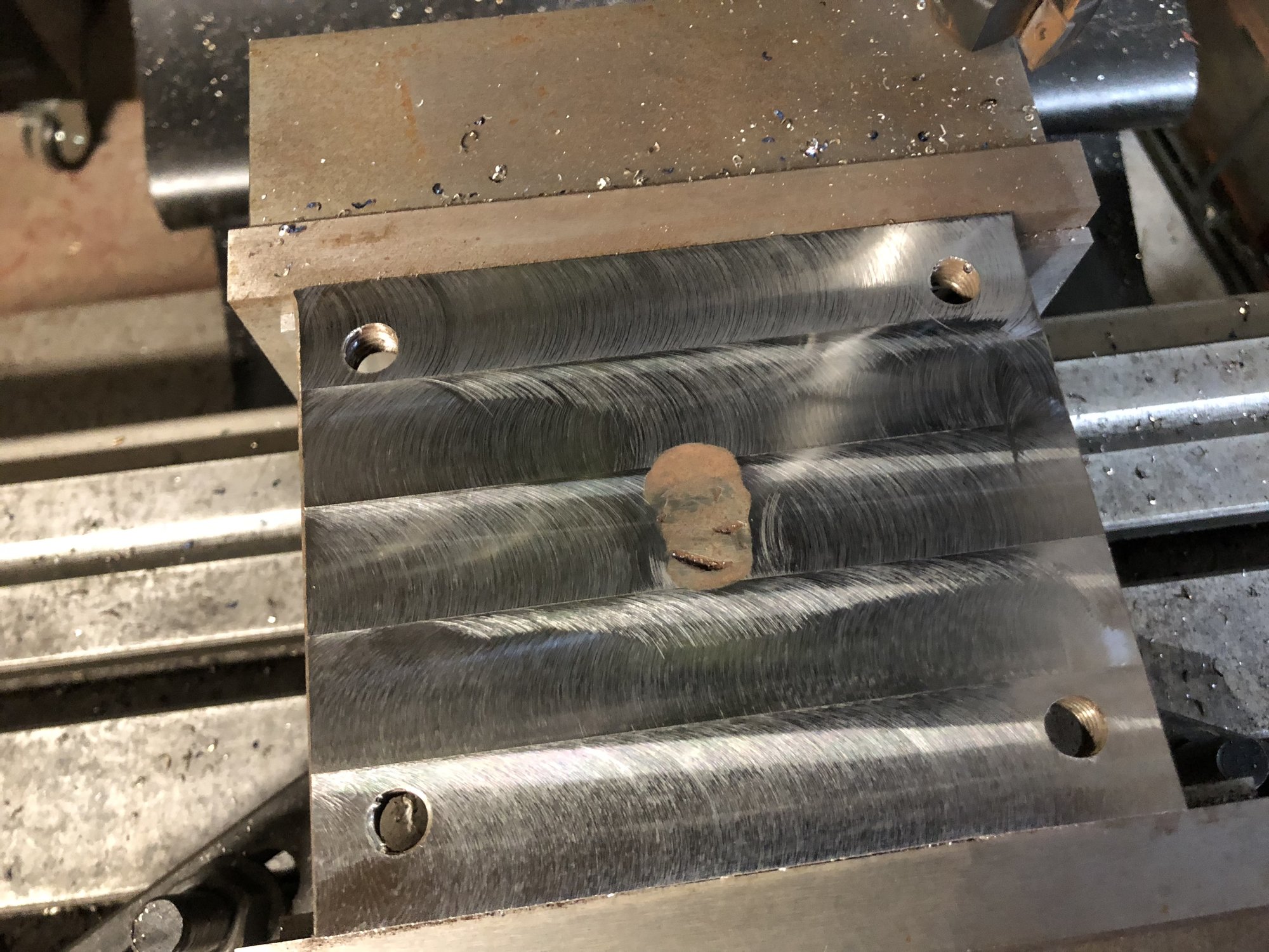

Mounted a vice and faced off an old piece of steel plate that was kicking around.
@Richard. some chips for you.
View attachment 159084 View attachment 159085 View attachment 159086 View attachment 159087 View attachment 159088
Video to follow.
There was a slight pause at the start of the next pass, is that backlash or is it just in exact stop mode or?
I presume the way the control creates a facing pass is exact stop. I ran some test pockets and circles the other day and they looked to be CV.
There’s no GCode here though so it’s hard to tell.
.....And this isn't (at this time) a business machine for me so I am not reliant on it.
