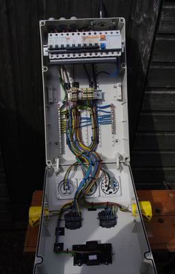

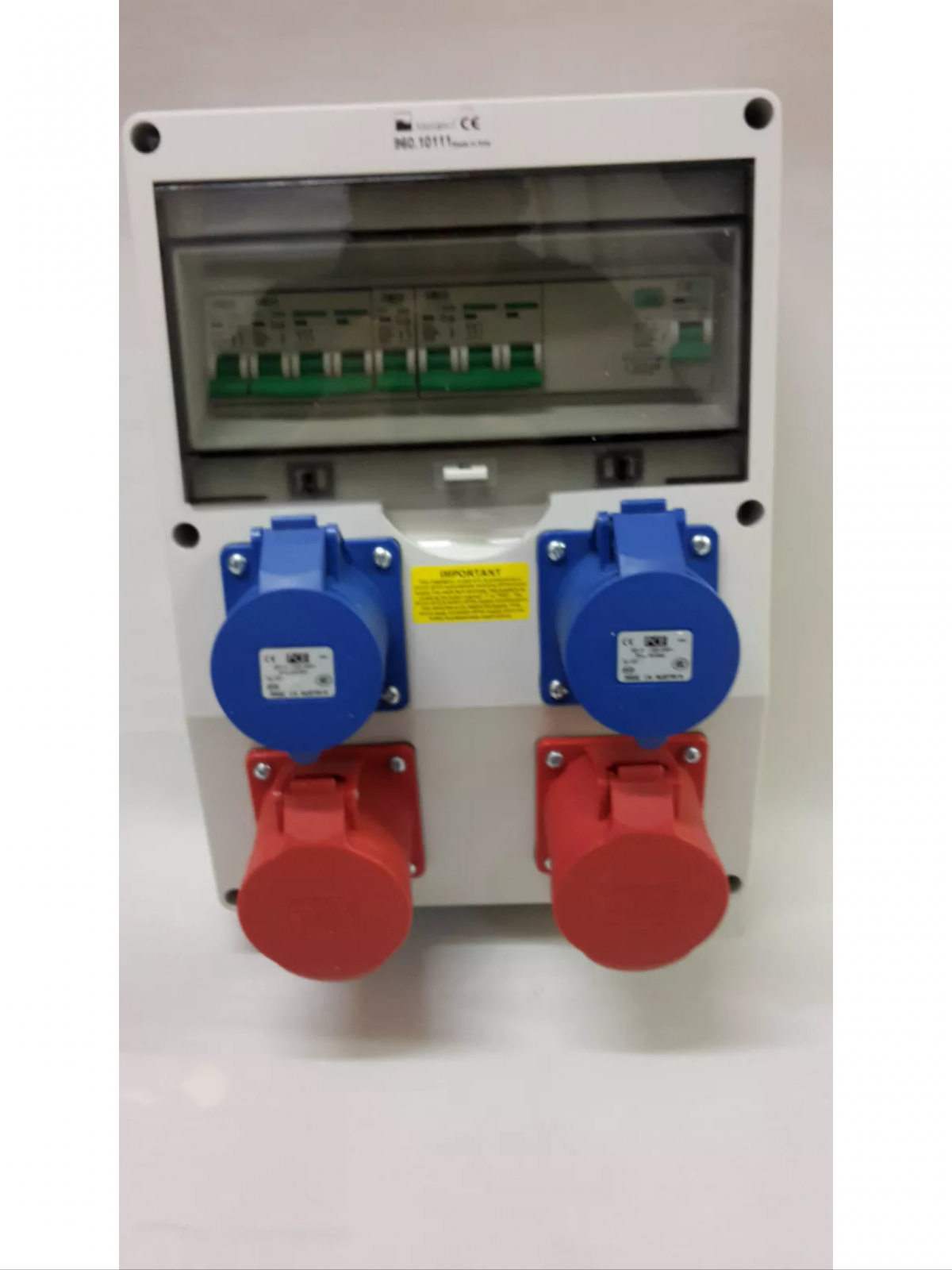

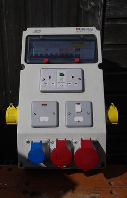

For a temp solution to my power requirements (which will all be at the far end of the unit away from the DU), would I be OK using a sub panel like this:
I could run a single suitably sized SWA cable down to it.
This would give:
1 X 32a 415v
1 X 16a 415v
2 X 16a 240v
All protected by an RCD and indvidual MCB's.
As I said this would be treated as a temporary quick fix to get me up and running with the minimal hassle. Later I would start running in all new high level trunking as suggested.
