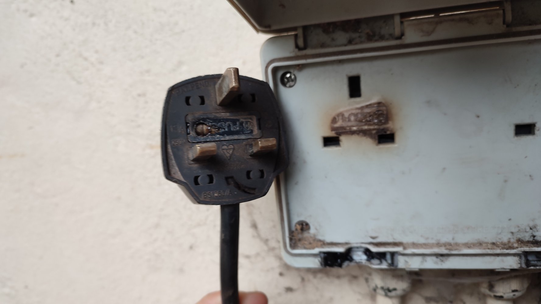

reason been a 13 amp fuse will happily run at about 19 amp constantly before it blows but the plug contacts are only 13 ampWhen I was running mine with the needle descaler, I was using a domestic socket for one compressor and the cooker socket for the other.
This is the effect of running them nearly continuously for 6 hours.
