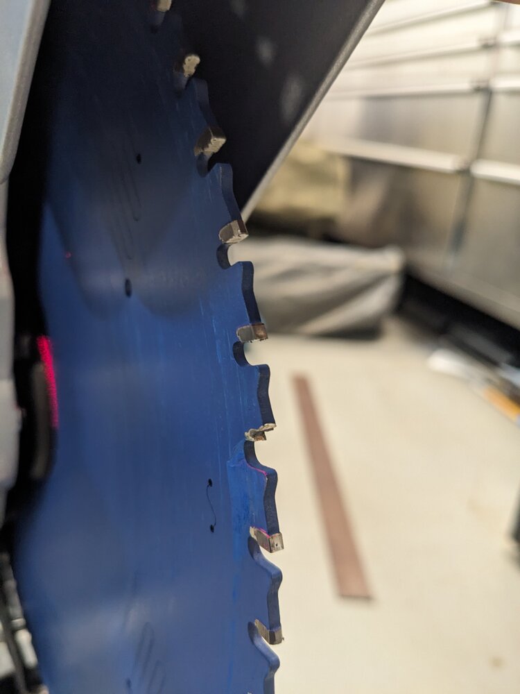

Hello,
While cutting up some steel for a project this weekend a piece I was cutting managed to come loose in the saw clamp. This resulted in the saw grabbing, jamming and breaking a tooth. Is this blade now destroyed? Is it safe to use? Can it be repaired?
Cheers
not a prob unless the blade is bent....
even in industry they were used with missing teeth....
They can be replaced but if its cutting OK dont bother...
A good idea to cut in a different place, or finish the cut with a grinder if you fear you've lost a tooth in a cut. If its embedded in the steel, good chance of hitting it and damaging more teeth.
