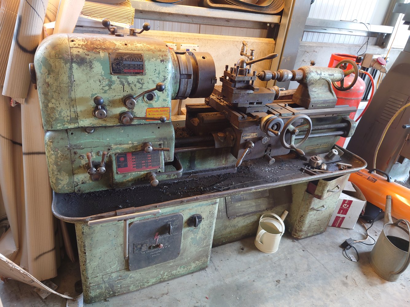

It's your lucky dayAnyone got the dims or can lend me a plate to suit the Triumph 2000? I've got two to collect at weekend and possibly a Mascot as well.
Sorry it took a while - Let me know if there are any more details needed / missing. All approx.
Deliberately left off the lifting eye, min length from collar to end of thread 67mm - don't go too much longer or it will foul on the web of the bed. The chamfers on the lower plate aren't strictly necessary - just help fitting.
Hi crazy_spanner, i am going to make lifting plates for my 1800, i see from sketch , top plate is 139mm long, what width are your platesSorry it took a while - Let me know if there are any more details needed / missing. All approx.
