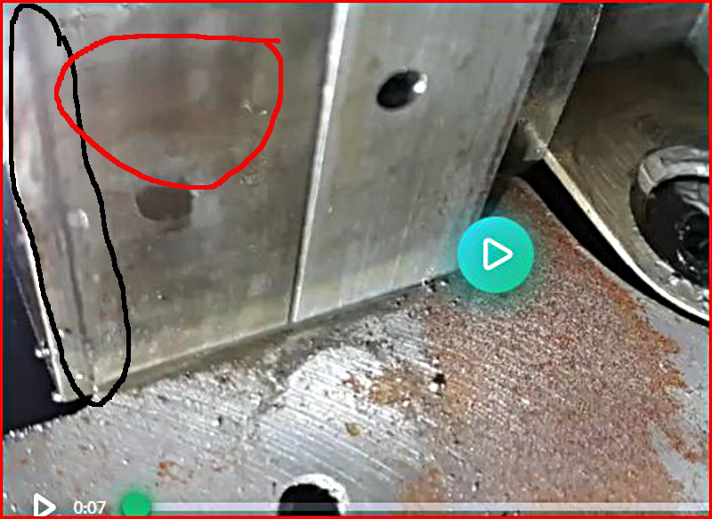

  6. Pete.
    Pete. Member
    Messages:
    9,427
    Location:
    Kent, UK
    It does, but not in the way you intend. Ok your cross slide nut is quite worn but look at the video again and ingore the front-back movement, look at the side to side movement you're getting. Try to adjust that movement out. If the slide goes loose and tight along it's travel then your slides are worn.
  7. Pete.
    Pete. Member
    Messages:
    9,427
    Location:
    Kent, UK
    Actually looking at the video you can see the wear. It's not terrible but it does need attention. There's a ridge on the left (circled in black) where it's worn the face of the way down, the red-circled bit is rust on the way because the slide is no longer running on the cast iron way but the steel (or harder iron) gib to the right, which has a shiny surface.
