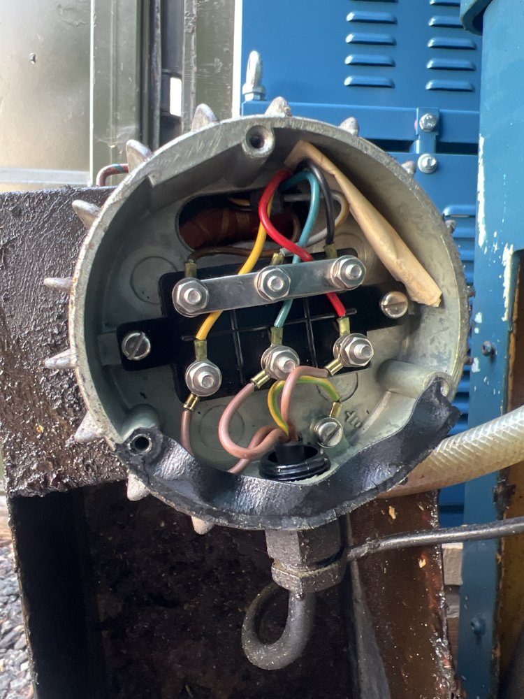

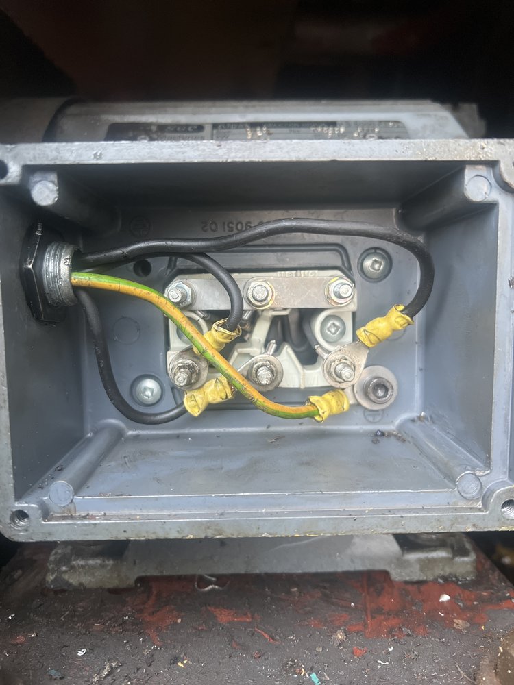

Thankyou Martin, so just to be clear as per your previous comments. L1 to 0 on the primary and L2 to 415 rather than 220.Both motors are star connected so you should be Ok to run like that from your Transwave. The metal link strips would be orientated vertically if they had been re-configured for Delta.
Just an update of how I’ve got on, I finally got down the workshop about 8pm this evening and managed to rewire L1 to 415 and L2 to 0 and would you believe it she’s up and running perfectly. I even had time to tidy up the wires from the DRO and run a couple of the first parts I’ve got to make on her.Yes, that is correct.
Hopefully that should get it running with that corrected. When you get it running make sure the direction of rotation of the main motor is correct. Theres a belt drive to a recirculating oil pump on Masters which probably needs to run the right way. Obviously the spindle needs to run the right way too, but the apron control gives forward and reverse.
Let us know how you get on.
