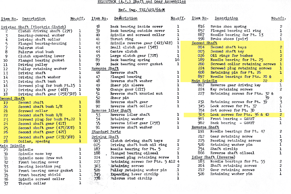

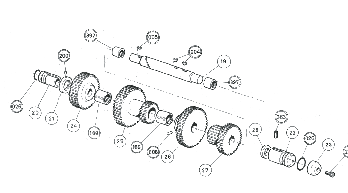

Well the pair of woodruff keys labelled 004 will never slide past the bearings 189 so the shaft will only exit to the right. 608 is a retaining pin for gear 26 so you'll need to knock that out and 363 seems to be a retaining screw for the RH needle roller retainer but it looks like it's mis-labelled in the parts list. Part 21 is listed as a screwed collar but it's not clear if it screws to the shaft or the bearing retainer. My guess it that it screws onto the retainer to pull it in and set the end float.
