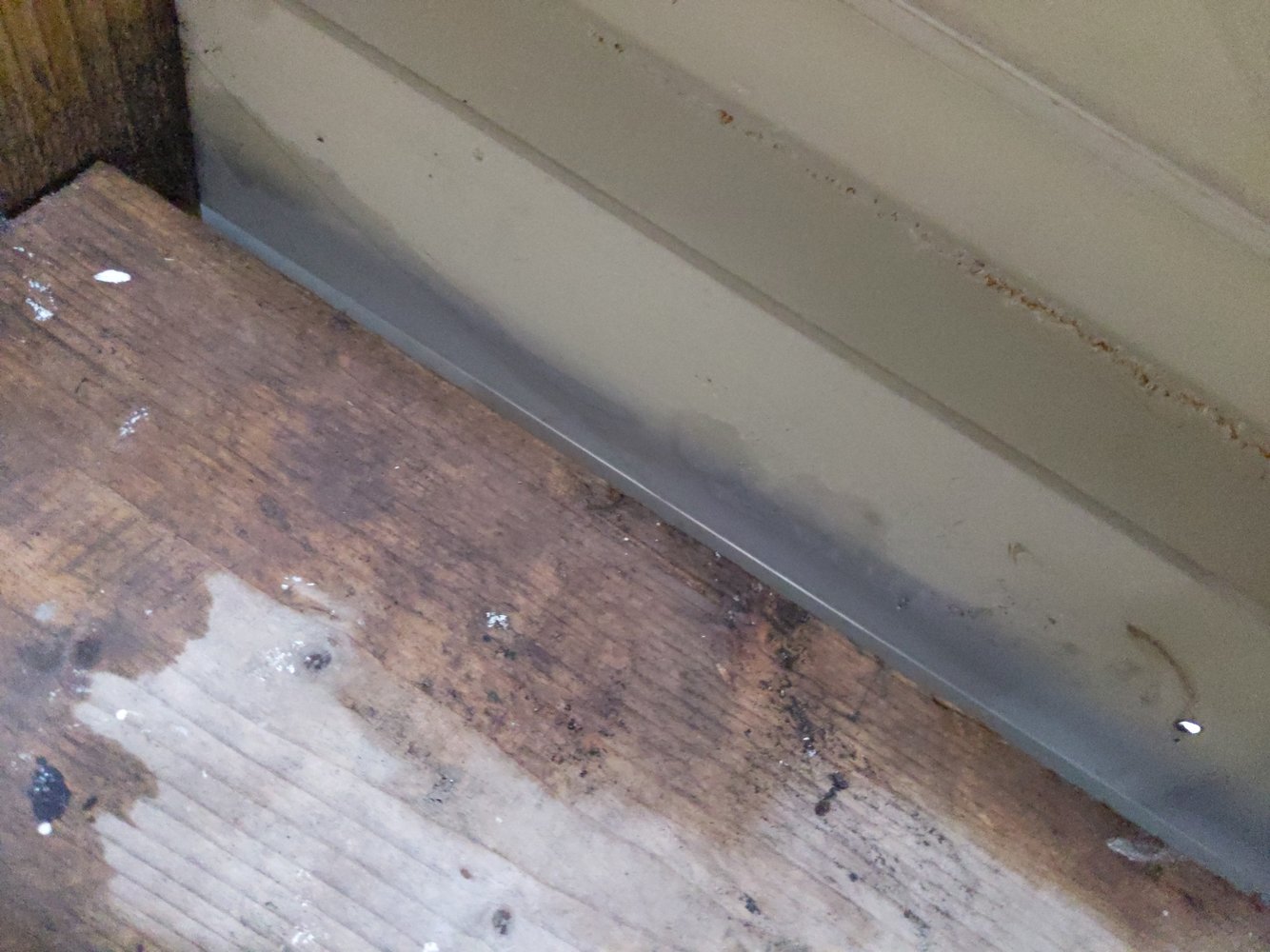

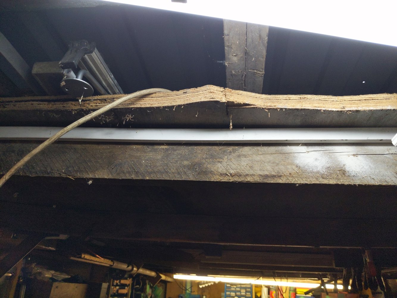

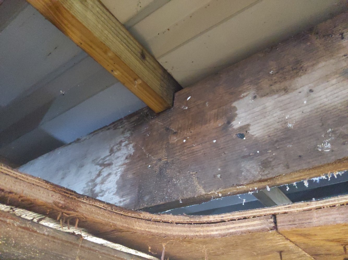

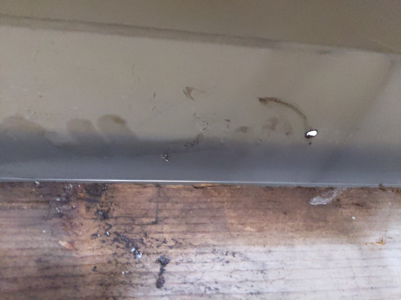

I've *still* got an annoyingly large drip into no 1 shed: despite me taking up the entire thing and sealing all the edges, seams, and screwholes with silicone sealant.
It looks like it's still coming through the screwholes. (2nd hand sheets, holes were drilled in gulleys)
The slope is about 1in10 (24" over 20ft)
So... I'm going to cover the entire thing in a thick coating of *something* that will seal the whole lot at once.
I'm thinking hot tar, mopped on (I was watching Shawshank redemption last night), but modern alternatives seem to be:
Ebercryl
black jack bitumous paint.
Fibreglass + resin.
It's around 20m², so not an insignificant area.
Any ideas? That don't involve me taking up the entire thing *again*
