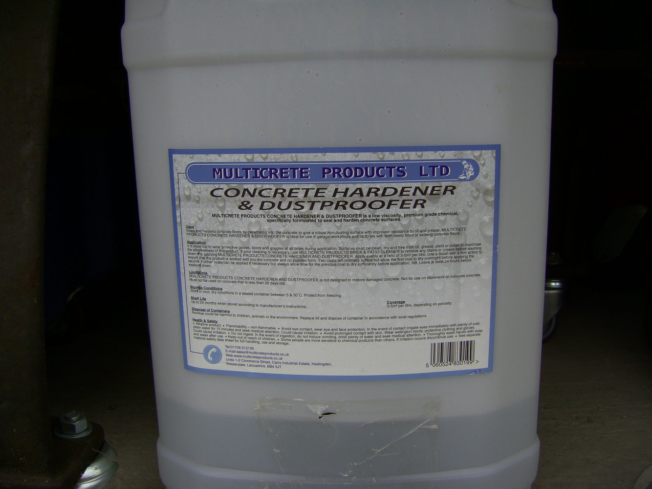

Any recommendations for coating concrete floor ,100ish sq meters of garage floor. Very dusty naturally, looking cost effective solution.
if u want cheap and tough without color sbr bonding agent .one coat watered down and put on with a sweeping brush will seal it. you can coat over with concrete paint if u wantAny recommendations for coating concrete floor ,100ish sq meters of garage floor. Very dusty naturally, looking cost effective solution.
ok i have been through 6 sellers on the ebay and non say the coverage yet, is it a bloody secret or something.if u want cheap and tough without color sbr bonding agent .one coat watered down and put on with a sweeping brush will seal it. you can coat over with concrete paint if u want
Polyurethane floor paint, follow the instructions
even waterproof PVA ?+1 on sbr. Cheap as chips from SF/TS.
Never ever use pva though. If pva gets water on it it'll get wet / slimy again. Even worse if you use pva under tiles, if water gets under the tiles the pva can "re wet" and the tiles lift!
watered down 50 percent will give you 2 gallons and go one hell of a way depends on how porous the concrete isok i have been through 6 sellers on the ebay and non say the coverage yet, is it a bloody secret or something.
So like PVA then, i have 10l somewhere in the chaos of gear. good job its not dear lolwatered down 50 percent will give you 2 gallons and go one hell of a way depends on how porous the concrete is
simlar but use sbr not pva it can re emulsify if it gets wet .sbr wontSo like PVA then, i have 10l somewhere in the chaos of gear. good job its not dear lol

What sort of mix or ratio of water would be best, 1:1, 2:1,? I'd say a 5 litre container even mixed at 1:1 giving 10 litres would cover my whole area?if u want cheap and tough without color sbr bonding agent .one coat watered down and put on with a sweeping brush will seal it. you can coat over with concrete paint if u want
