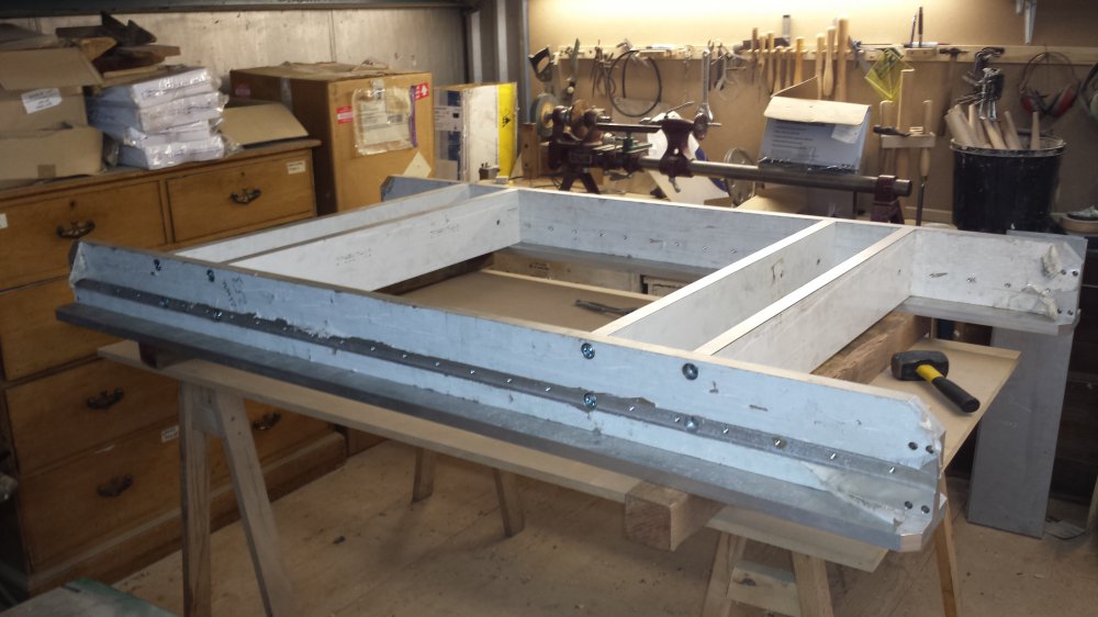

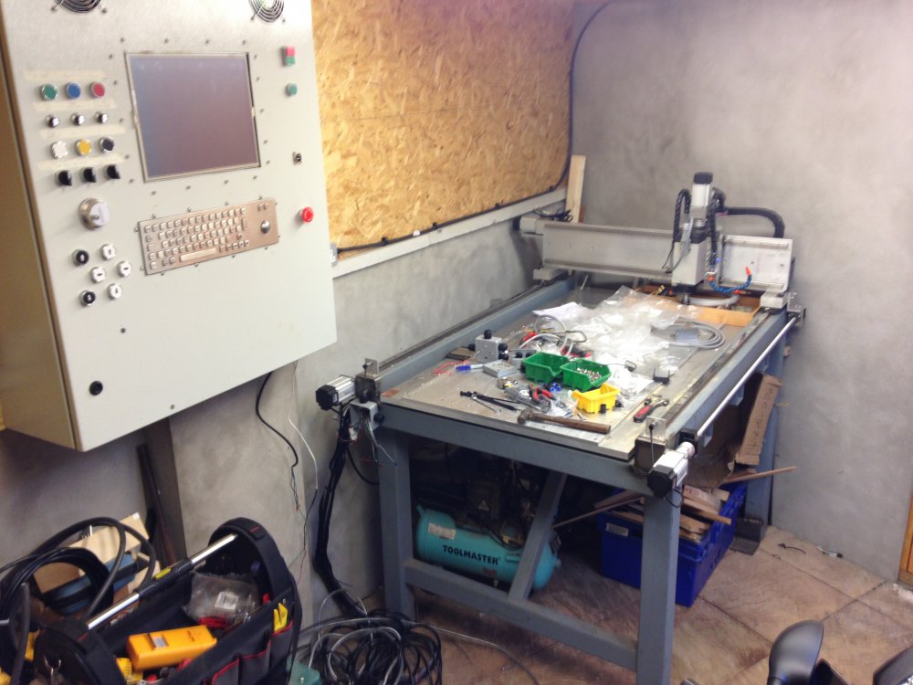

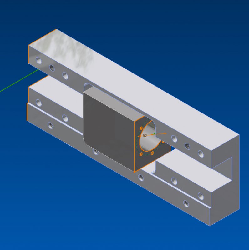

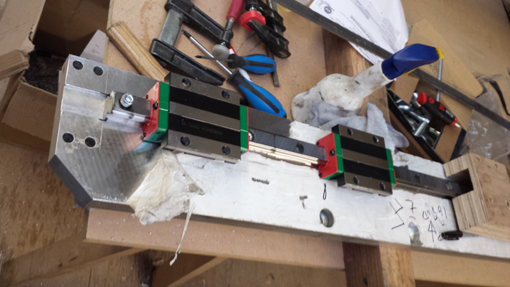

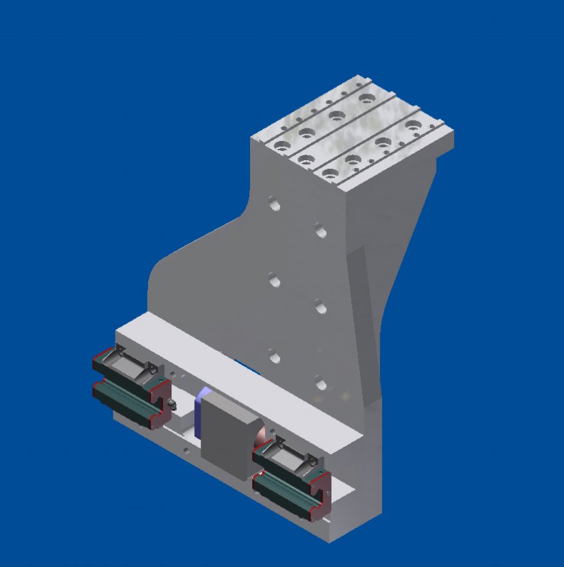

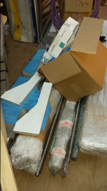

My adopted unfinished project is a 2x1m heavy, accurate CNC router that I am assembling, probably completing the design and building for a friend. The job was started probably 2 years ago, by a tame engineer friend but abandoned because of other commitments.

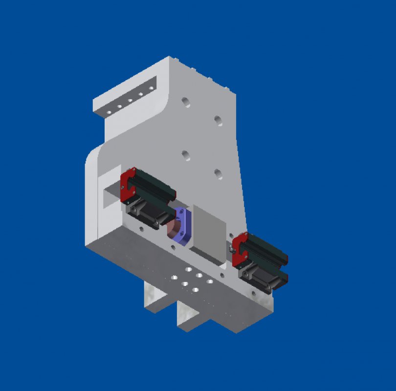

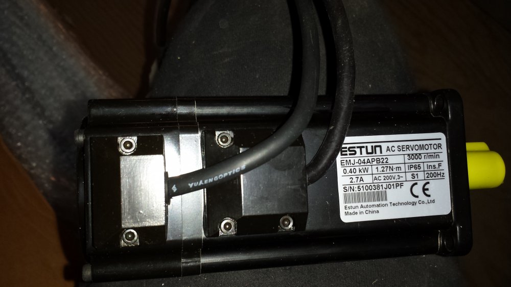

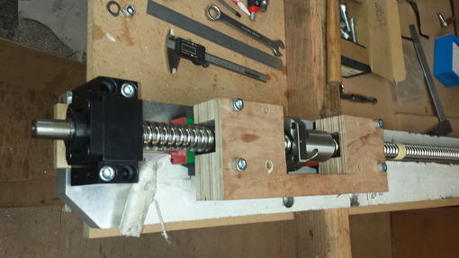

The pile of bits.... weighs a bit!... x axis ballscrews are 32mm!!! , 30mm Hiwin rails on x, 20mm for y&z, Servo motors rather than steppers all round...

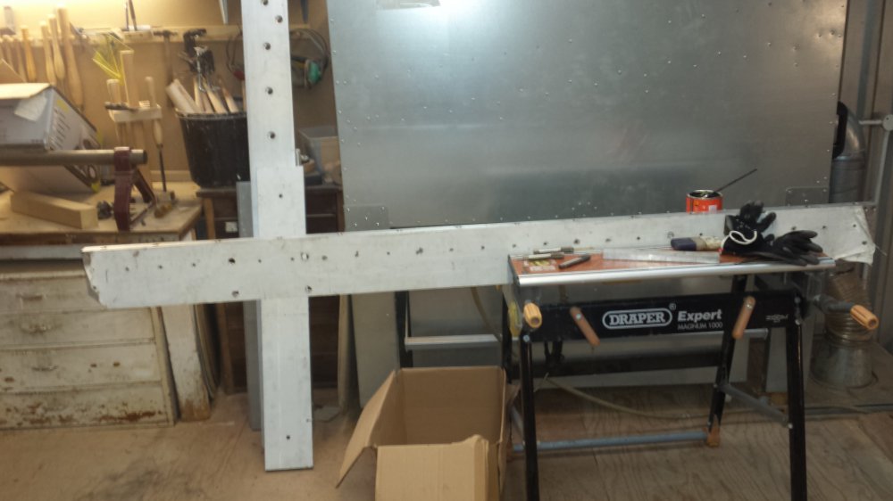

Tapping 28 M16x50 and 48m8x30 by hand because the monkeys that machines the sides "forgot"
Think it has been good for my hand as I have had to work with both hands... still a total PITA though as for most I am having to work left handed.

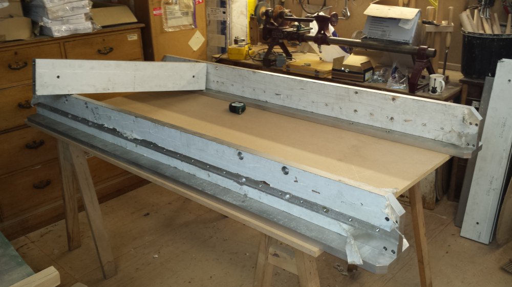

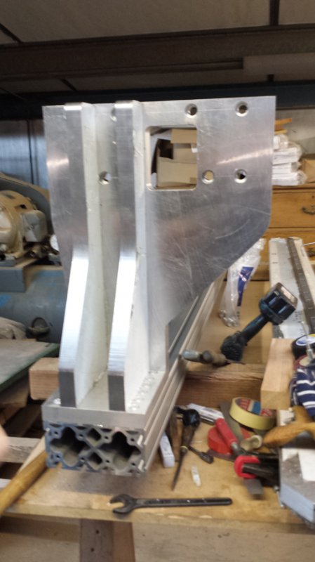

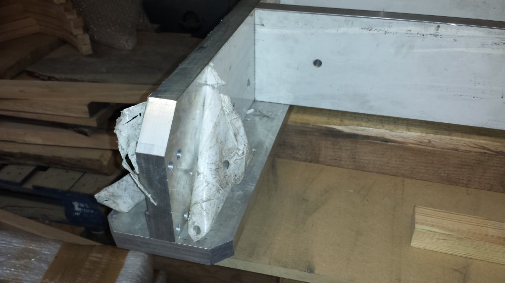

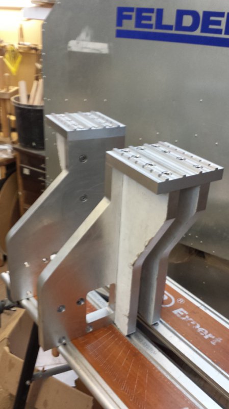

First time together..... useful as one of the cross rails has been drilled & tapped about 2mm off... could do with some suggestions as to a sensible repair, don't want to open out the holes and counterbores unless it is the only real solution

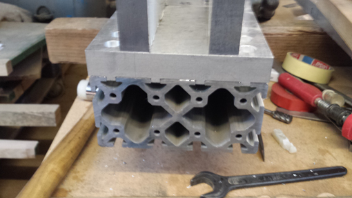

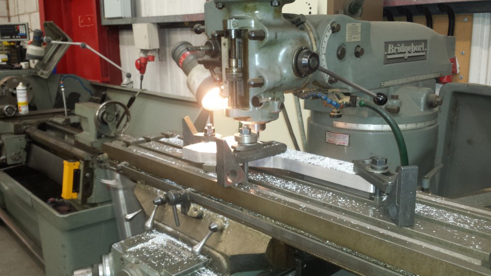

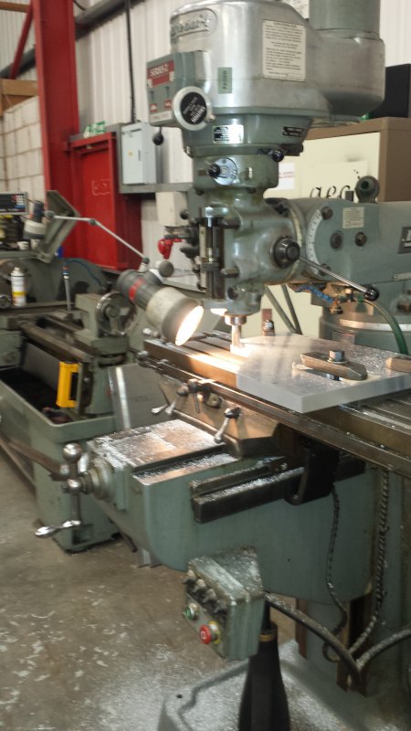

Nice chunky parts.... 160x30mm .... weighs a bit though, about 160kg on there
