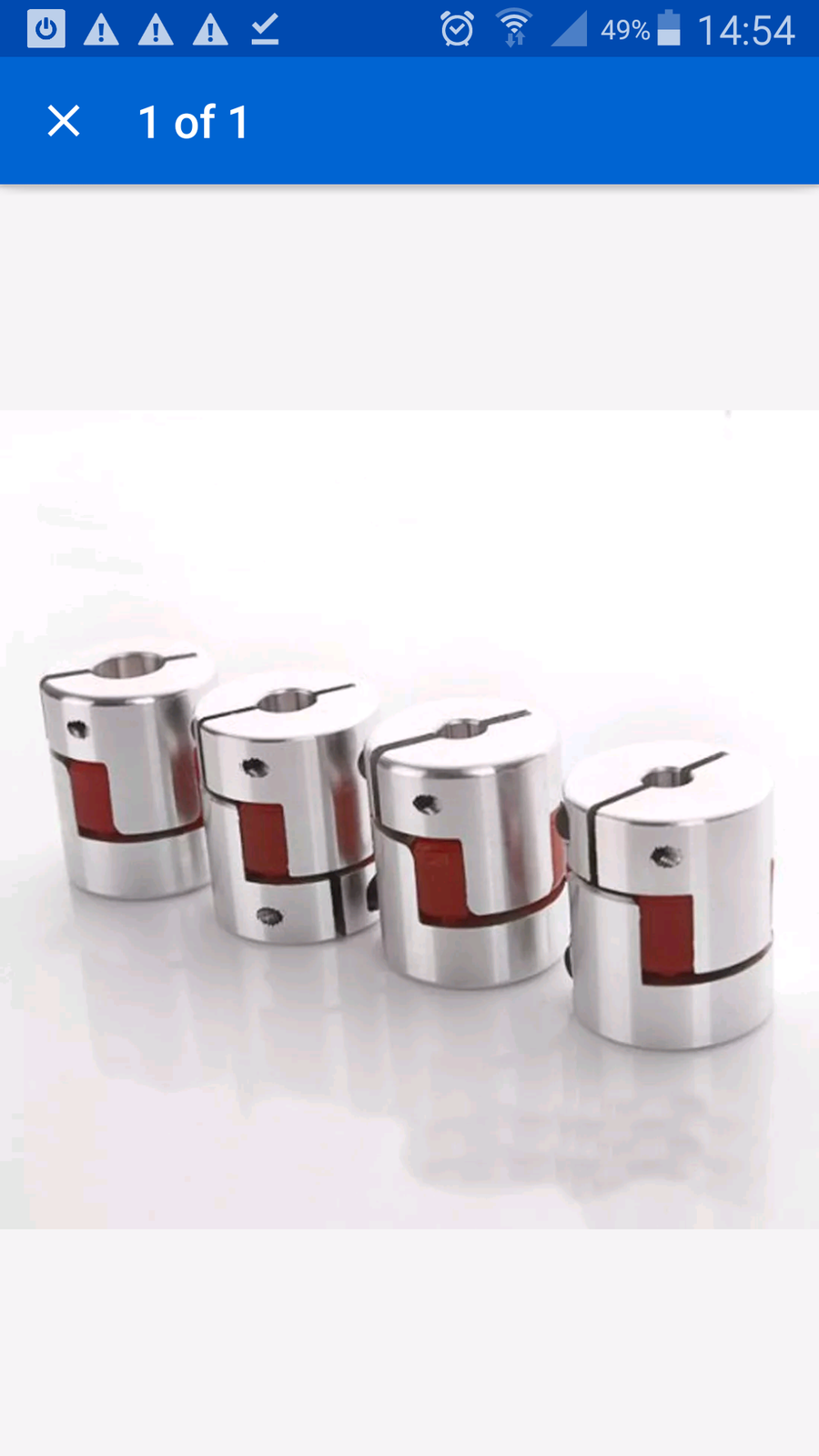

Been racking my brains trying to remember what they were called. Cheers.An Oldham coupling should do what you want and they are rigid.

Gonna go direct I think. Neater and less obstructive.
