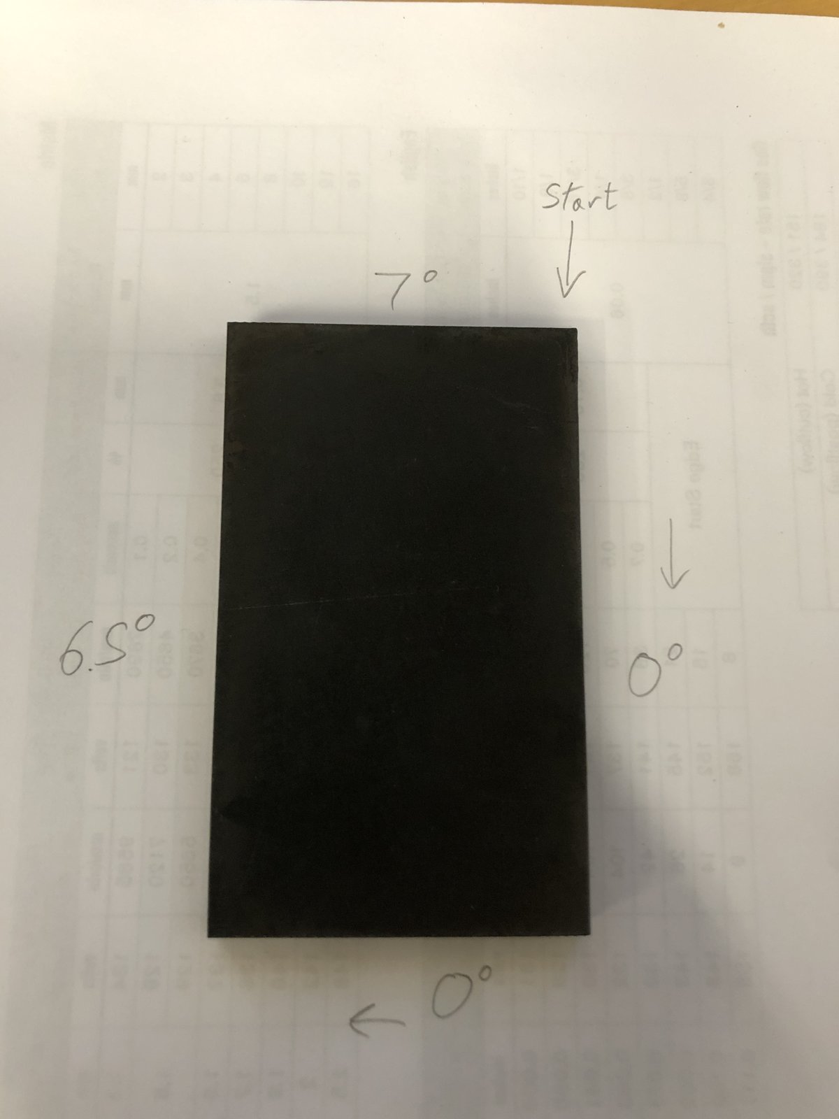

Is this maybe something to do with swirl direction? Try cutting counter clockwise and see if it changes?
Struggling to wrap my head around this.
Checked torch for alignment which is fine.
Slowed feed right down still the same.
Tried direct earthing of the stock, still the same.
Tried different consumables (Thermacut rather than HT), still the same.
I've seen mention by Jim Holt (HT guy) that the Oring on the torch can cause these issues but I don't have a spare to test with.

No, the correct direction for the consumables is clockwise on an outside cut (best angle on right of cut in relation to direction of travel).
I had actually tried it because sheetcam was setup to cut CCW until I changed it.
. seriously though)Is the rotation always the same direction? (You know where Im going with this. seriously though)
Not following.
Is the direction of cut always the same? Yes, it's now always CW.
The swirl ring only fits one way so the best cut is always CW outside ccw inside.

@MattH speak to @doubleboost as his sponsor sells tables and machines.I found a thread on another forum where someone had been having the same issue. After exhausting all options someone from HT told them to check the torch O ring which he replaced and this fixed the issue.
I’ve checked the O ring which seems ok but is completely dry. I have ordered some silicone grease.

I have an O ring kit so I’ll try to match one up but I’ll also lube the one that’s in there.
https://www.plasmaspider.com/viewtopic.php?f=4&t=22068
This thread has 3 pages of various people fixing the exact same issue with an O ring so fingers crossed.
