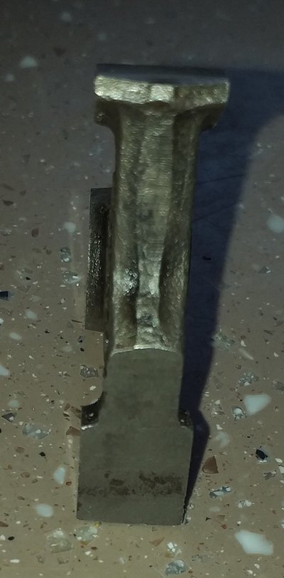

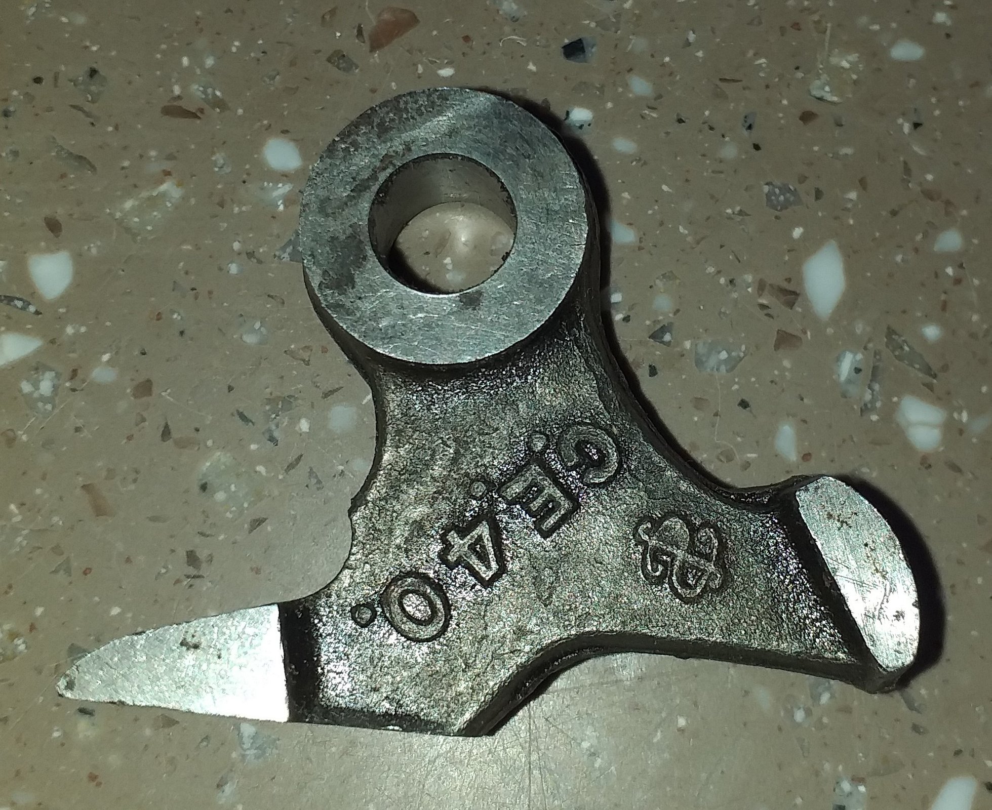

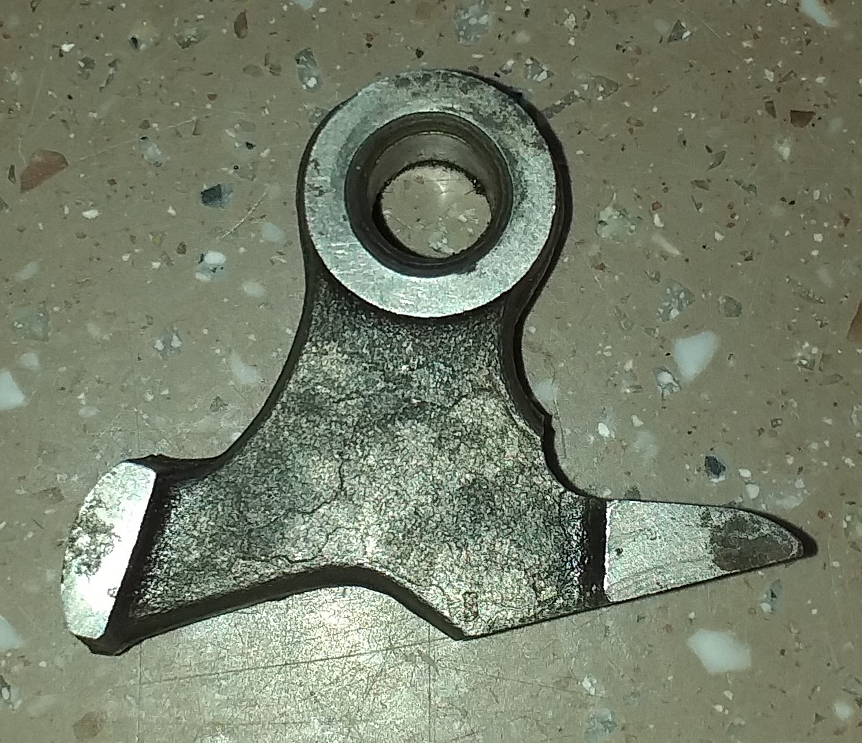

I could do with 10 of these, steel, ideally either suitable for surface hardening or a harder steel grade would work,, it is a half compression lever that lifts the exhaust tappit about 40 thou when engaged, only used when starting the engine, after that it is just the weight of the rocker rubbing on the secondary cam, 11mm or 0.435" thick, flat, 5/16" hole, can be drilled after, 1 3/4" x 1 1/2" max size, I could hand finish if laser of plasma cut, I have a sample,
It is a bit that falls out when the timing chest is removed so easily lost, went through 6 of my engines before I found one! only used 1931--1934............
