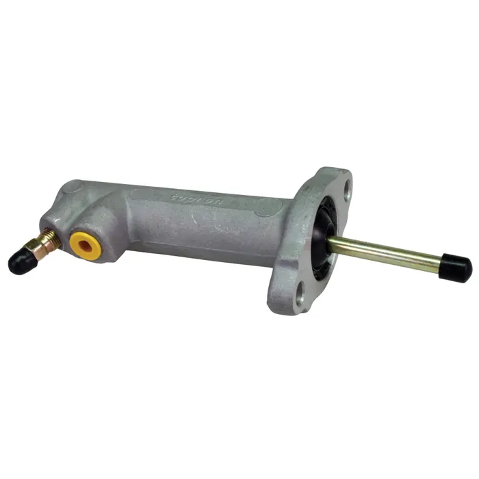

my on going clutch saga i cant seem to get a pedal , ive tried several combos of master /slave , new hose
so i took all the parts in the shed and screwed them to a plank of wood same orientation as on the car , bled it by pushing the rod and cracking the nipple while the slave was clamped to stop movement , in no time i got the master rock hard like i expected , left it overnight still hard , no leaks
fit these very same parts to the car and ive tried pressure bleeding and reverse bleeding with a new oil can , after hours best ive got is it just works and crunches into gear
what on earth is going wrong...if it wasnt spongey on the bench test then that confirms its all good right?
