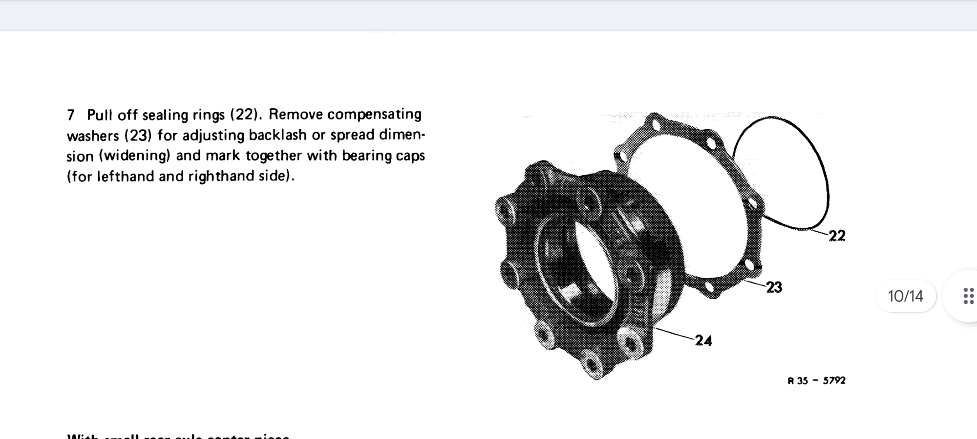

I've had a long-standing clunk from the diff on my 450sl when going on and off of power. It probably needs rebuilt but I've got zero experience of diffs and the clutches for it's LSD are NLA.
Anyway there seems to be a lot of movement between the propshaft and the diff.
Any thoughts on this?
About half of the movement takes place before any movement in the drive shafts.
