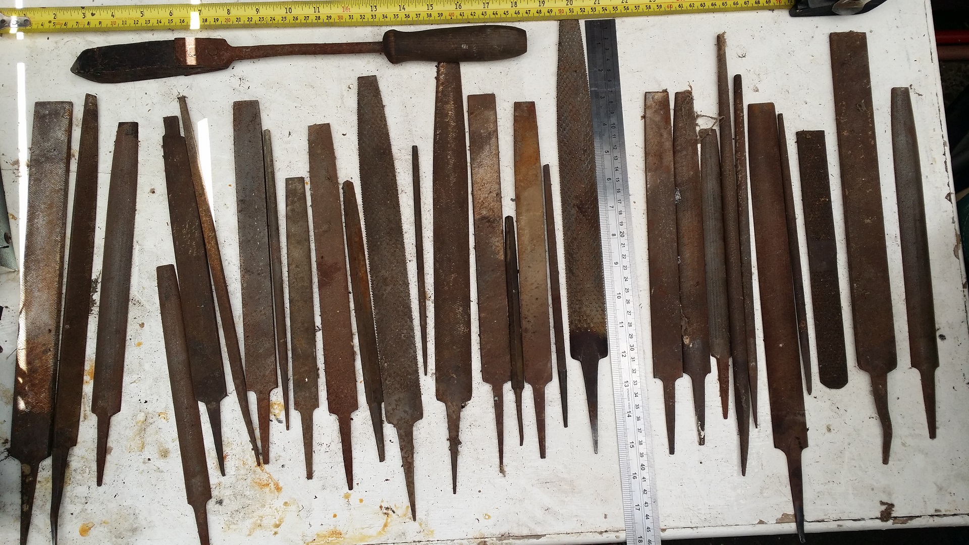

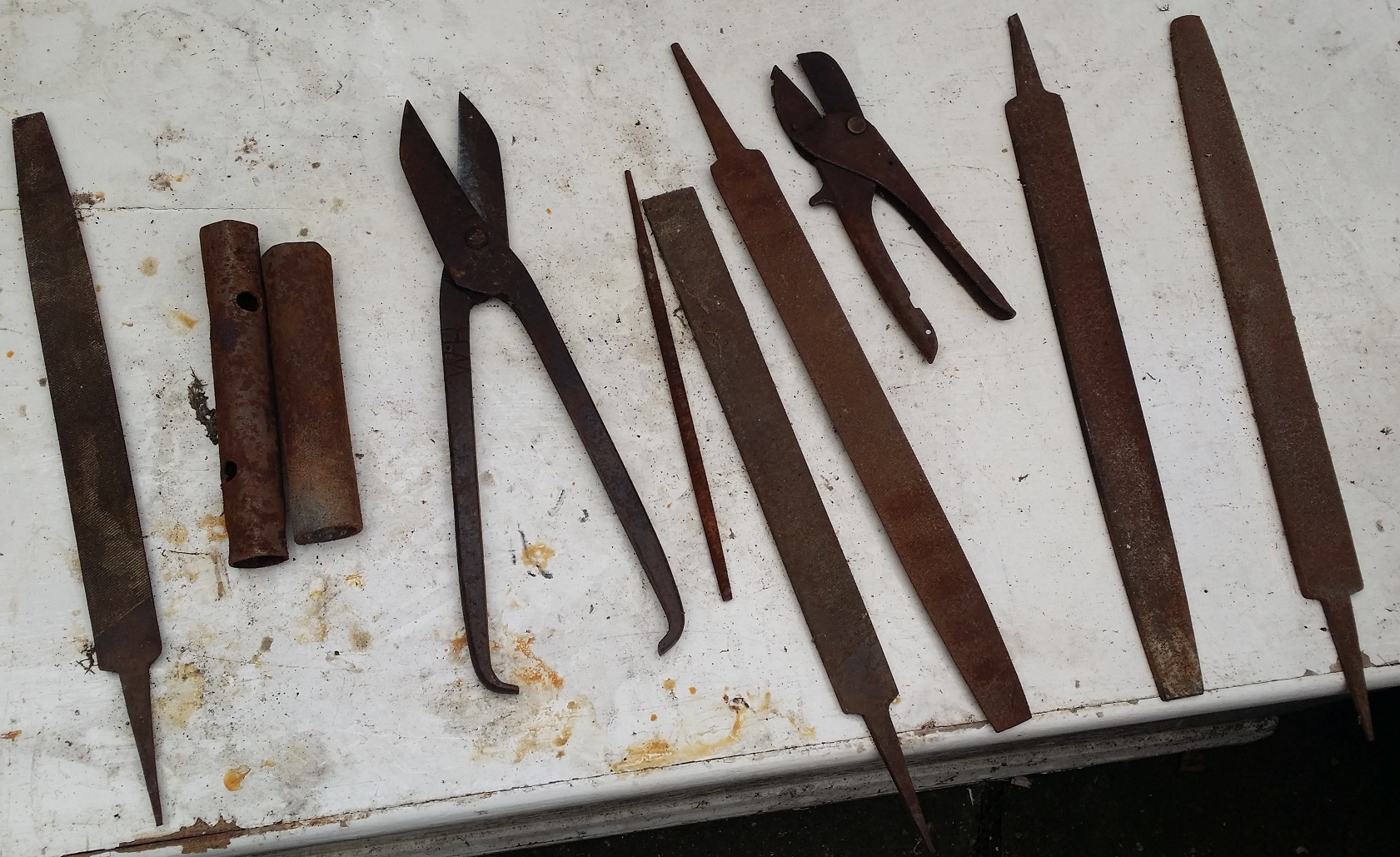

Golf balls drilled three quarters the way through make great file handles, but not the ones with a liquid center, so be careful to use eye protection when drilling. Use a smaller size drill than the tang for a good friction grip. Try it, I'm confident you'll like it.
a guy stood next to me and said he wanted some so I gave him a couple of handfuls free . I didn't have the heart to charge him
