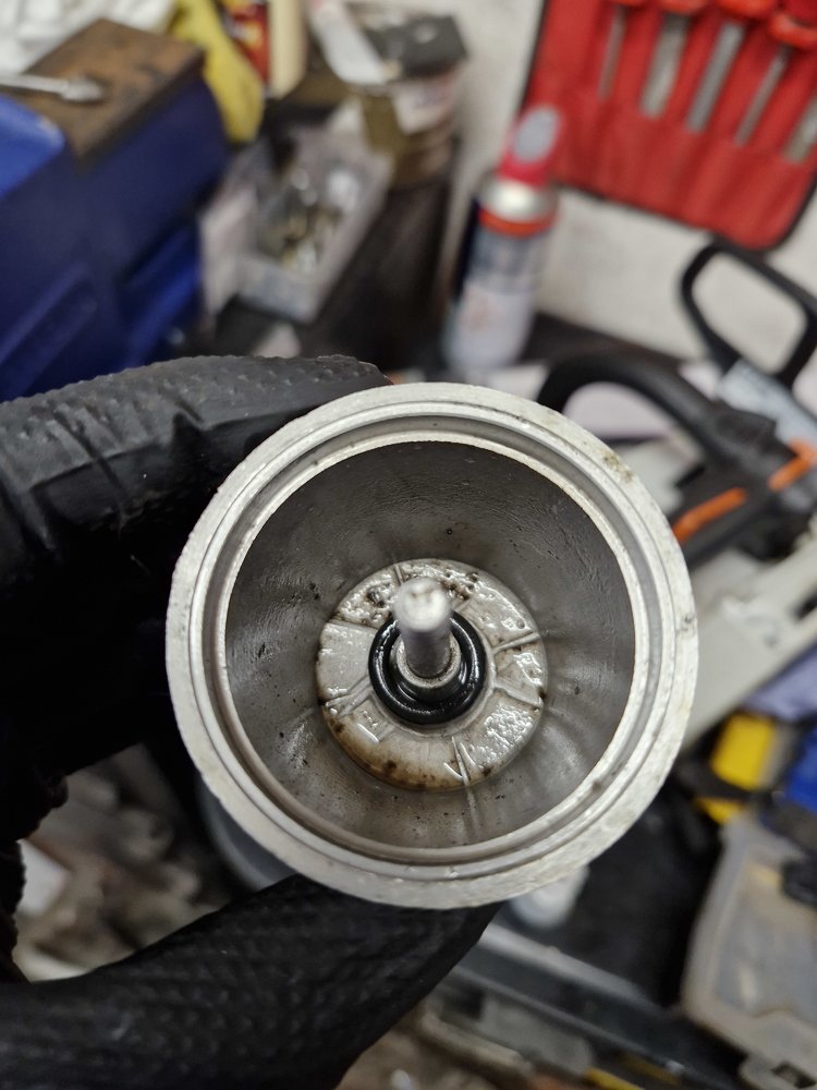

Strange one today. My condensing oil boiler (radiators only) wasn't running properly earlier. No heat and it was constantly firing for a few seconds and going again but not tripping out. The motor and pump were also hot to the touch.
First thing I checked was the oil line and a fuel sample. Immediately I could see a load of rust / dirt / junk coming through the oil line.
WTF, I just replaced the oil tank filter with a new one last winter.

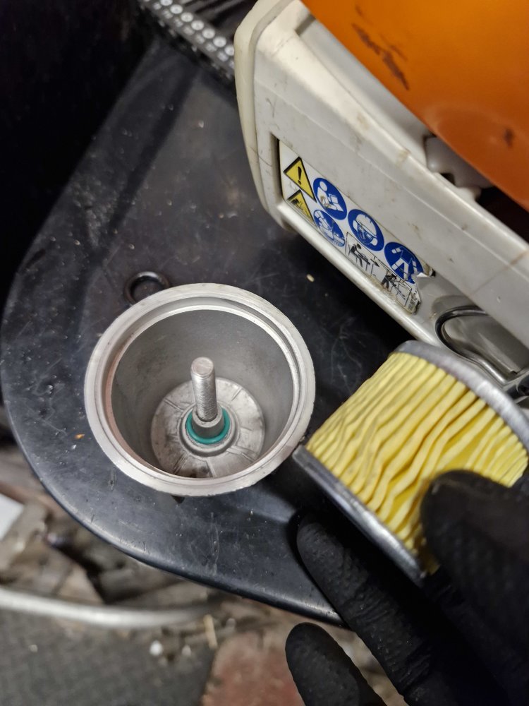

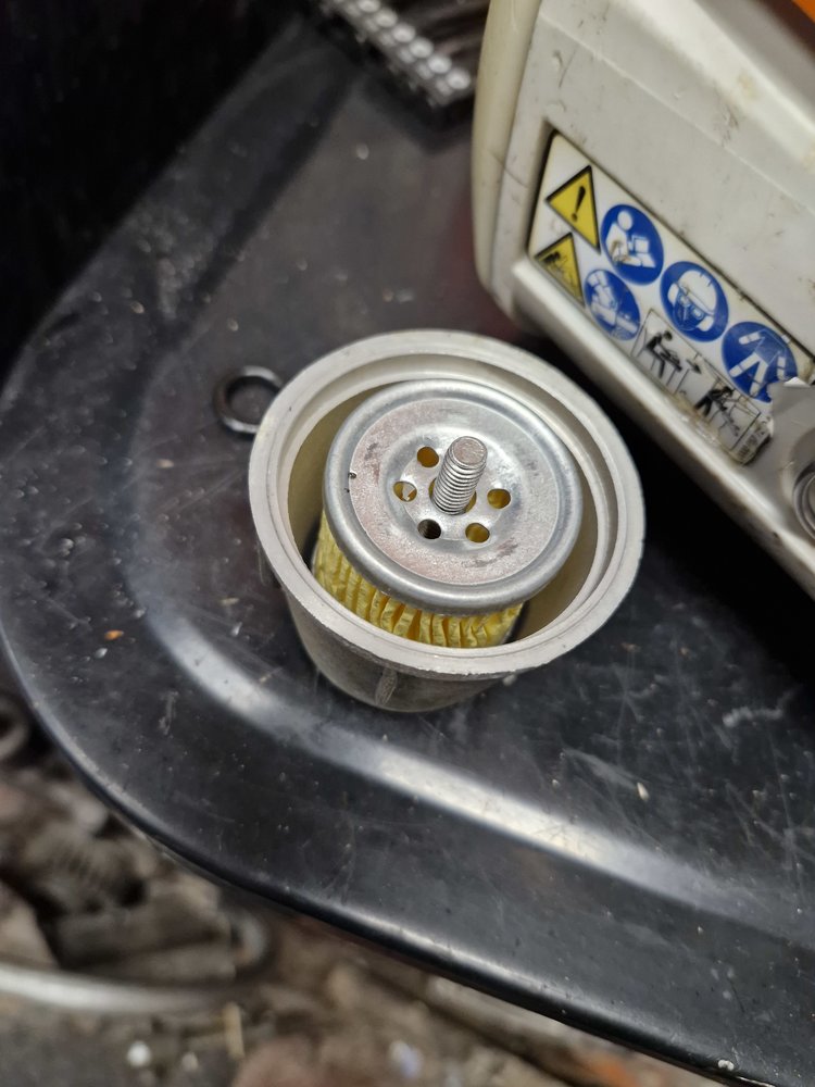

Here was the problem. Large bad fitting o ring and metal filter were letting the junk through.
I keep a number of spare parts and that included a paper filter element and new o rings which fit properly.
I fitted that new paper filter and drained another large sample which ran clear this time.

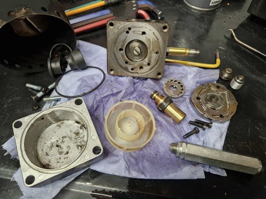

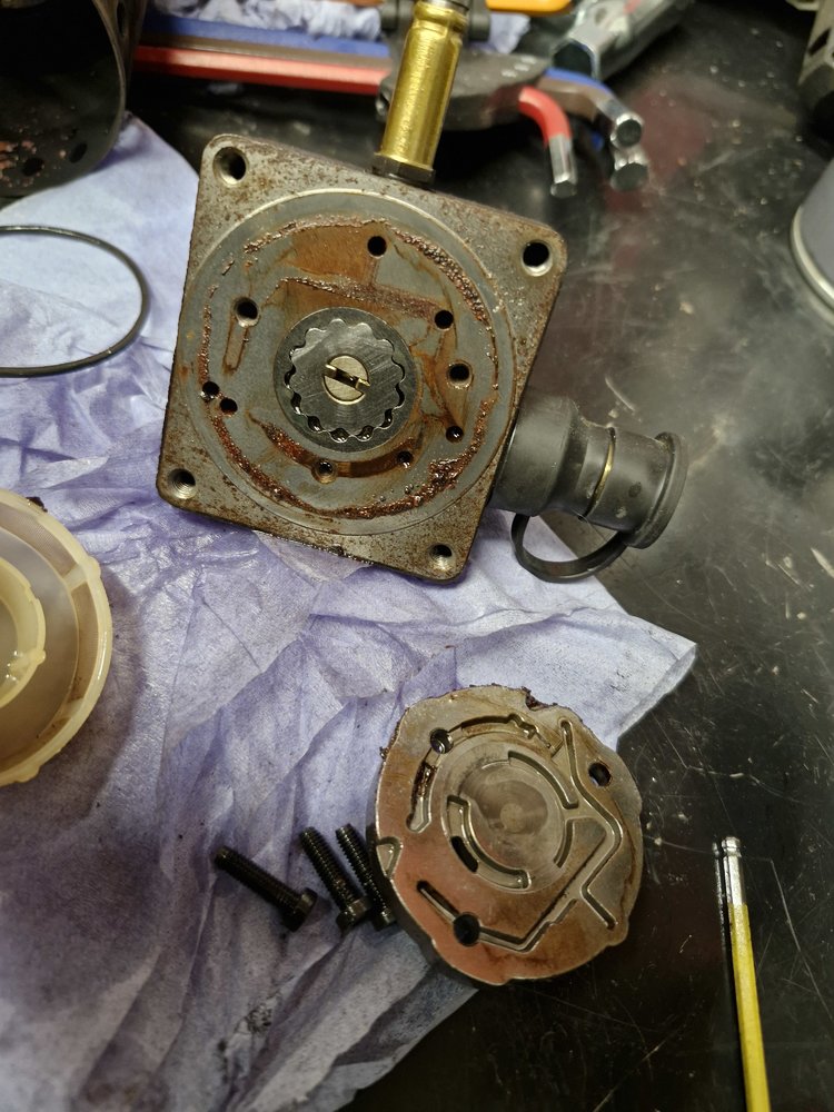

But the oil pump has injested alot of carp here.

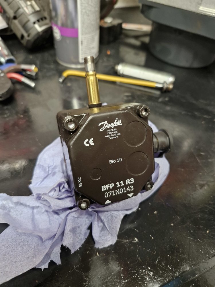

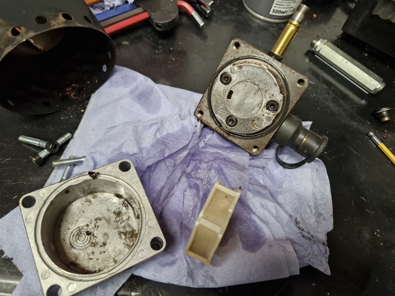

Does anyone know is it possible to take the cover off and clean inside these pumps? Or is that a bad idea taking the cover off? Taking all ports off I can't see a mesh filter in there. Maybe the pump is scrap too I guess.
Incidentally this morning I checked FB marketplace and someone 10 mile away was selling a 2 month old identical Elco burner to this and for good £ so I went and got it. Heat running again but the idea is I want to repair and test this one. Then fit 2x new danfoss jets and set both of them myself with my gas analyser and set one aside as a good working spare. 5 mins top to swap the burners out its very easy in these. One electrical plug, one 8mm nut and one fuel line.

...not too bad if your setting burners every day, but not economic if only used once a year after fitting a new nozzle. Presumably you've got a non-lockout model?
