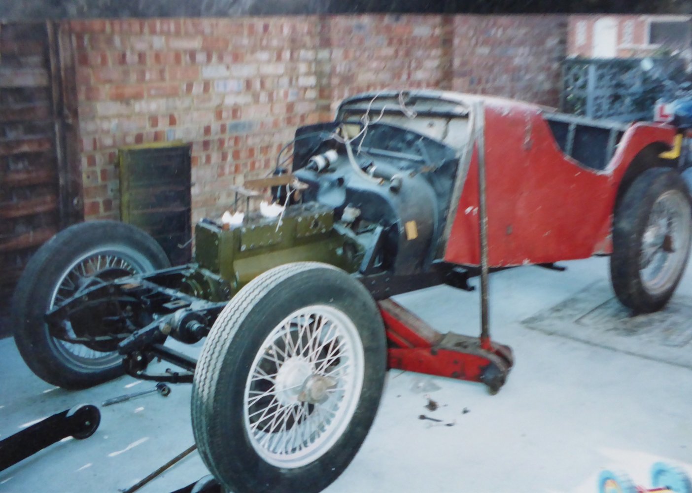

Sporting the same aftermarket indicators as my Morris!1934 Wolesley Hornet Special
Hi RWD3M,Sporting the same aftermarket indicators as my Morris!
Is this picture current? I wondered how far from completion the car is.

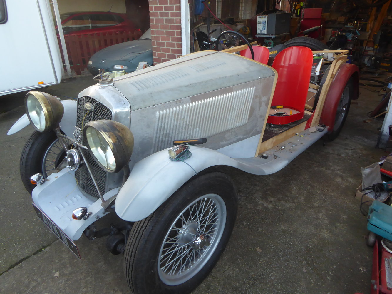

RonASporting the same aftermarket indicators as my Morris!
As I’ve restored the Hornet I’ve tried to incorporate modern features (which don’t show, so as not to deviate from originality) to make it more drivable & safer under today’s modern driving conditions. The car originally had leather oil seals on the back axle which allowed oil to seep onto the brake shoes (not good) these have now replaced with modern spring loaded seals. The headlights have much brighter Halogen bulbs & the engine has a modern spin off oil filter mod. As you noticed the car is also sporting after market indicators but the sidelights also have dual sidelight/indicator bulbs(repeaters?)
