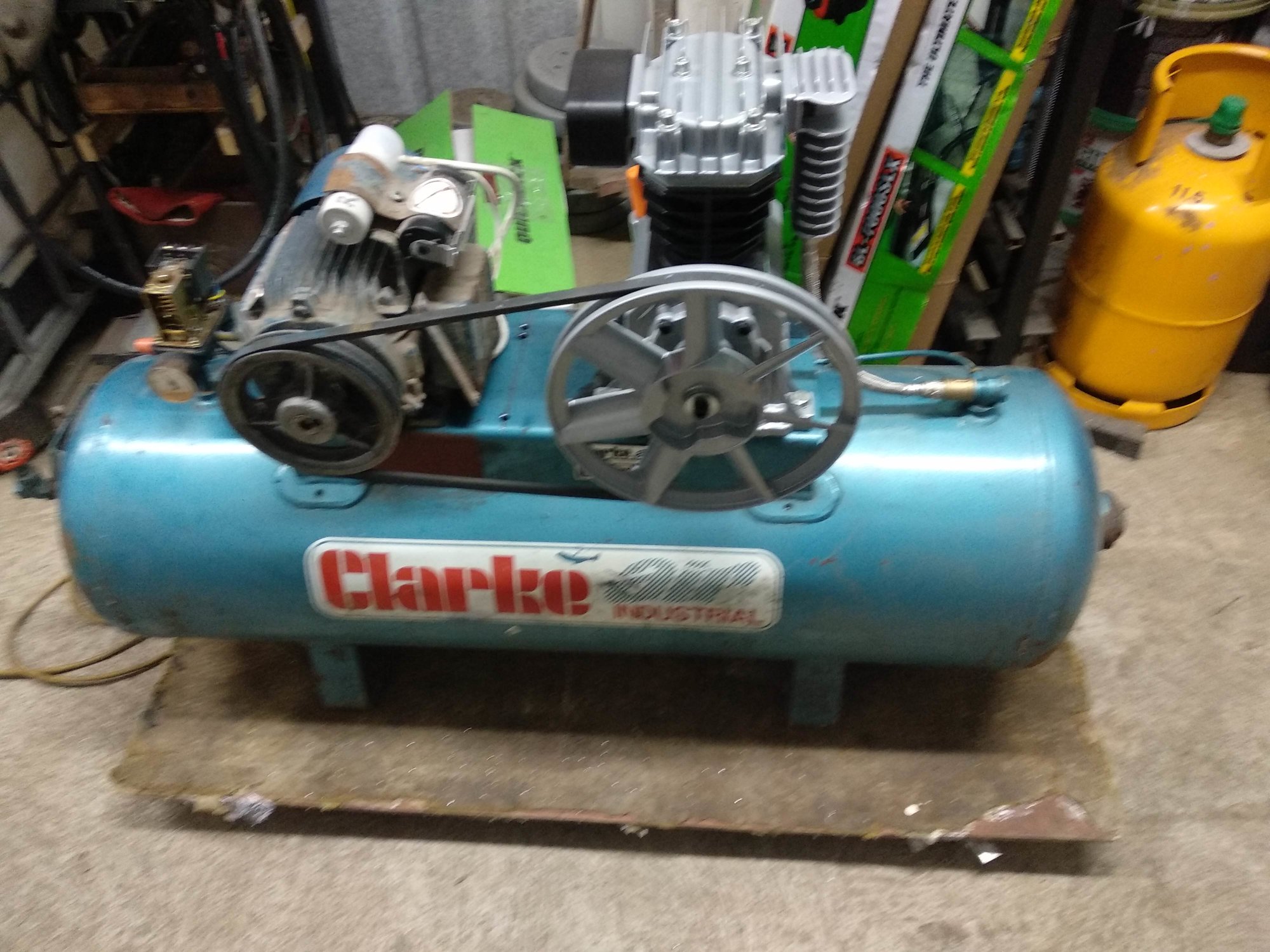

    Having read through @gasket999 Clarke compressor rebuild guide I want to share my own endeavours with my Clarke SE10C110 rebuild that I picked up for the princely sum of €50. IMG_20201119_150225.jpg

    The motor is completely seized, stator is rusted to the coils, it is beyond repair and not even worth posting a picture of.
  3. 3000alloy
    3000alloy Member
    Messages:
    108
    Location:
    Ireland
    I have my own motor, the compressor came with a 2hp Moto from the factory. The motor I have is 1.5hp, will it do the job? I have no idea but I am running with this for now.

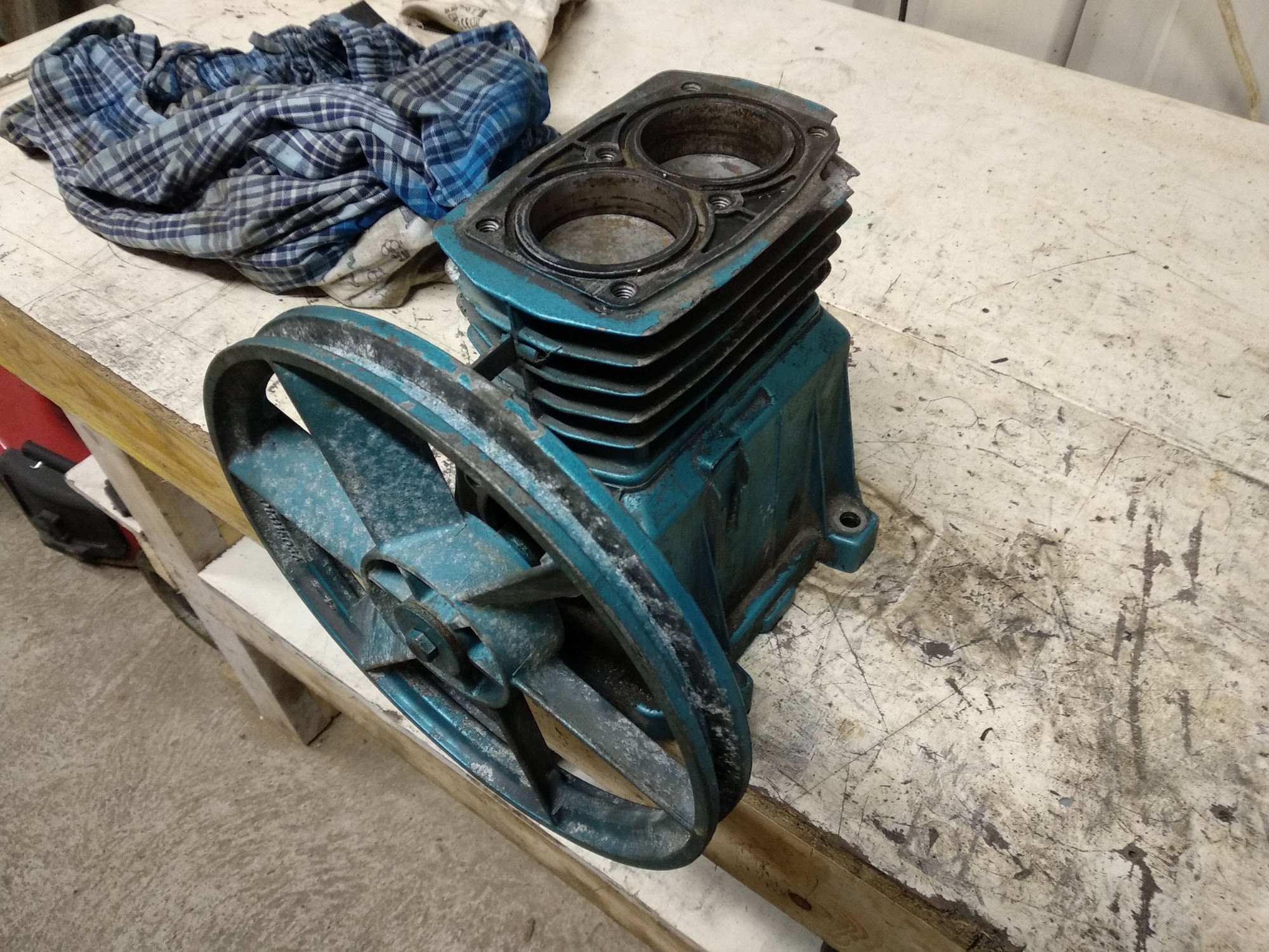

    As regards the pump, it didn't look in great shape initially. However, upon inspection there maybe life left in it.
    The head and filter are missing. The pistons where a bit rusty but a quick clean with wd40 shows them to be in good nick and the rings are also fine. IMG_20201119_150306.jpg
    I have sourced the parts diagram for both the pump and the compressor from Machine Mart. I rang Clarke's and they pointed me towards Machine Mart.

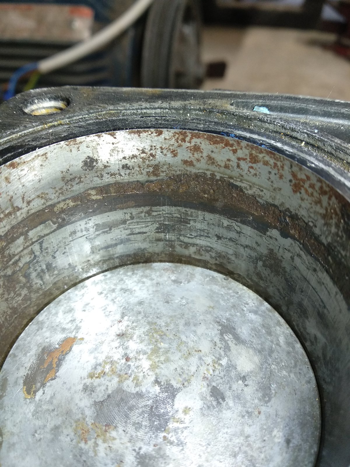

    Perhaps some honing will address this? The suction is good, as I have put my hand on the cylinder and rotated the pump crank, with a disposable glove on my hand, my hand is getting sucked into the cylinder.

    Those bores don't look very pretty, I see some very deep pitting in the closeup photo.
    daleyd and 3000alloy like this.
  8. daleyd
    daleyd Member
    Messages:
    7,105
    Location:
    Wrexham, North Wales
    Hopefully the deep pitting is over the top of the high mark - looks like it might be but hard to see from pic
    Wallace likes this.
  9. 3000alloy
    3000alloy Member
    Messages:
    108
    Location:
    Ireland
    I think they might be but i need to look at that.

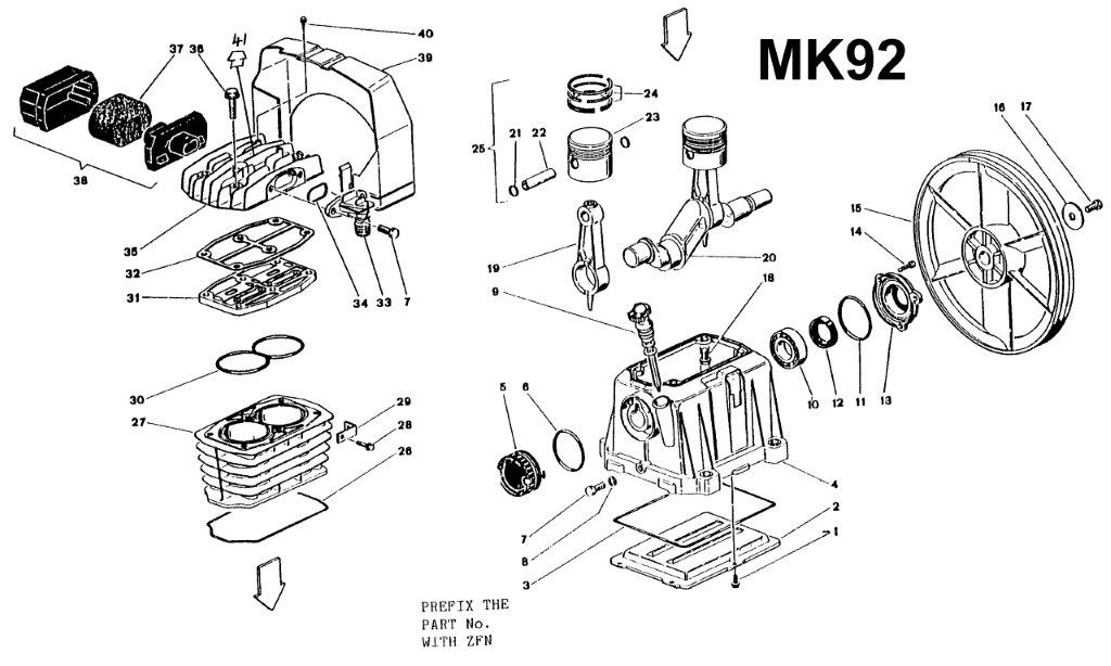

    Does a replacement head include the valve plate?
  11. 3000alloy
    3000alloy Member
    Messages:
    108
    Location:
    Ireland
  12. Wallace
    Wallace Member
    Messages:
    7,525
    Location:
    Staines, Middlesex, England.
    No.31 is the valve plate, do you have that or include it in the Machine Mart inquiry?
