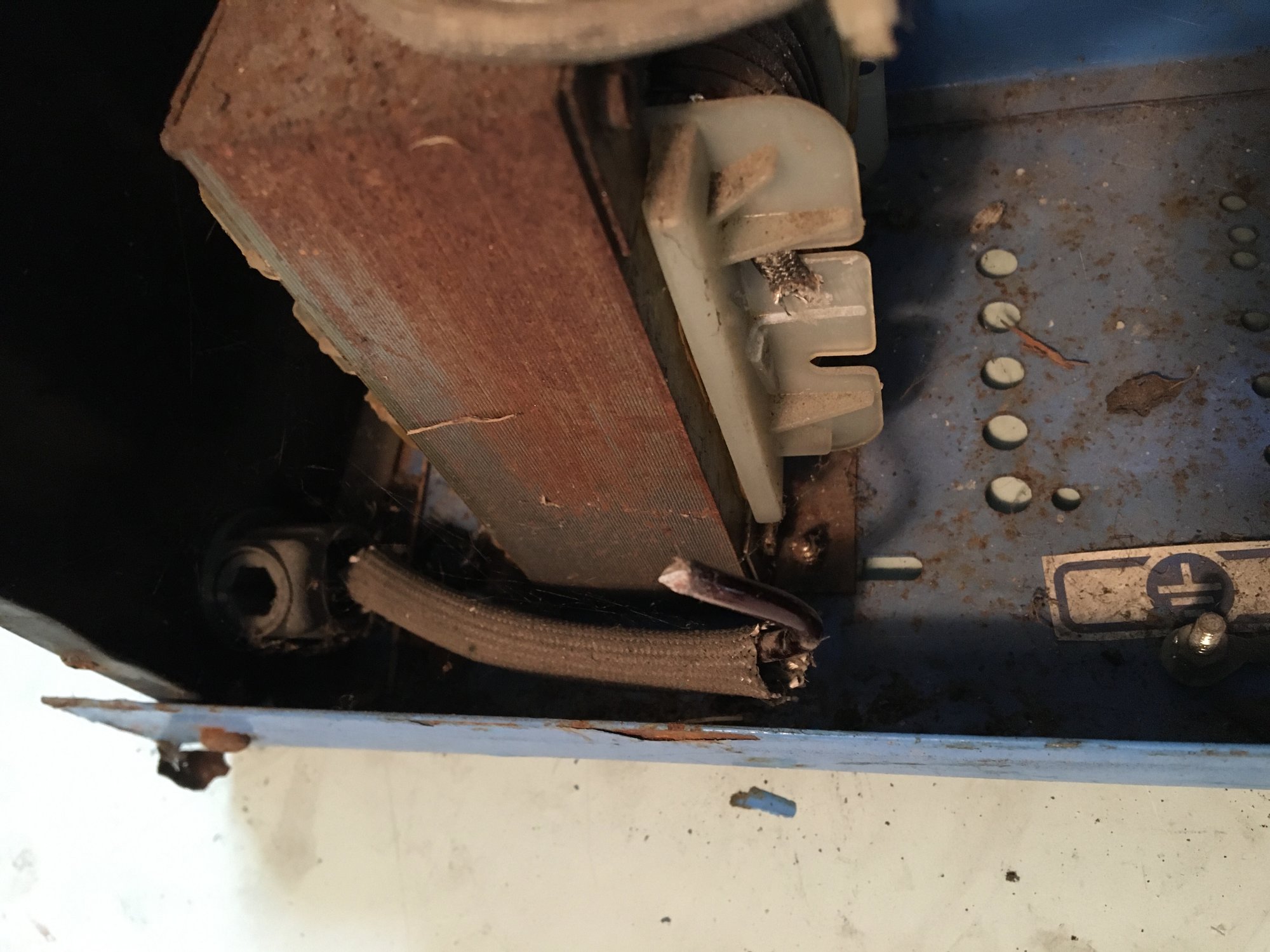

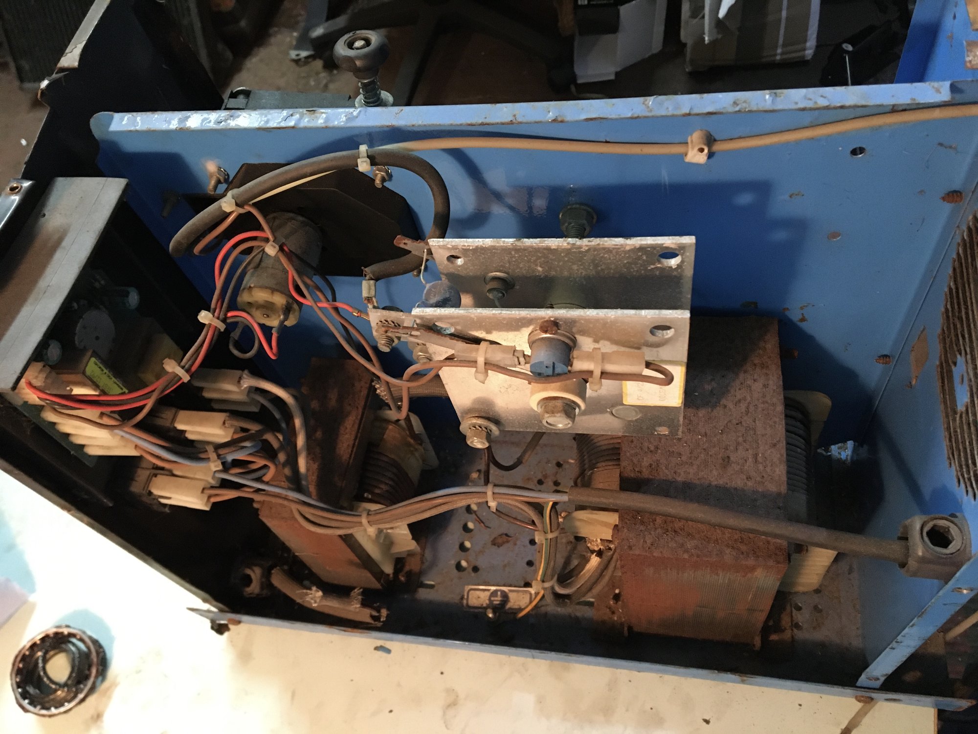

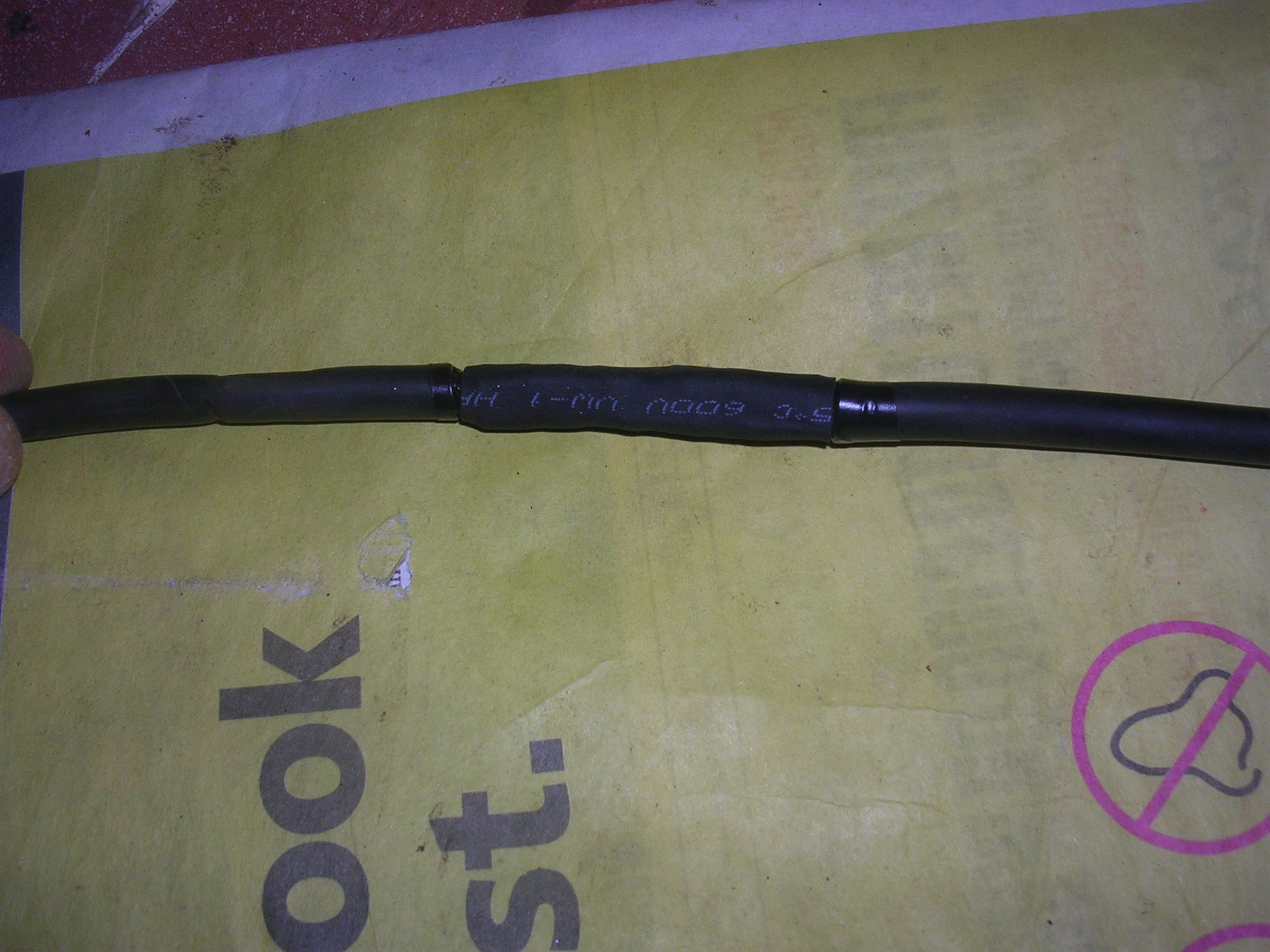

The donor Sealey's work return lead had been snipped short. I didn't want to mess with the crimped joint to the centre tap, so I joined the extra cable using a ghetto copper crimp.
Cut, bashed and tweaked from some scrap 10 mm microbore pipe. Taped then heat shrunk.
