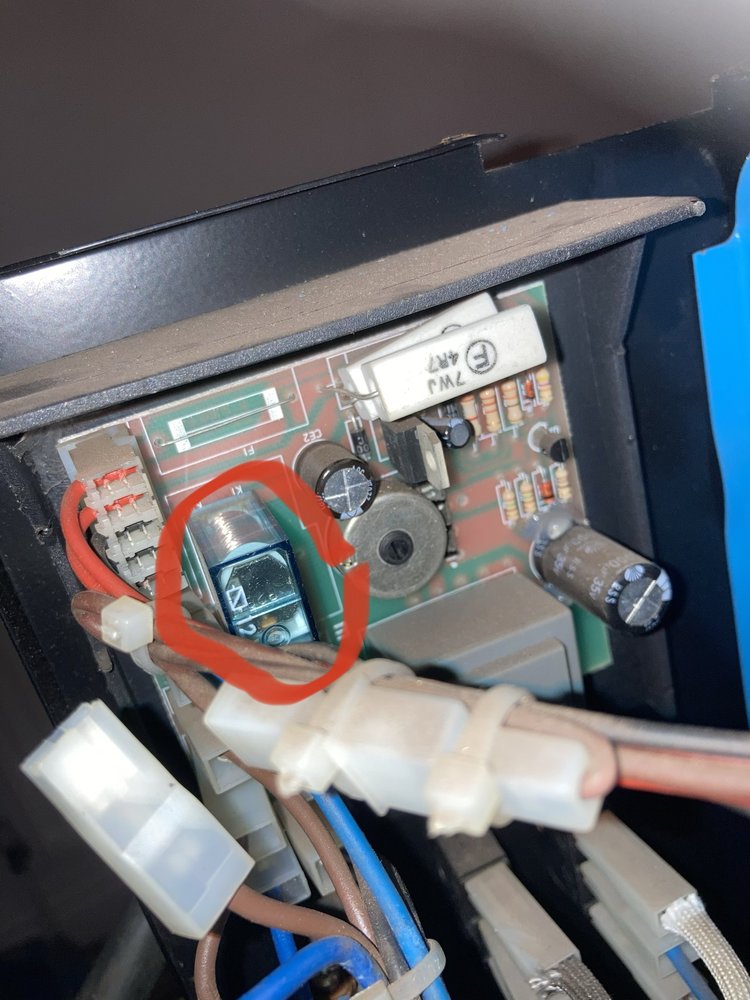

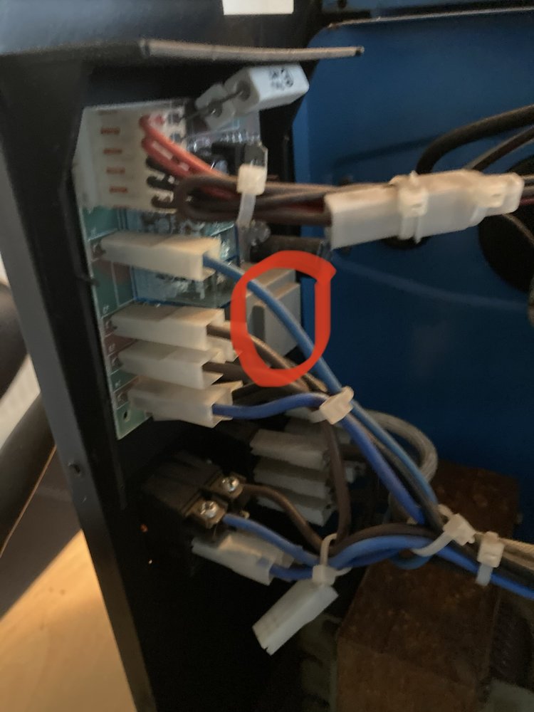

No, but the torch lead needs to be in - pulling the trigger should operate the relay to put power to the two current/voltage selector switches. It'll come from the bit on the board with the copper coil in it, might not be particularly audible, and you may see a part inside that moveNo click. Do I need to connect the earth clamp ?
