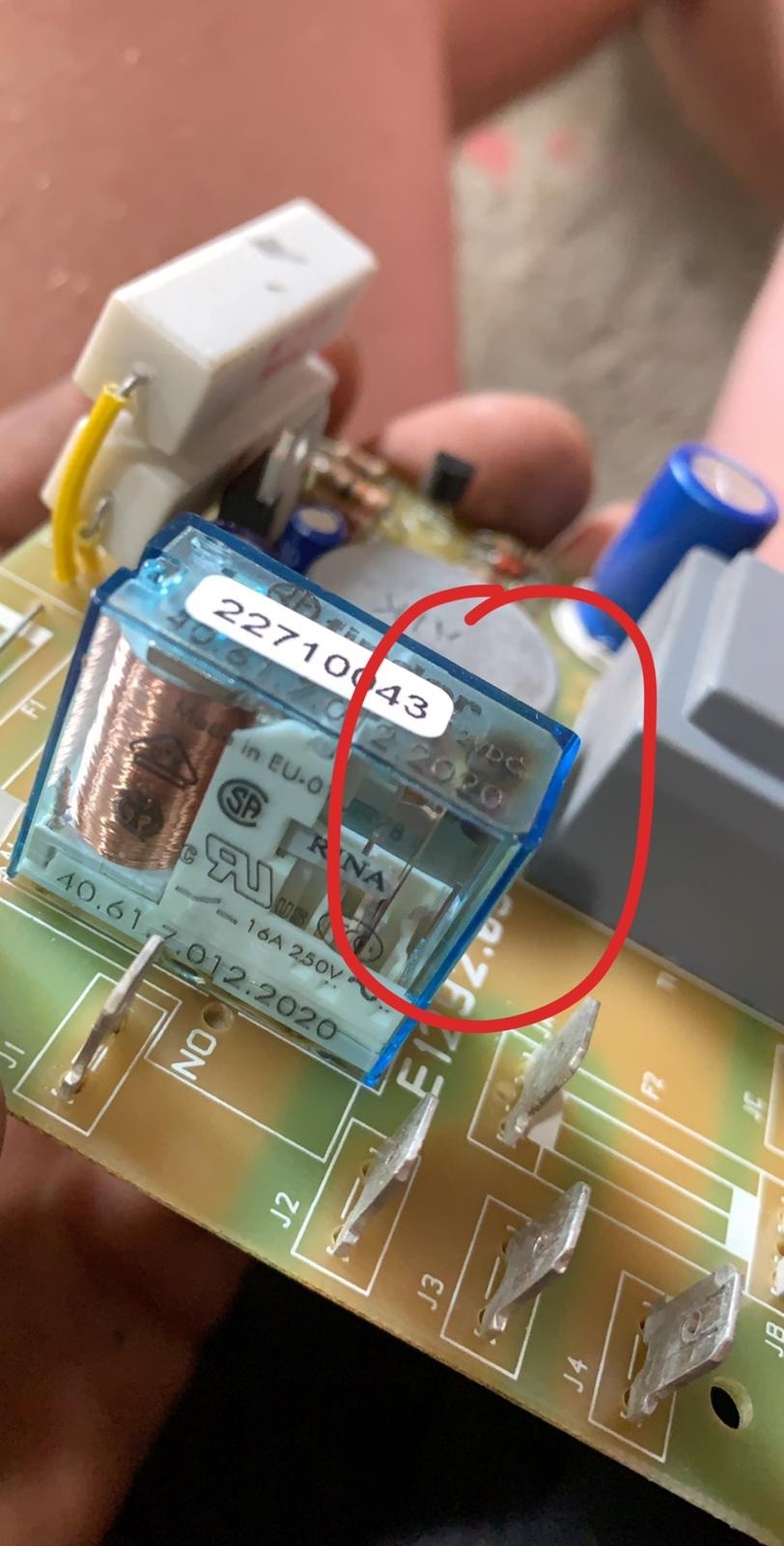

Can any one identify what this component is please.
If this is burnt out is it likely to be a solitary problem? Or a chain of OH MY God thats had it??
Cant see anything else that looks scorched.
Where might I purchase one from? Hope you can assist. Steve
That is the relay that provides power to the transformer when you pull the trigger. Likely to be the culprit if nothing is happening. What model is it?
My BiL replaced one for one of his friends. It blew quickly. Replaced again. Turned out the boy was using rusty wire, the rust was being left in the liner and making the machine work harder to feed the wire through. After replacing the liner and getting new wire, the machine never blew another.
