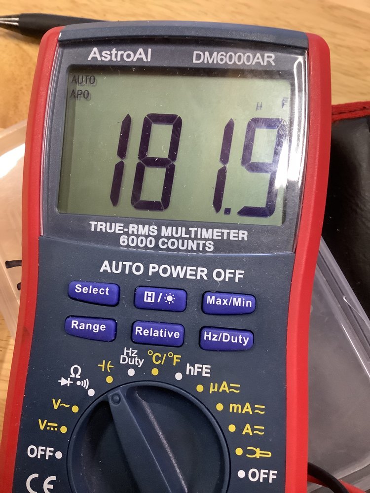

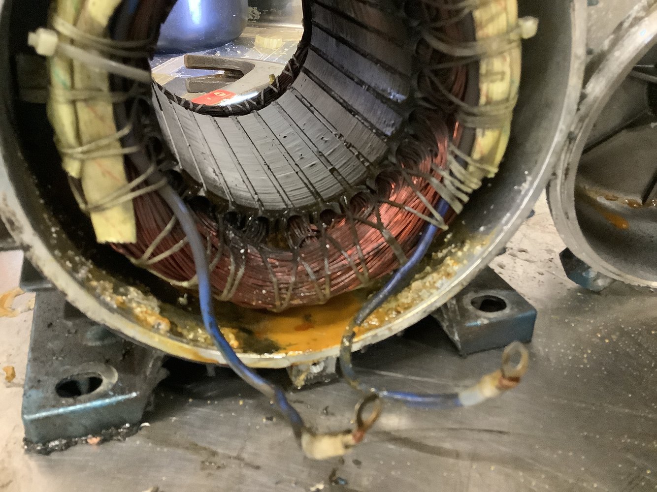

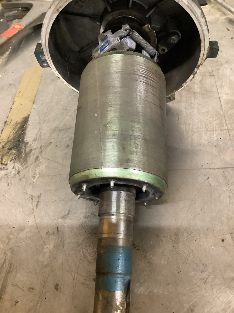

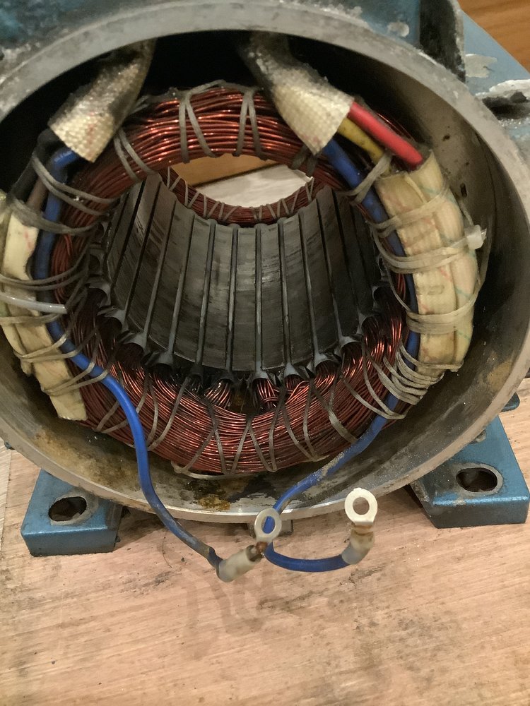

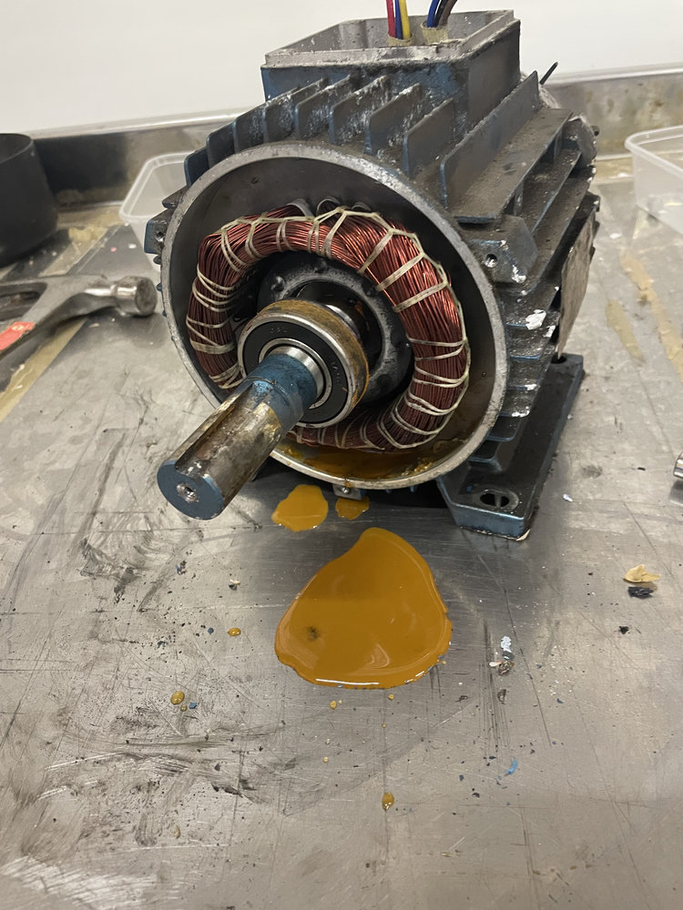

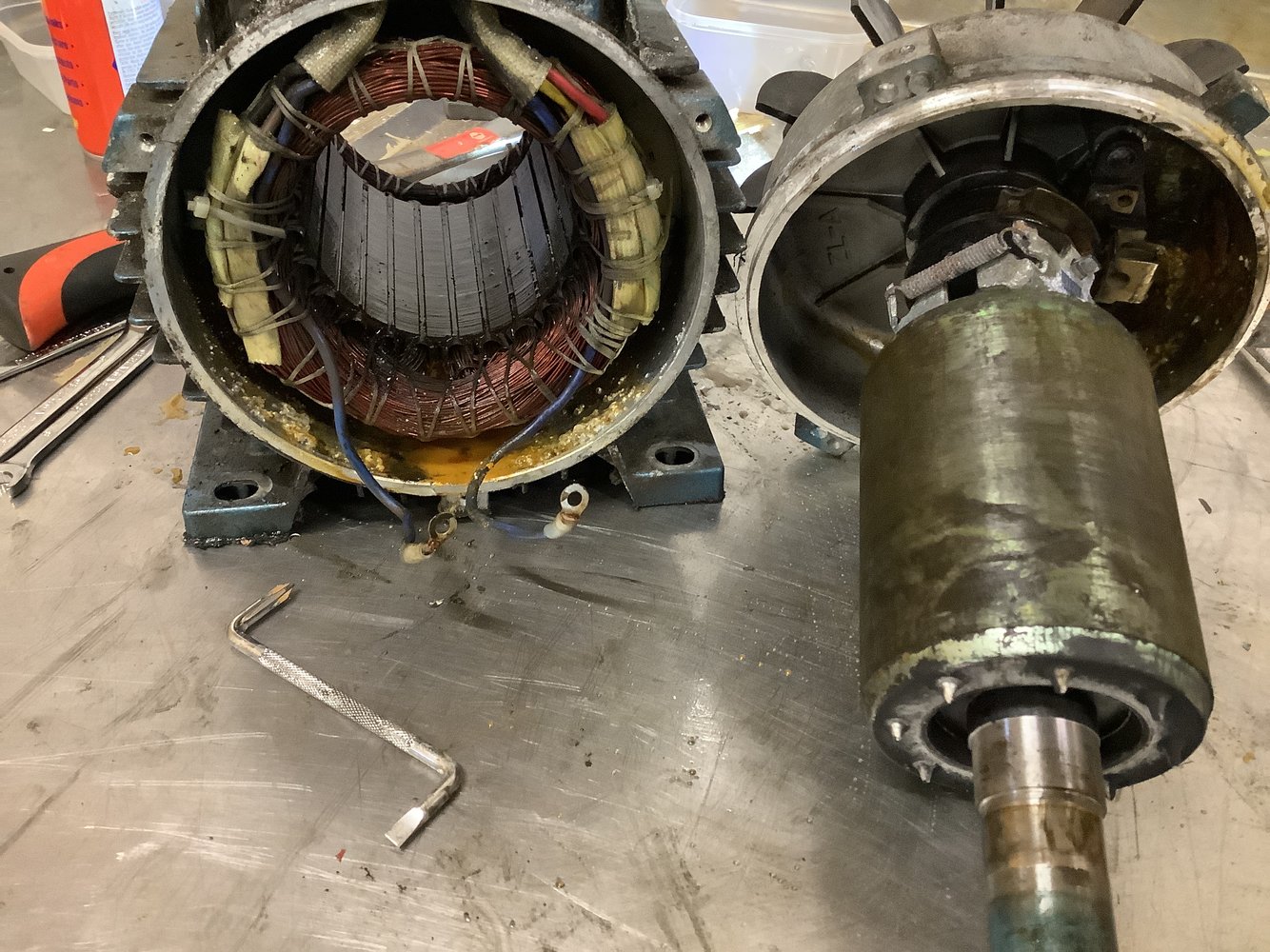

I picked up a couple of second hand Clarke compressors at the weekend, one had a known problem, it wouldn’t start, it came with another motor which works but has noisy bearings which I’ll replace.

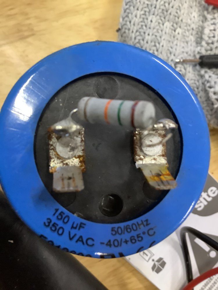

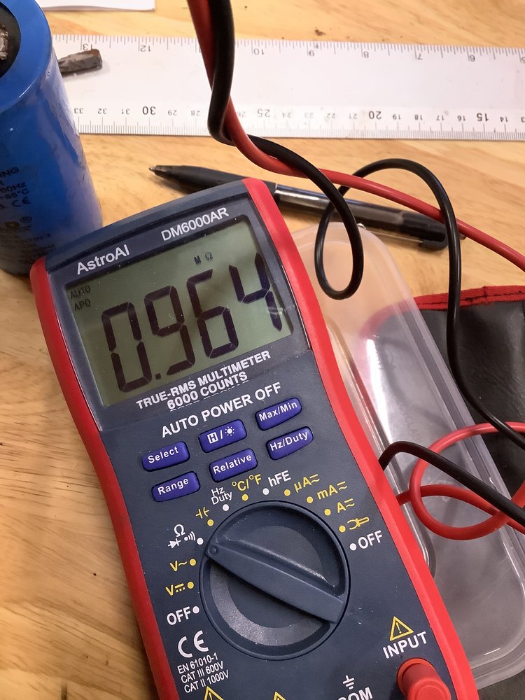

I removed the start capacitor on the non starting motor and de soldered the diode (I think that’s what it is) the capacitor is showing over 180 microfarads, it’s supposed to be 150.
Presumably an excess of 30 microfarads could be the cause of the starting issue? I know that if it’s under it would cause a problem, the capacitor doesn’t give a range on it ie plus or minus
