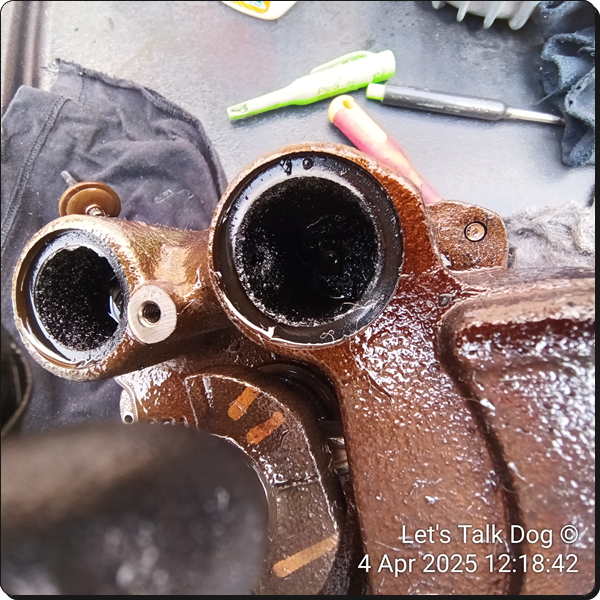

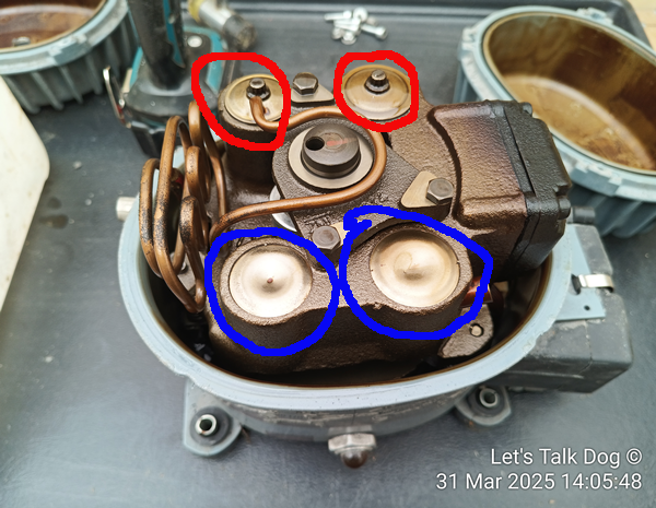

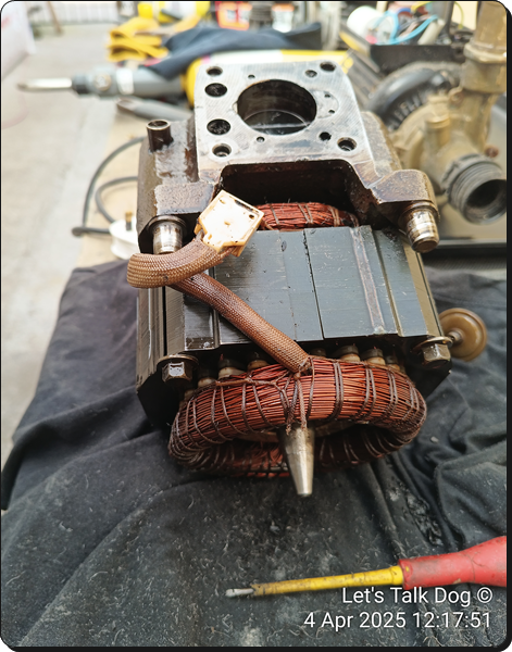

The domes are just part of the manifold.So the big, dismount secret for the style of compressor head (Type 50).
Disconnect the power cable, the outlet pipe and lift the unit. It simply sits on the 4 spring, no levers or twisting to do, just lift the unit and it comes straight out!
1/4 12 point socket, perfect fit, big thanks to @northwest.

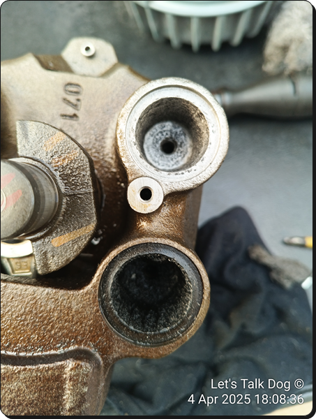

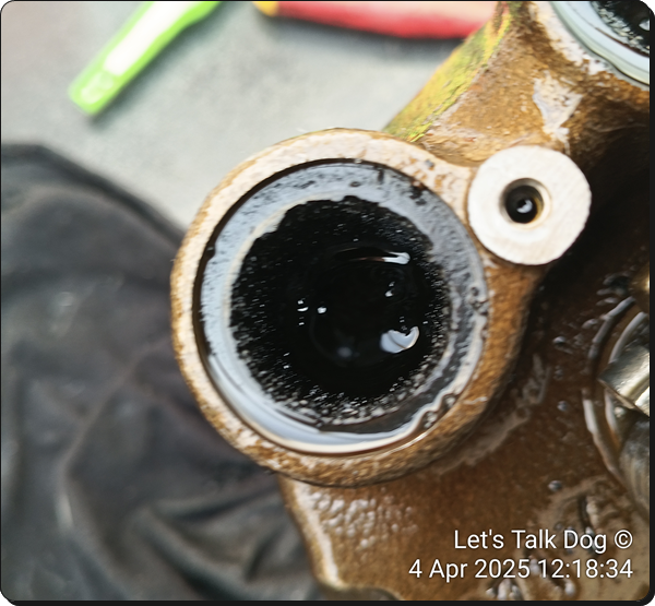

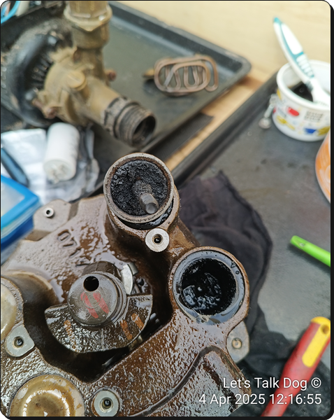

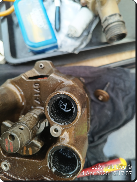

The piston feels good and loose, as does the cam-shaft, once the carbon film was broken to the face of the piston, the cylinder face appears unscathed, the domes are not valves, just domes. They don't open and close. They were very tight undoing, concerned the bolt would shear, but came out.

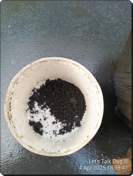

But boy, that's where the carbon had a party, all soaking in degrease to soften them up. All other flat faces have scraped up quite cleanly.
Had to go find my Minicraft drills, some decoking required.
View attachment 490915 View attachment 490916 View attachment 490917
View attachment 490919 View attachment 490920 View attachment 490921
, we have a blockage.
