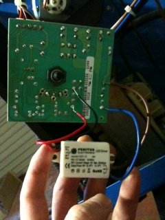

Ok so
1. I tested the main switch. Its a 4 wire one. when i switch it on, it allows continuity between the output wires. When off, it doesnt.
2. I then tested the resistance from 1-2 with the power off. There is no continuity at all there.
3. I next tested 3-4 with the power off and get about 22.5 ohms resistance.
I put the power on and i got 240+v (uk here) across 1 and 2, but nothing between 3 and 4.
So - would this mean that the switch works, and the transformer is getting power, but the transformer is not working (i.e. no output across 3-4) ?
If so - are there any "extra tests" i could do just to be sure?
