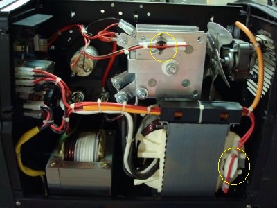

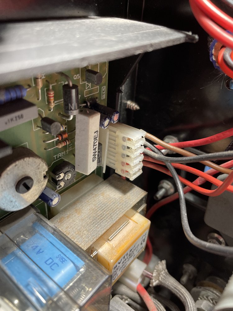

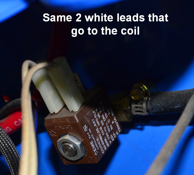

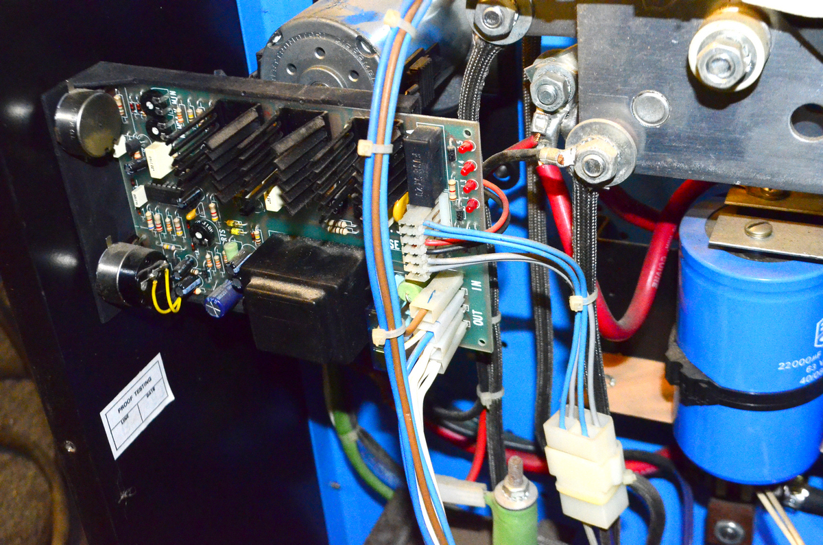

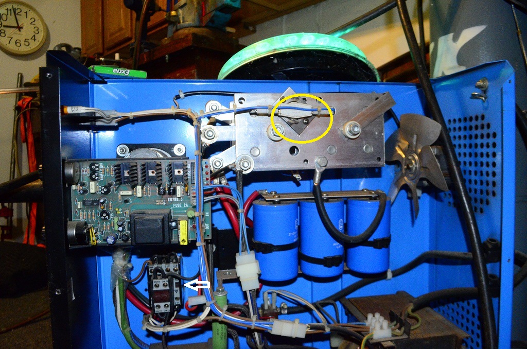

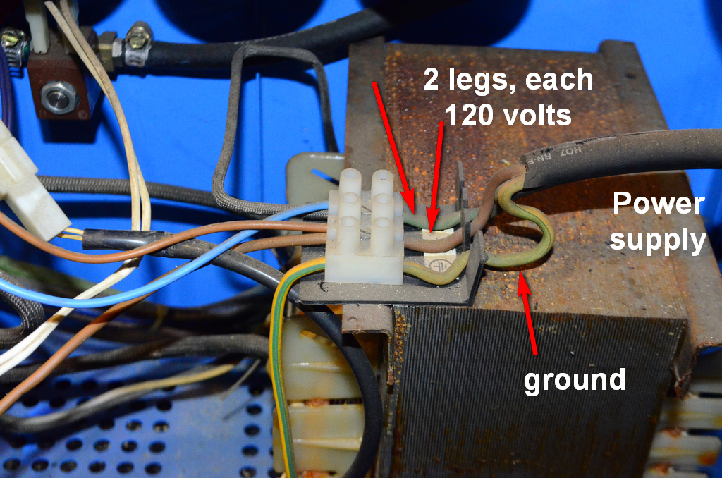

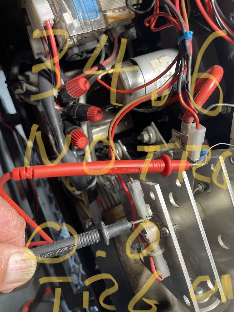

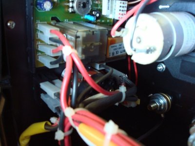

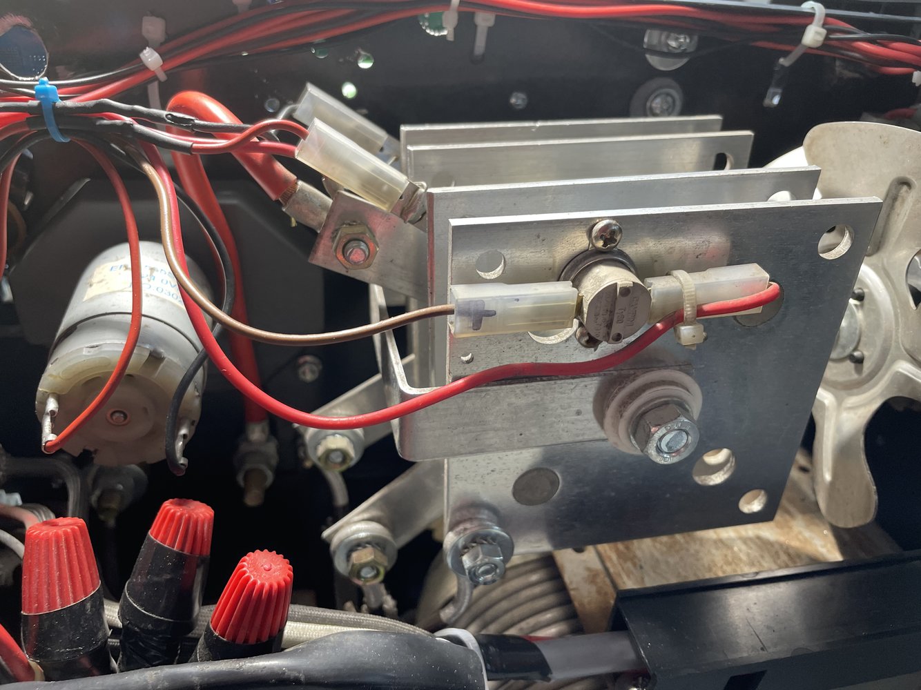

Hello, I have a Clarke 180EN. I changed the torch to the Euro torch plug in type. So it requires a gas solenoid to be added. I installed a 24vdc one to match the wire feed motor voltage. I also added a timer/relay so I could delay gas shut off a tiny bit. I added a 220v/24v transformer to power the solenoid and timer card. …..So here is why I need photos… when i was trying to find a good point to connect the new trigger i cut and tested to many points. Now i may not have every wire going where it should. So i am hoping for lots of photos of this area of the welder showing all angles so i can figure out my mistake. Thanks for any help wiring diagram would be great.
