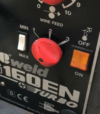

Ok great I thought it powers on when switched on thankshi can anybody help me as to regarding mig welder 160en as to regarding the power switch it is orange and i want to know when switched on should it light up when on only mine don't light up thanks
I It will light up for protection, if you exceed the duty cycle and it gets too hot.
